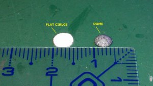

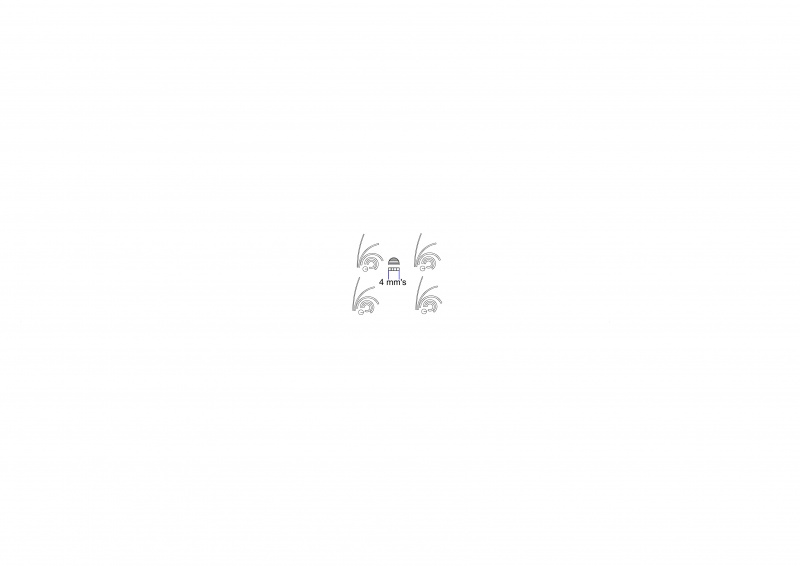

Here is a small unfolded 4 mm dome, if printed on A-4 paper. It's small, but should give you a nice dome, or a mold to put some two part epoxy into. They are incredibly small, good luck!! :)

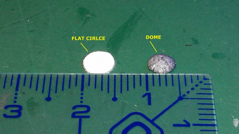

Another thing that you cando, is cut out a circle that is about 5mm in diameter, then take a roundeddowel (like the end of a small paint brush), and form the circle into the domethat you need by GENTLY pressing it (in a circular motion) in a thin foam pad(like a mouse-pad) to form the dome.
Either way you go, I wish you the best of luck with it.
Thanks for the help guys. I love this site for this.
Yep, that technique works very well. I used it to make the bumpers (or whatever they are called) on my E92 Elekrtolokomotief model.
If you dampen the paper slightly, this helps to stretch it. But, GENTLY does it...:mrgreen:

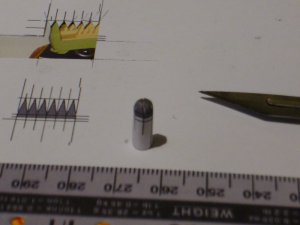

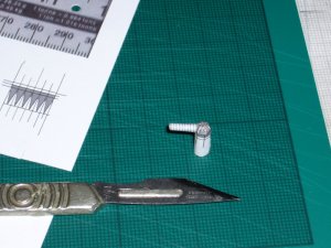

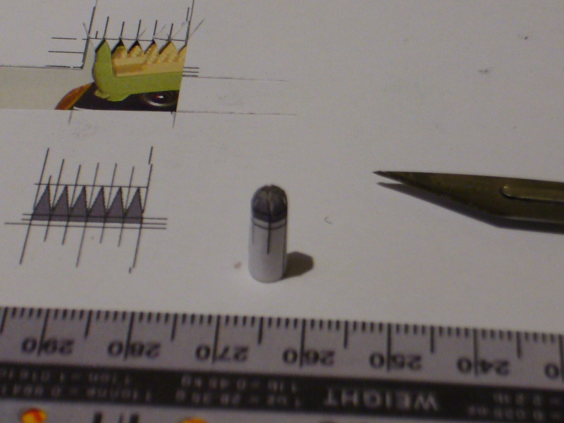

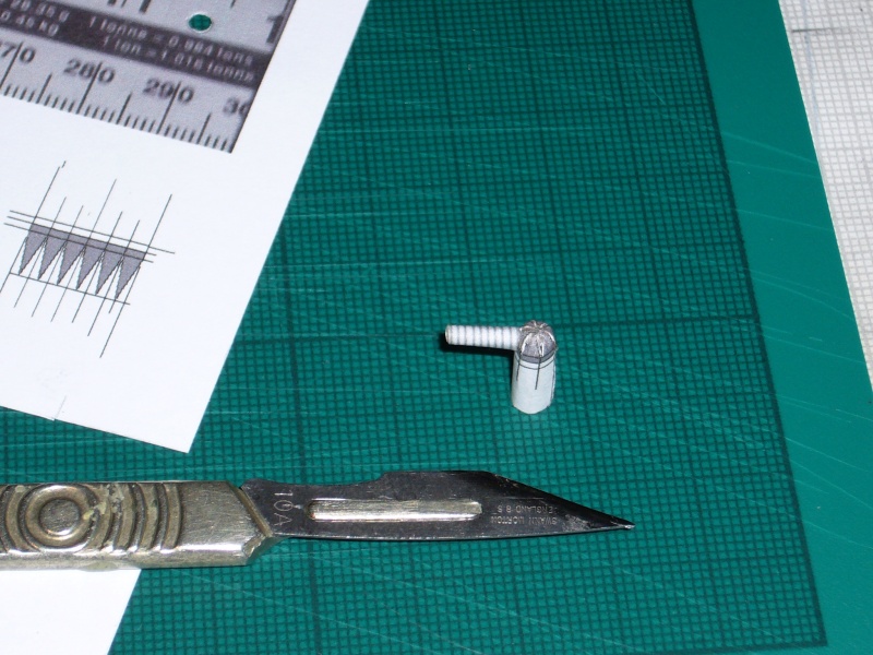

Hi John, thanks for the domes, but I couldn't cut them out accurately never mind doing any justice to making them, so went back to petal folding. I did use the cut out circle and domed slightly (thanks guys) underneath the petals to glue them in place. Still needs a bit of work, but in theory seems to do the trick.

This model is the Apple of many people's eyes! :)
I am glad to see that you are back and working on this project again.
I am very curious as to how this project will turn out.
KEEP UP THE GREAT WORK!!!

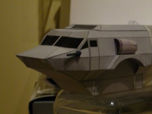

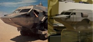

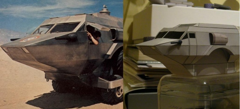

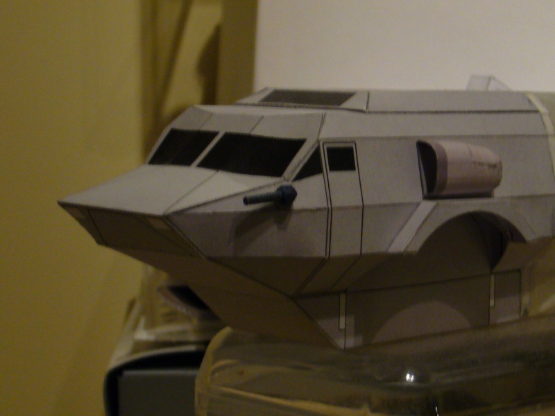

Curved the 'petals', recoloured and made the barrel tighter.
Just about there.

Wow it looks great :thumb: I can not wait to see you finished this one.
I always loved the look of the landmaster the movie was ah ok. The book is great one of Roger Zelazny better books.
Thanks for sharing your progress.
The film was dreadful. Doubt if they even read the story. The landmaster was the star. And yes it was a good book which would have made a great film. I always thought that Kurt Russell based Snake plisken on Hell Tanner.( the anti hero of the book)
Amazing work!
