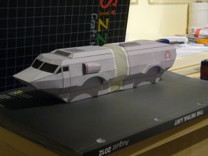

Been thinking about this bit for a while and decided the best way is to create a flange to attach whatever the joining material will be (more fiddley bits, sorry folks :p) It is set one paper width in, the plan is then to wrap a 4mm strip to sandwich it (and cover any bad joins)
Material wise, latex doesn't seem to have enough give, so thinking about hosiery as a solution (I'm avoiding any jokes here :twisted:) It seems to have the right give and apparently there are different grades called denier. May be sending the wife shopping. Coming home with latex gloves and some tights may have taken some explaining.

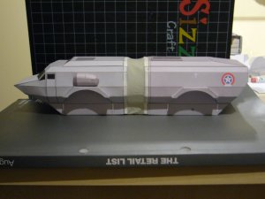

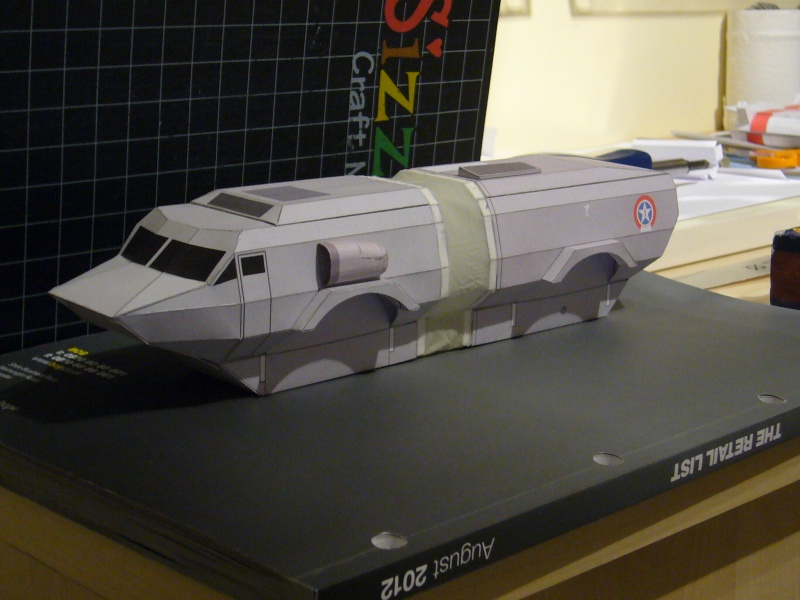

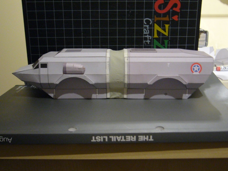

Evening all. Taken a while to get further with the project. Had to rework all the parts of the hinge mechanism as all slightly out. Also joined the 2 parts together (this is still work in progress but it appears to be a sound theory) Gone back to the latex glove idea (or latex free glove. is everyone allergic to latex :confused:) Need to stretch it tighter and didn't realise how see through it was. I might try to mask the area off and flash a bit of silver paint over it. The good news is the engineering worked. Used CA super glue with 45 sec curing time. Give the ability to position correctly, but 45 seconds seems like ages. Do each piece and let fully cure before moving onto the next one. Inevitably stuck Landmaster to fingers a few times :mrgreen:
Another thought also occurs. It is definitely worth doing this before adding any external pieces as you have to man handle it a fair amount. Also if you make a complete pigs ear of it, you haven't wasted all those fiddley bits.

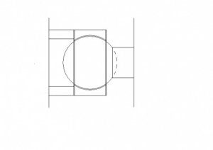

This joint you made was very ingenious. I can't stop admiring the details of it. I wanted to ask your opinion in regards to a crazy idea that I thought I could implement when I eventually build such wonderful model.
I thought I could use a ping-pong ball to make up a kind of spheric coupling between the front and back sections so that the rear body could have 3-axis of free movement. I'd have it encased in some paper cage structure to hold it and also to limit the range of movement.
Do you believe this could work in my case or do you have some other suggestion that I should try ?
Appreciate any feedback :)
In theory should work.
Ball attached to a tube on one side, The a ring on the tube side joined to a ring on the other with at least 3 arms joining them together would work. Then join the ring to the other cab. I would get a prototype done first :thumb:

Wow. You've got it exactly the way I thought. The only other thing I would add are some "arms" attached at the same side of the ball tube sctructure so as to act like bumpers and limit the movement of the cubic cage to just a few degrees of motion.
Edit: Only now I've figured out what you're meaning by an "A" ring. It should work even better that what I planned as a Cube (square) ring cage. Errrr... sorry for the mis-used words (cube, square, rings LOL), I know that an image speaks better than words.
Thanks for the drawing. Much appreciated ! :thumb:
