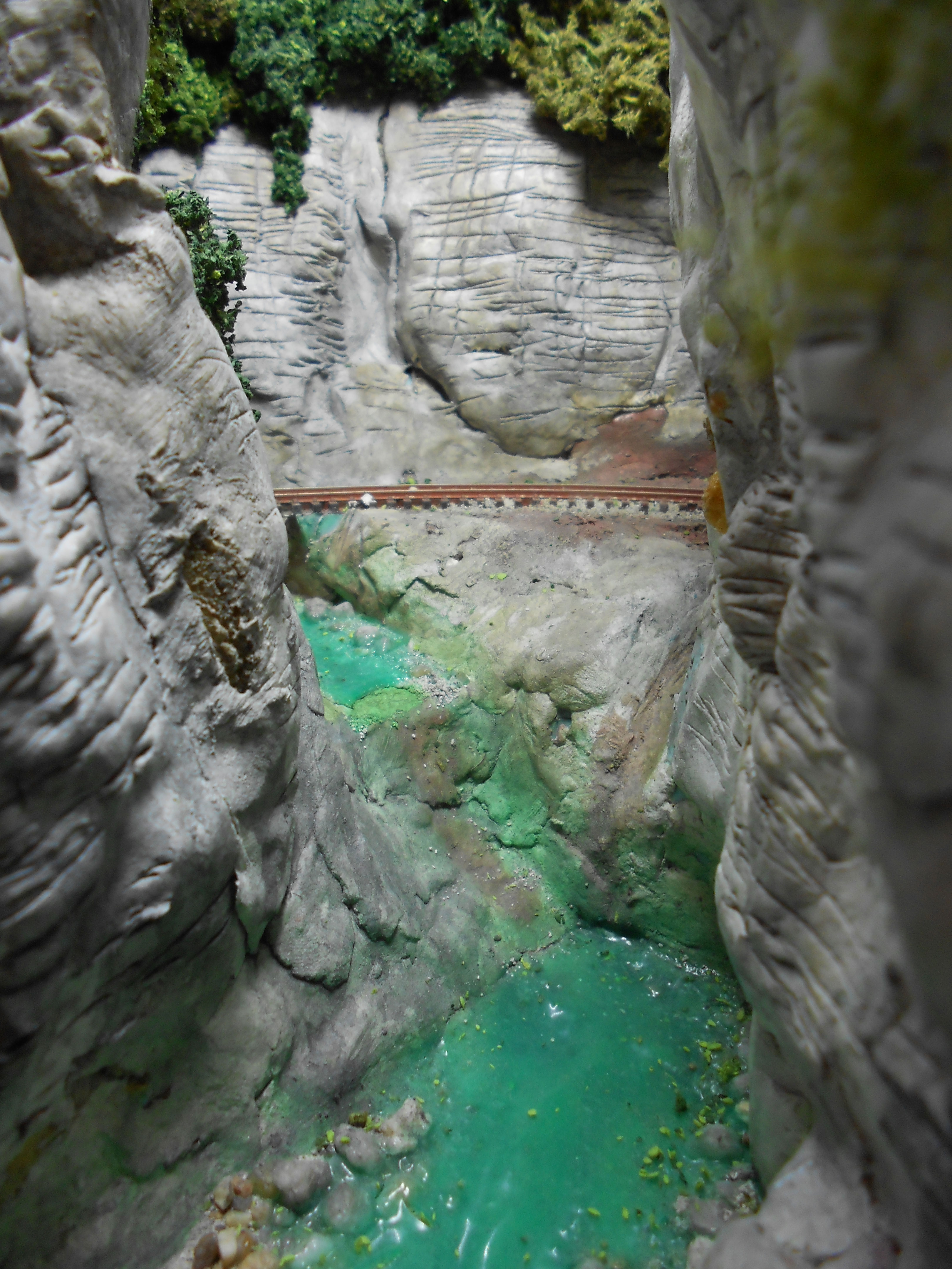

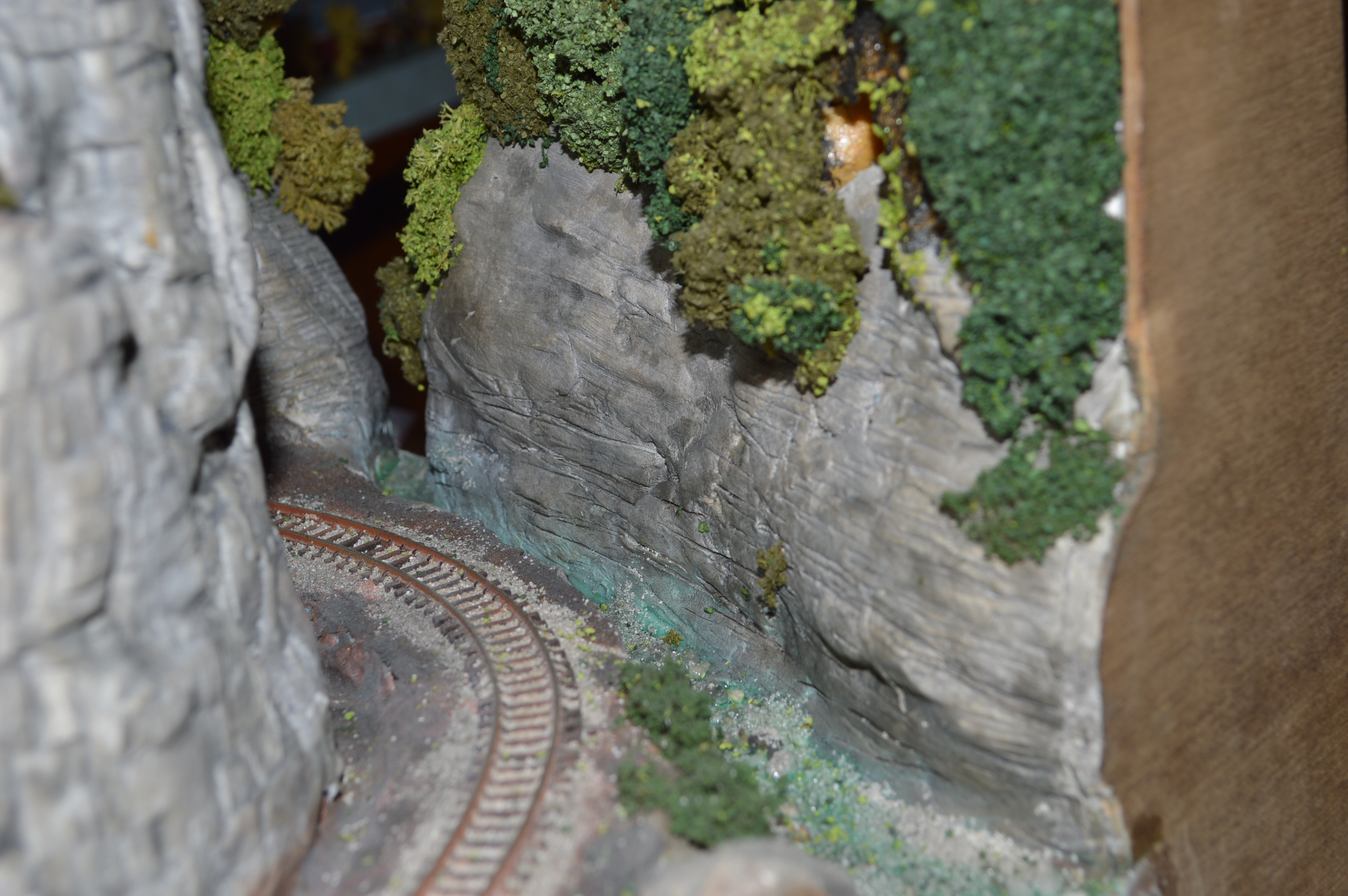

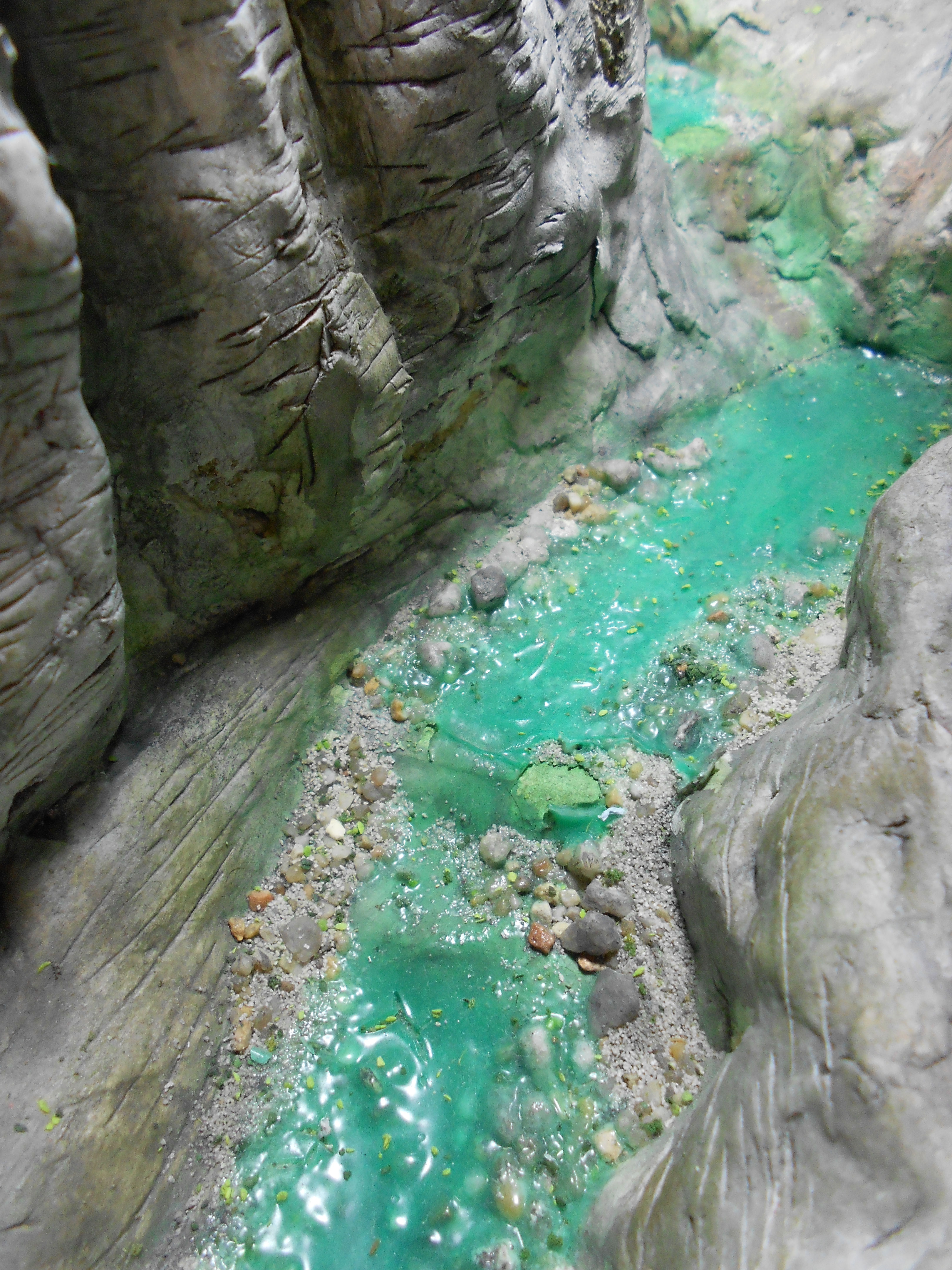

I restarted by laying the "water". I used an acrylic product from Faller. Add some drops of Vallejo transparent emerald colour. Don't know why, but in most photos of rivers in Japan the water has this emerald colour, not the brownish we're used to see in Europe and States.
It cures in 24 or 48 hours.

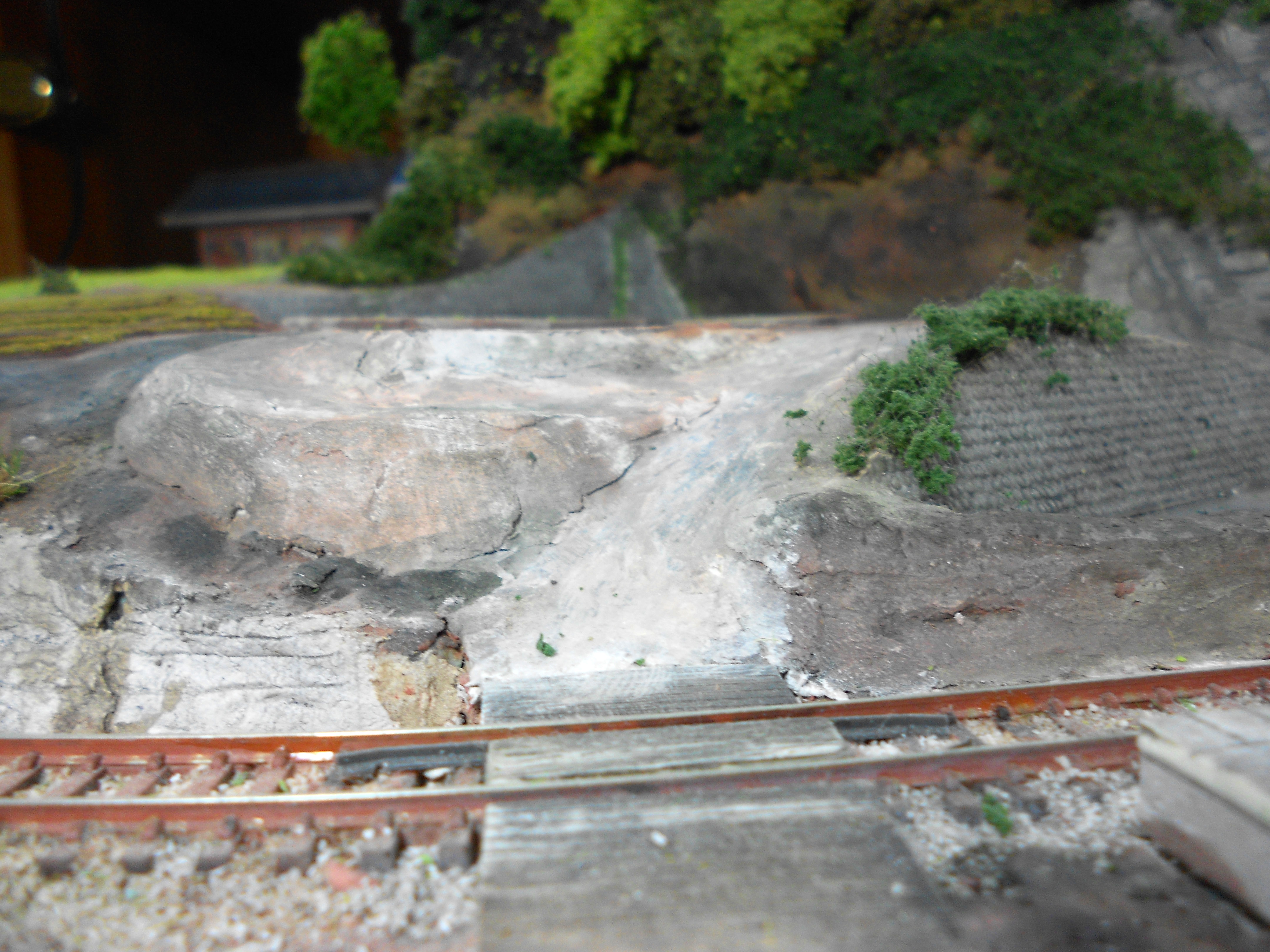

After that I checked the work and noticed that accidentally removed some rocks, leaving white gaps. So I made a map of " things to do".

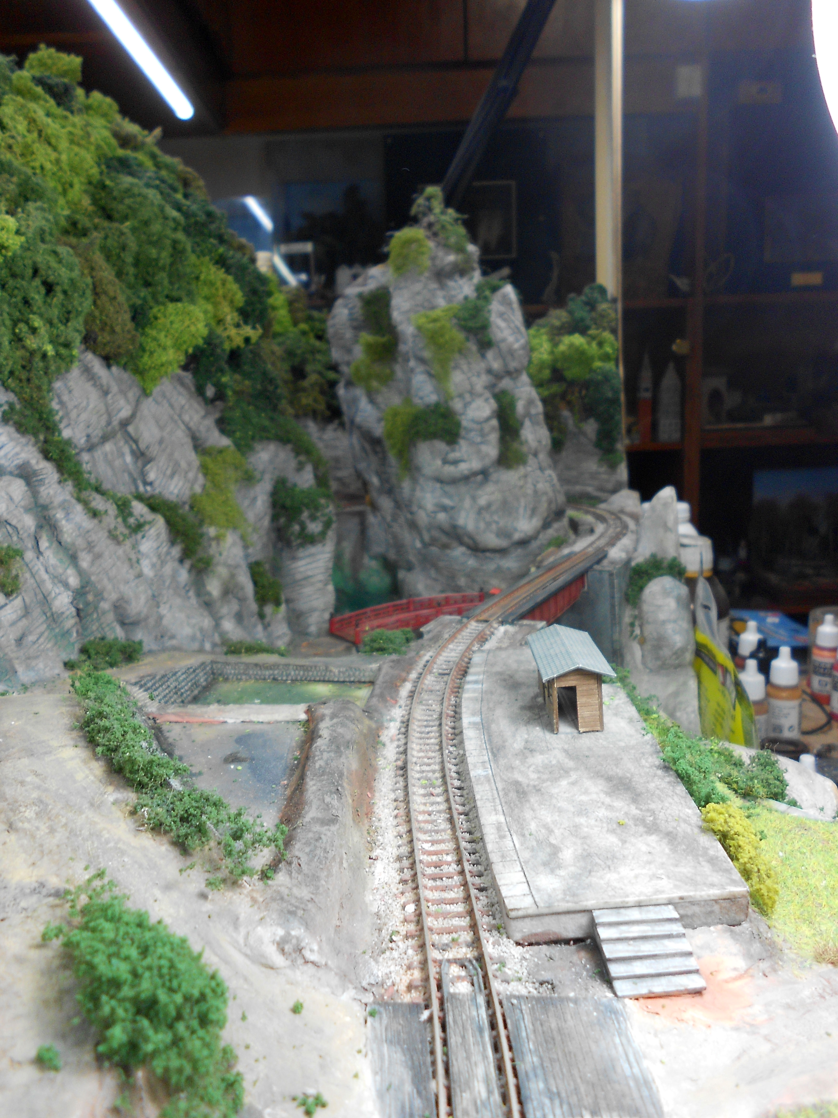

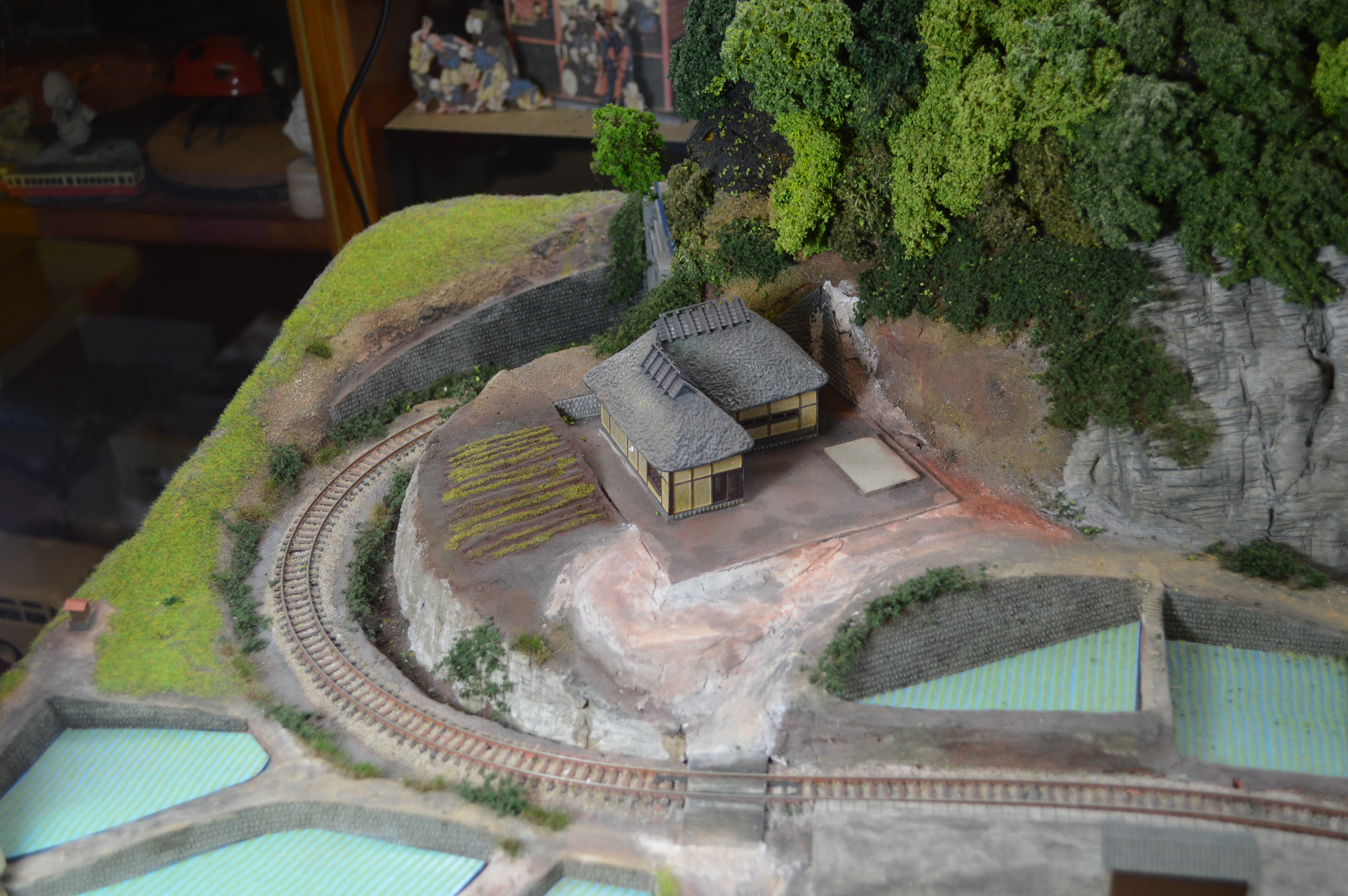

Slowly I found my rhythm and things started to happen in a matter of weeks.
The rice paddies are made with a product from Tomytec. It is quite weird and hardly believable, but sure easies the way. Had to cover the gaps in the corners of the rocks and apply foliage. The rice paddies wer palced just for the photo, they weren't glued yet.

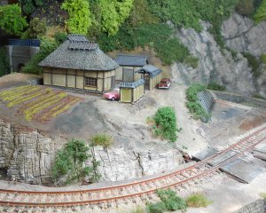

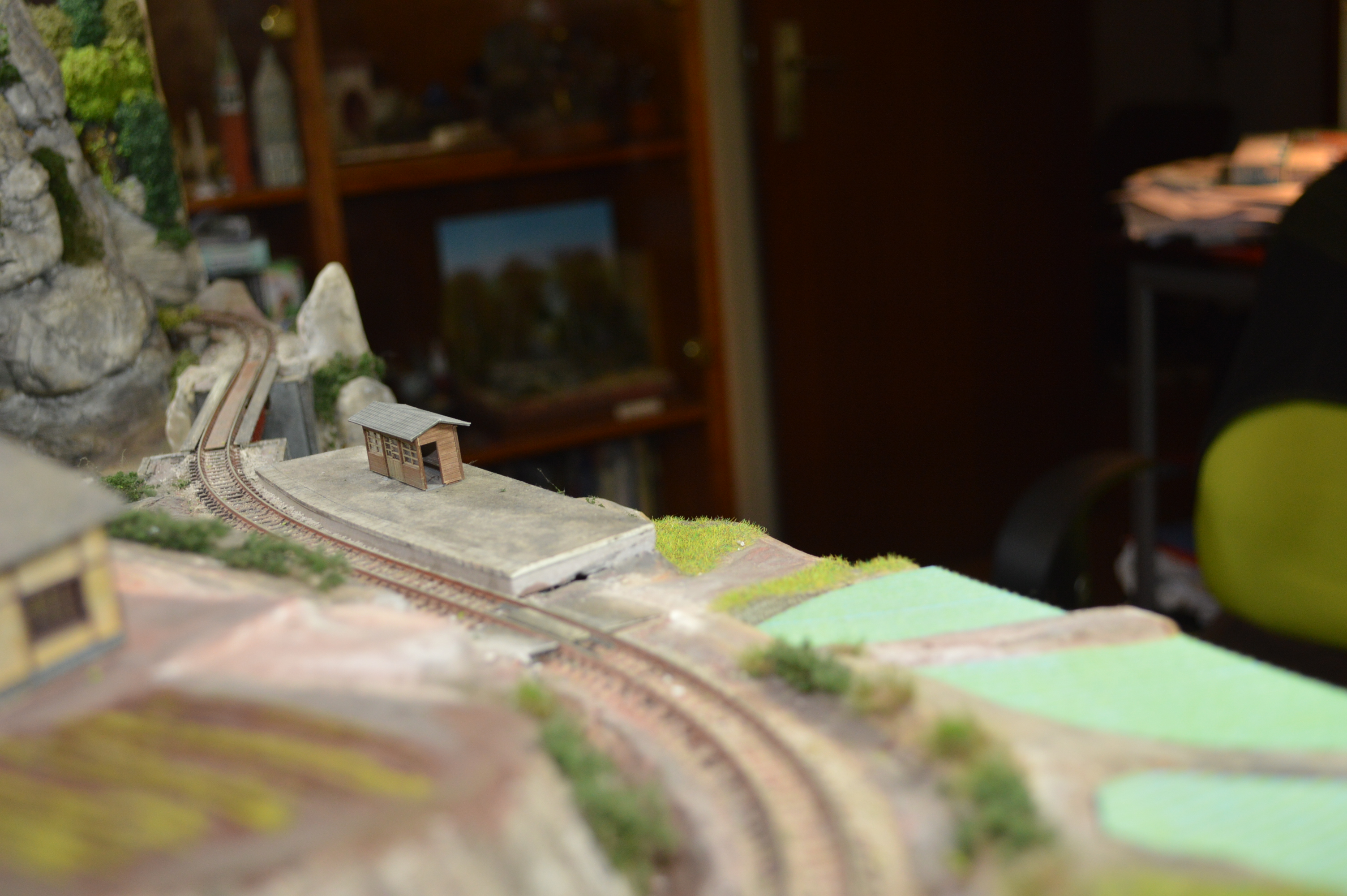

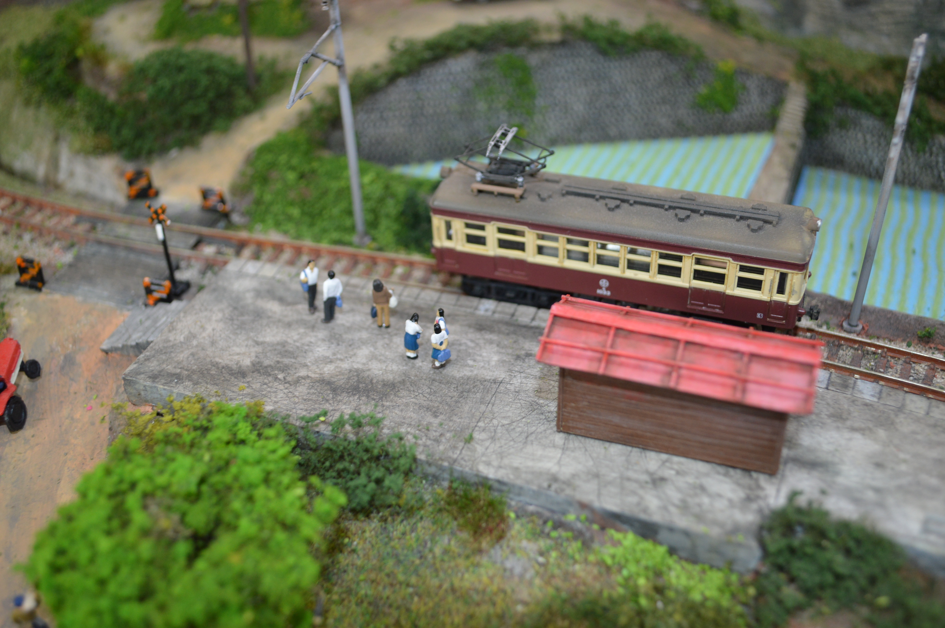

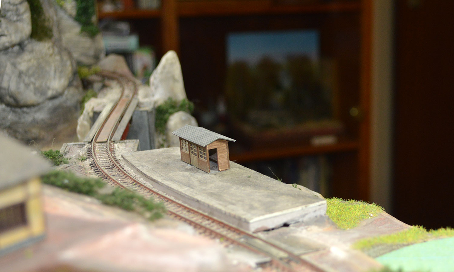

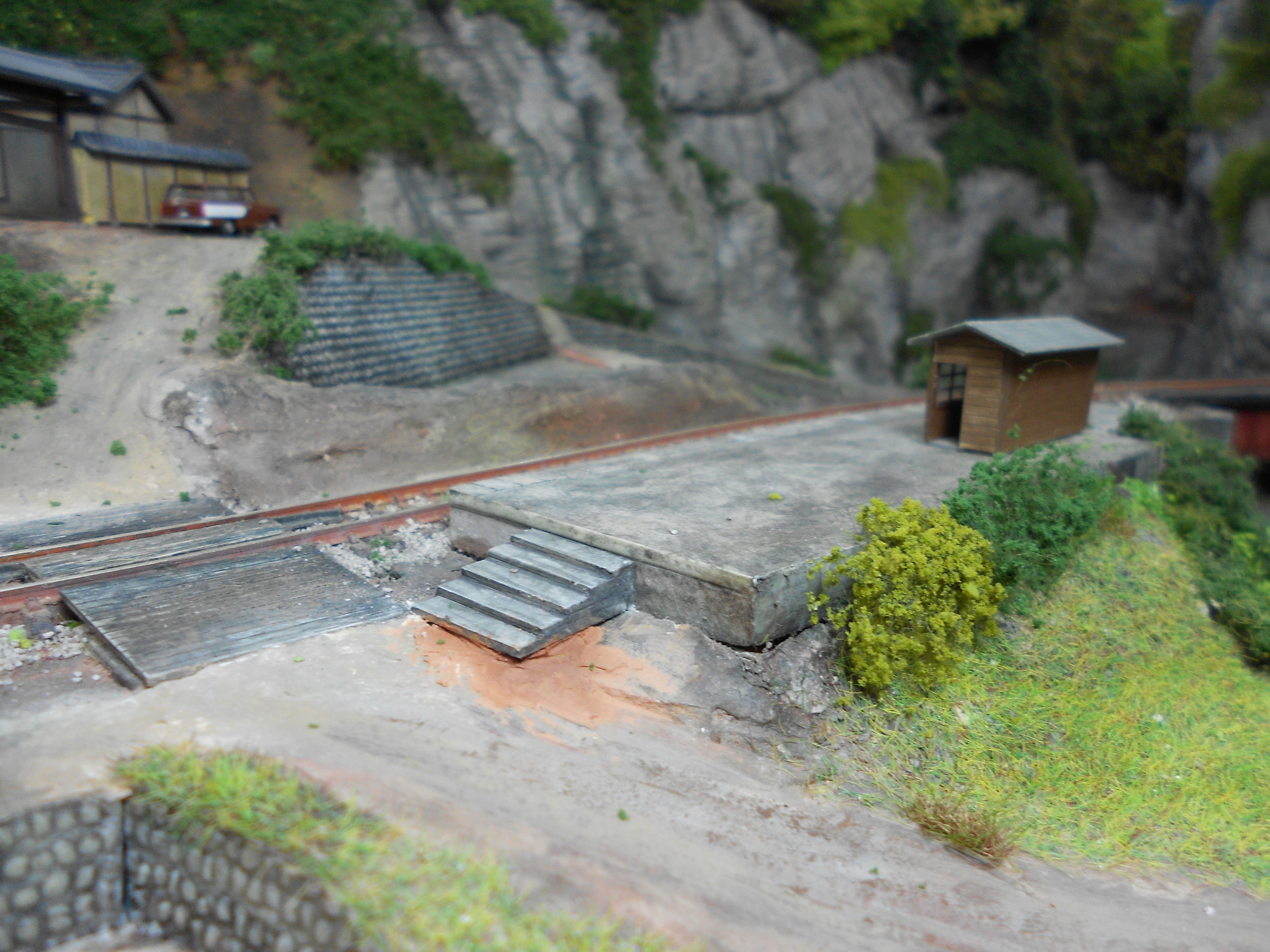

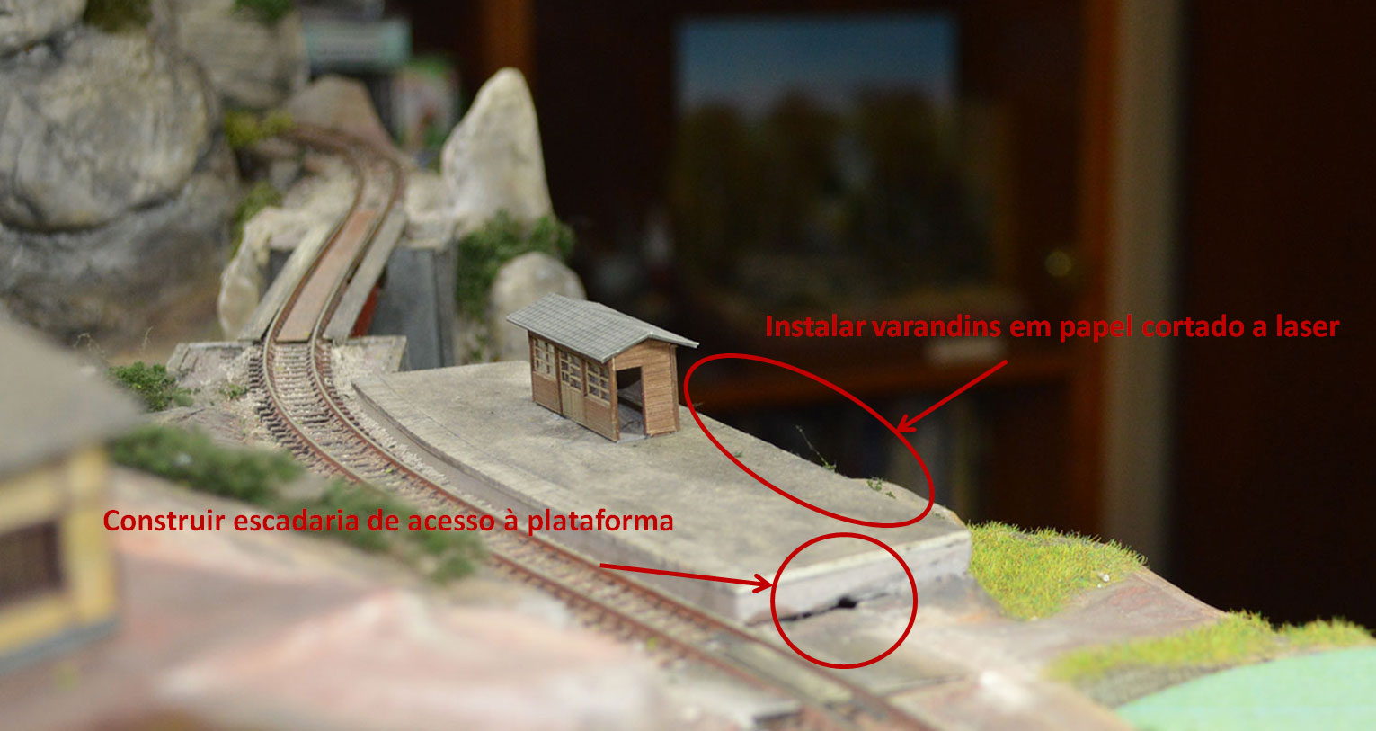

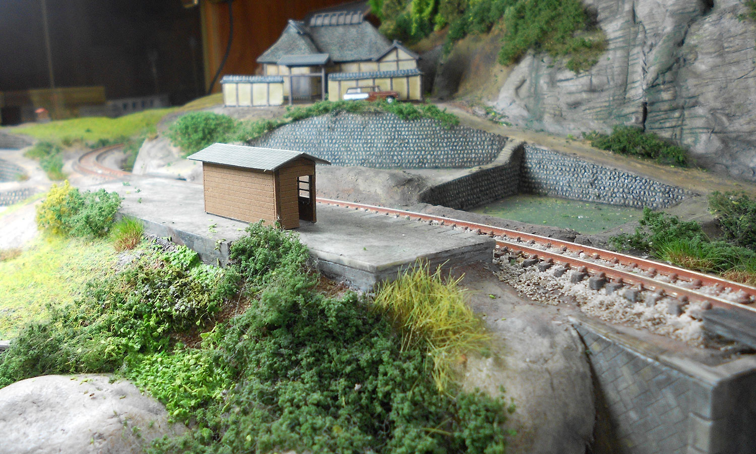

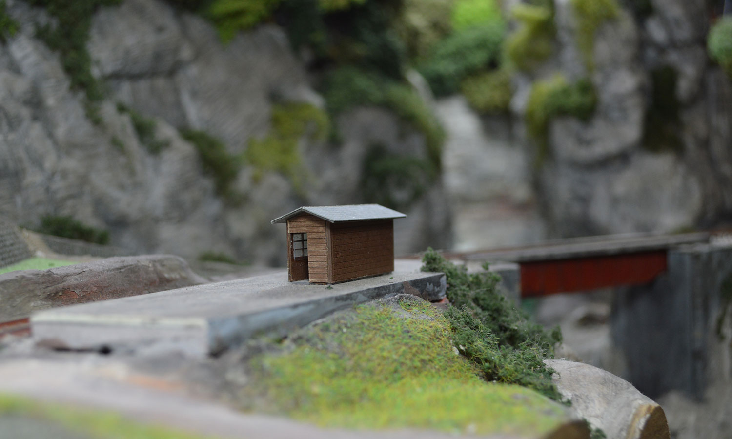

Then turned to the small halt. The tiny building is a laser cut cardboard kit.
Reactions: Rhaven Blaack

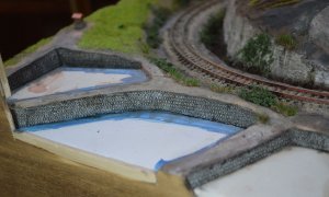

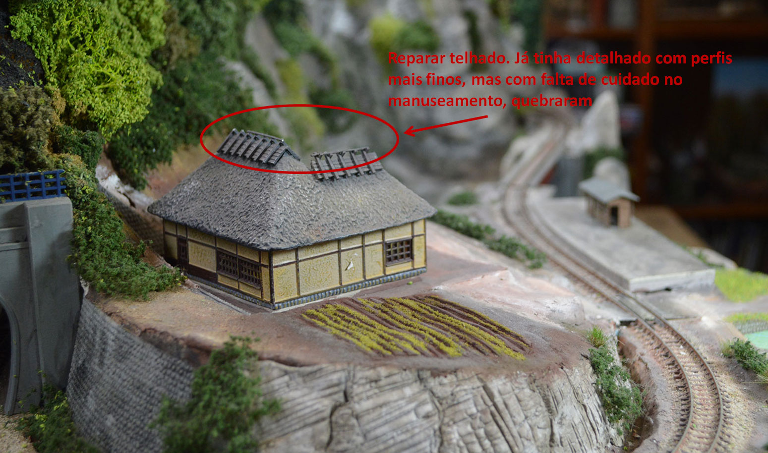

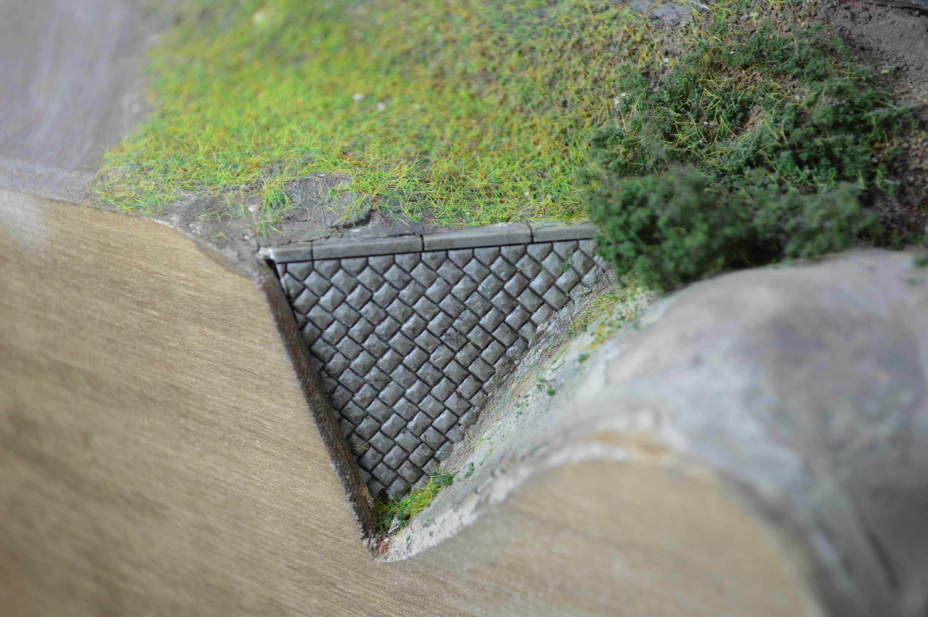

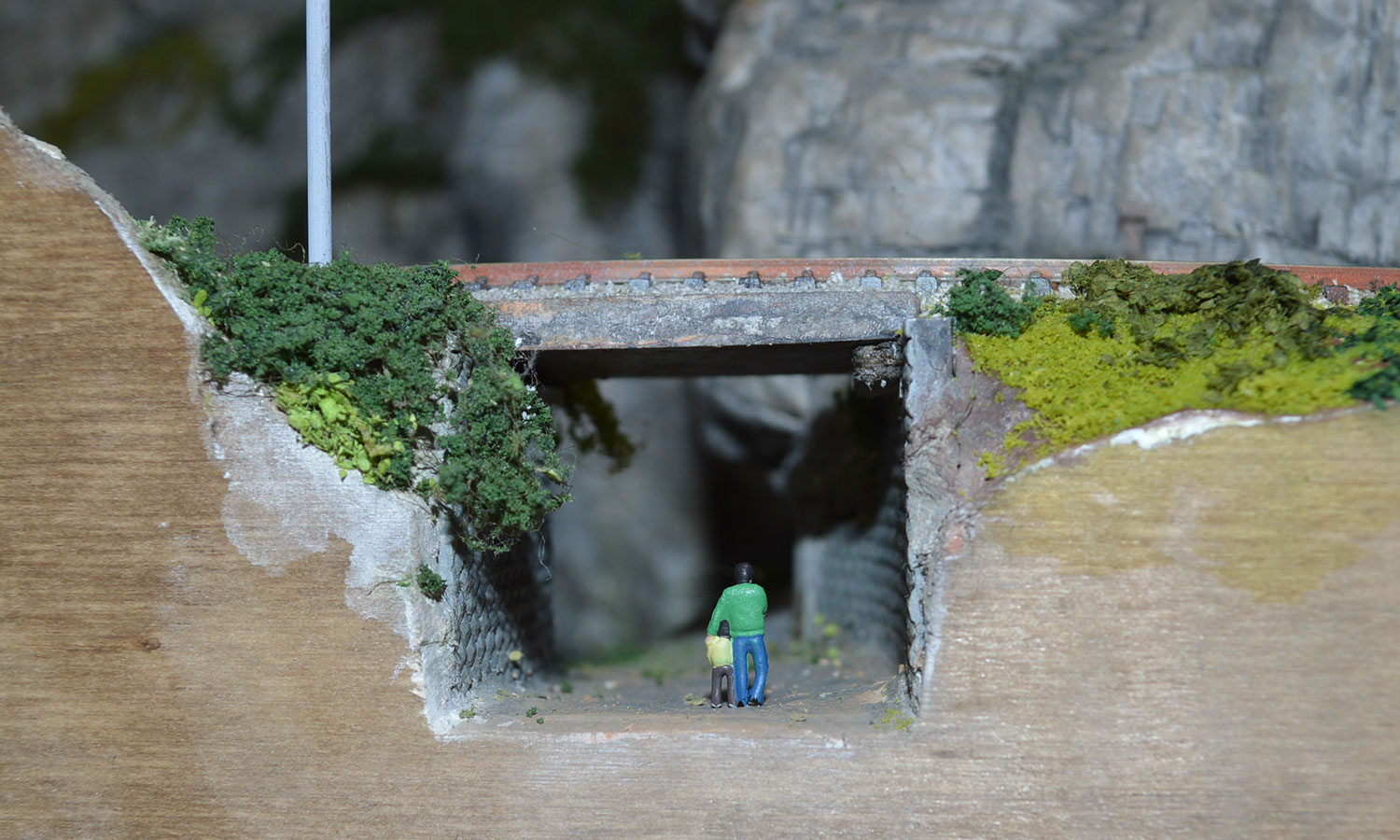

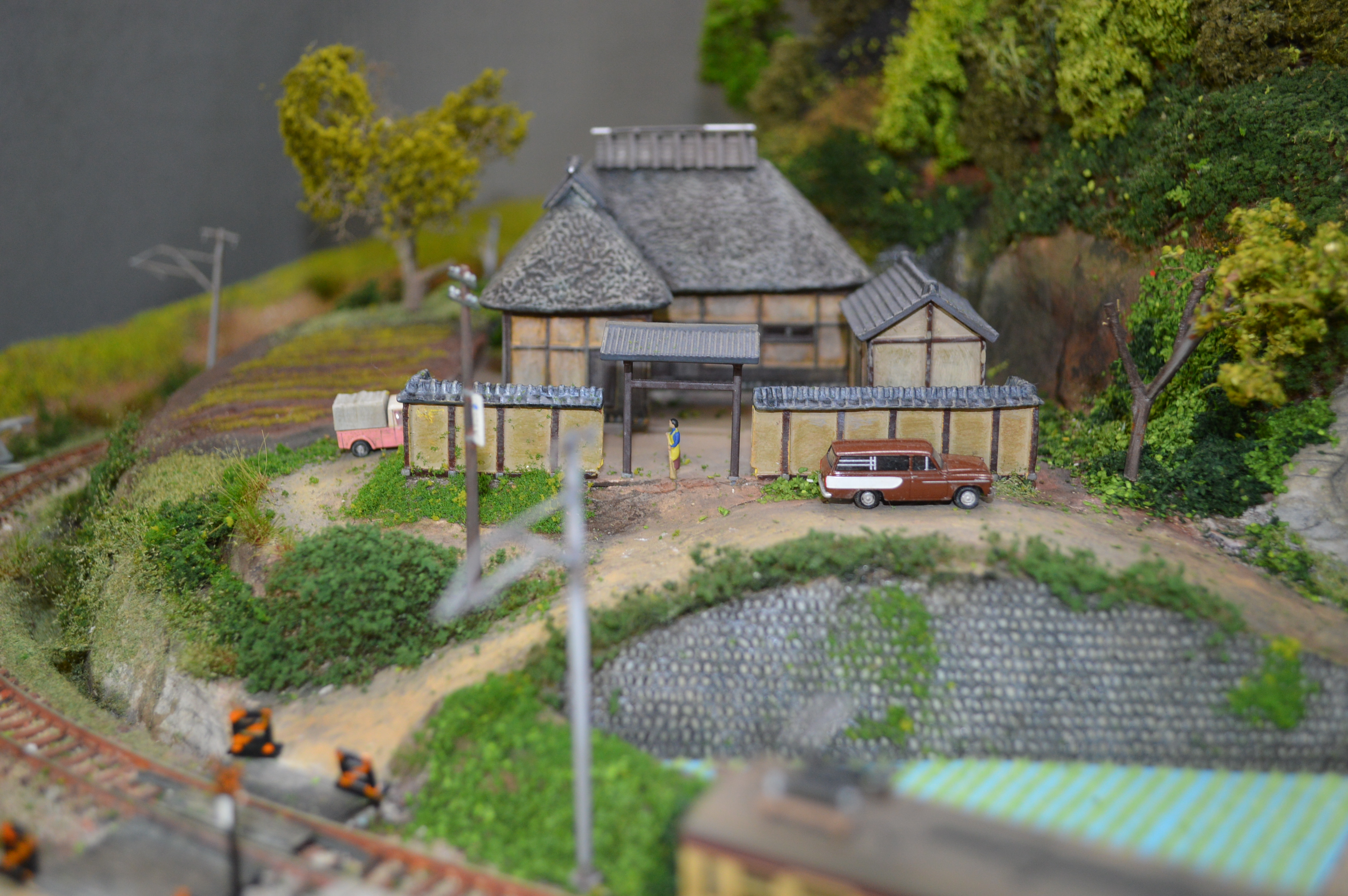

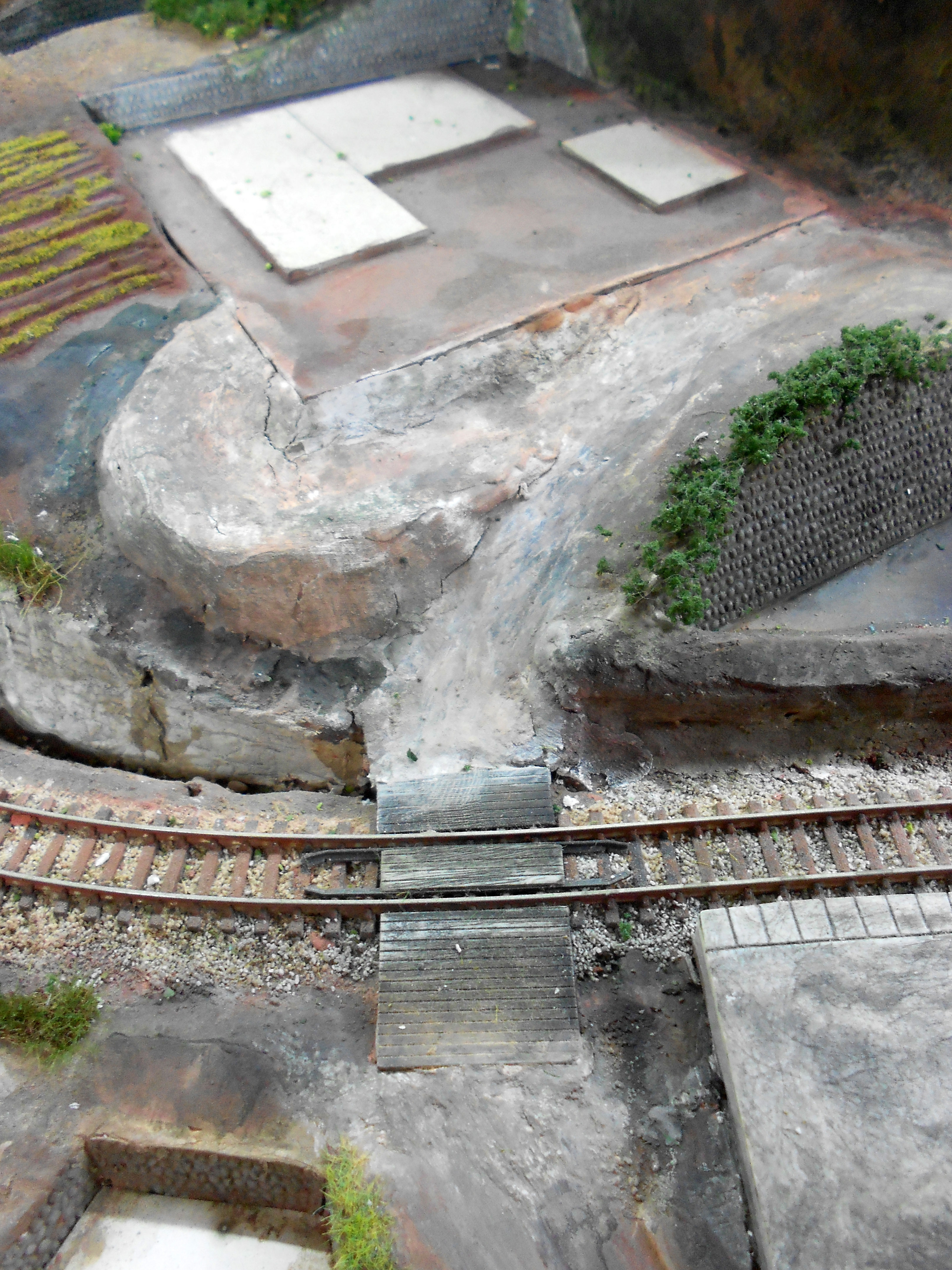

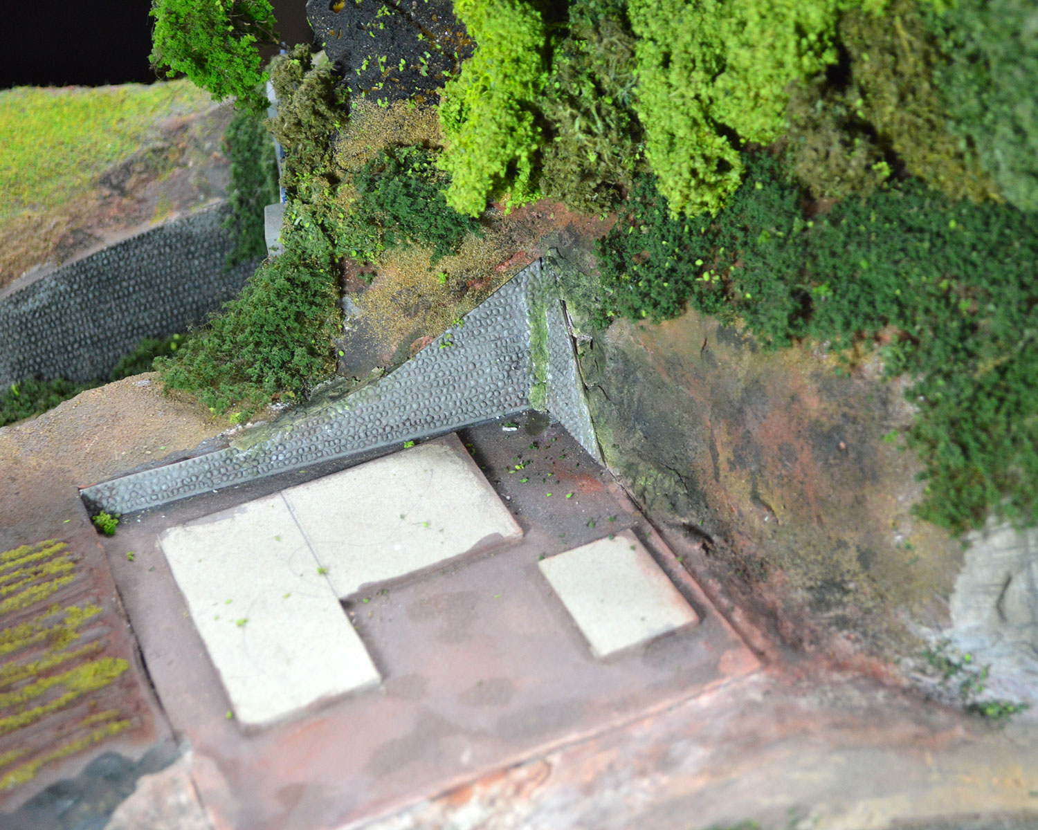

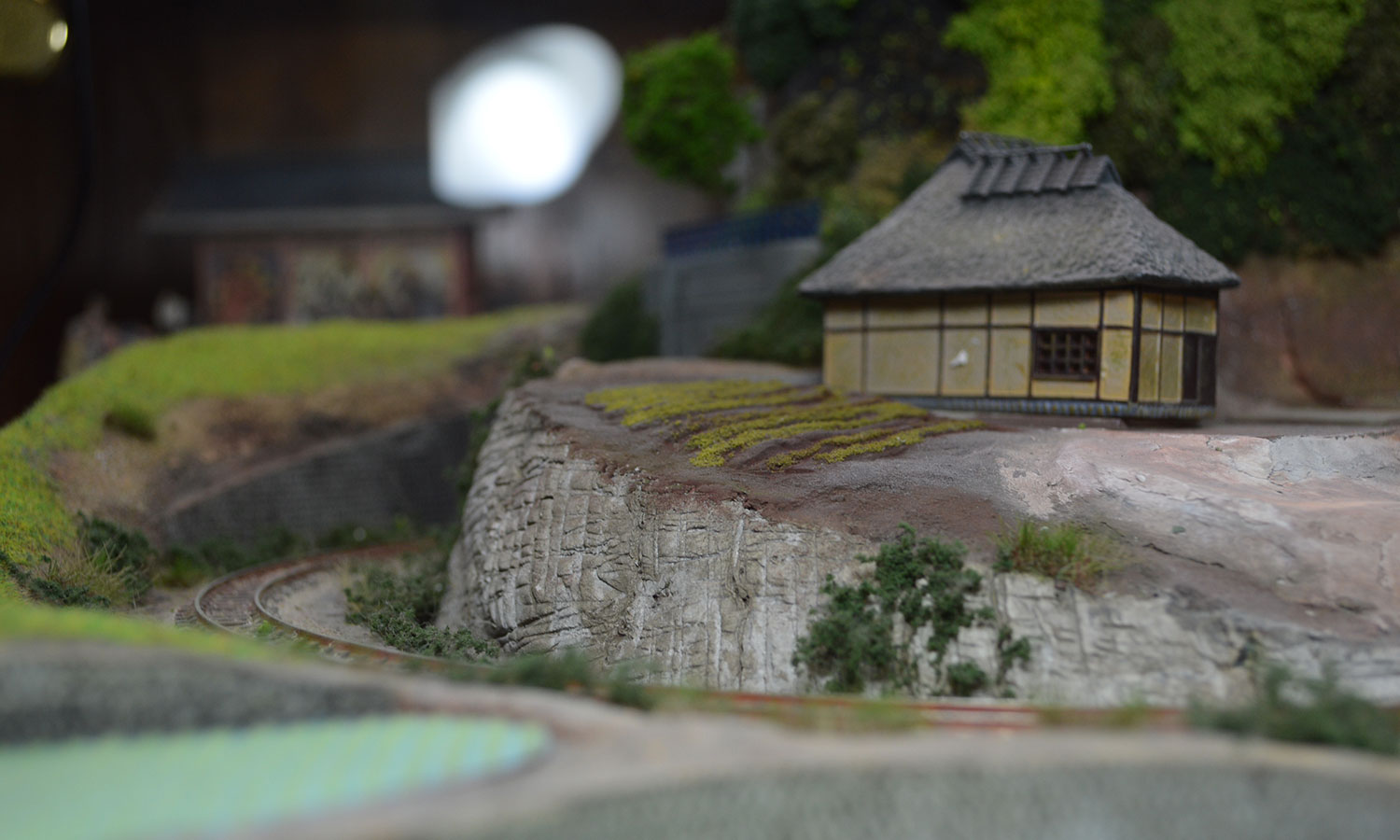

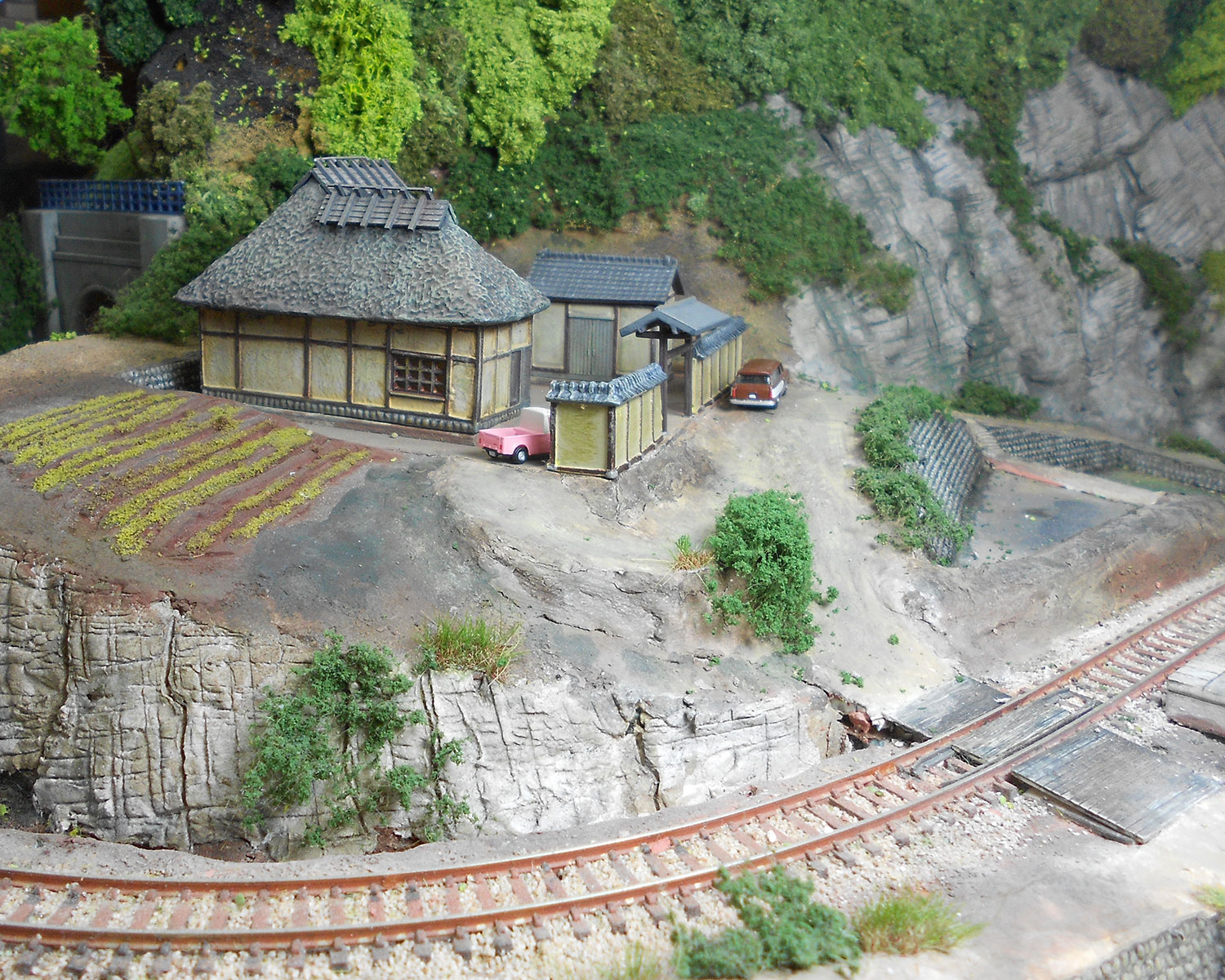

Restored some broken parts I added previously to the thatched roof of the house and started to prepare a more believable setting for the farm house courtyard.

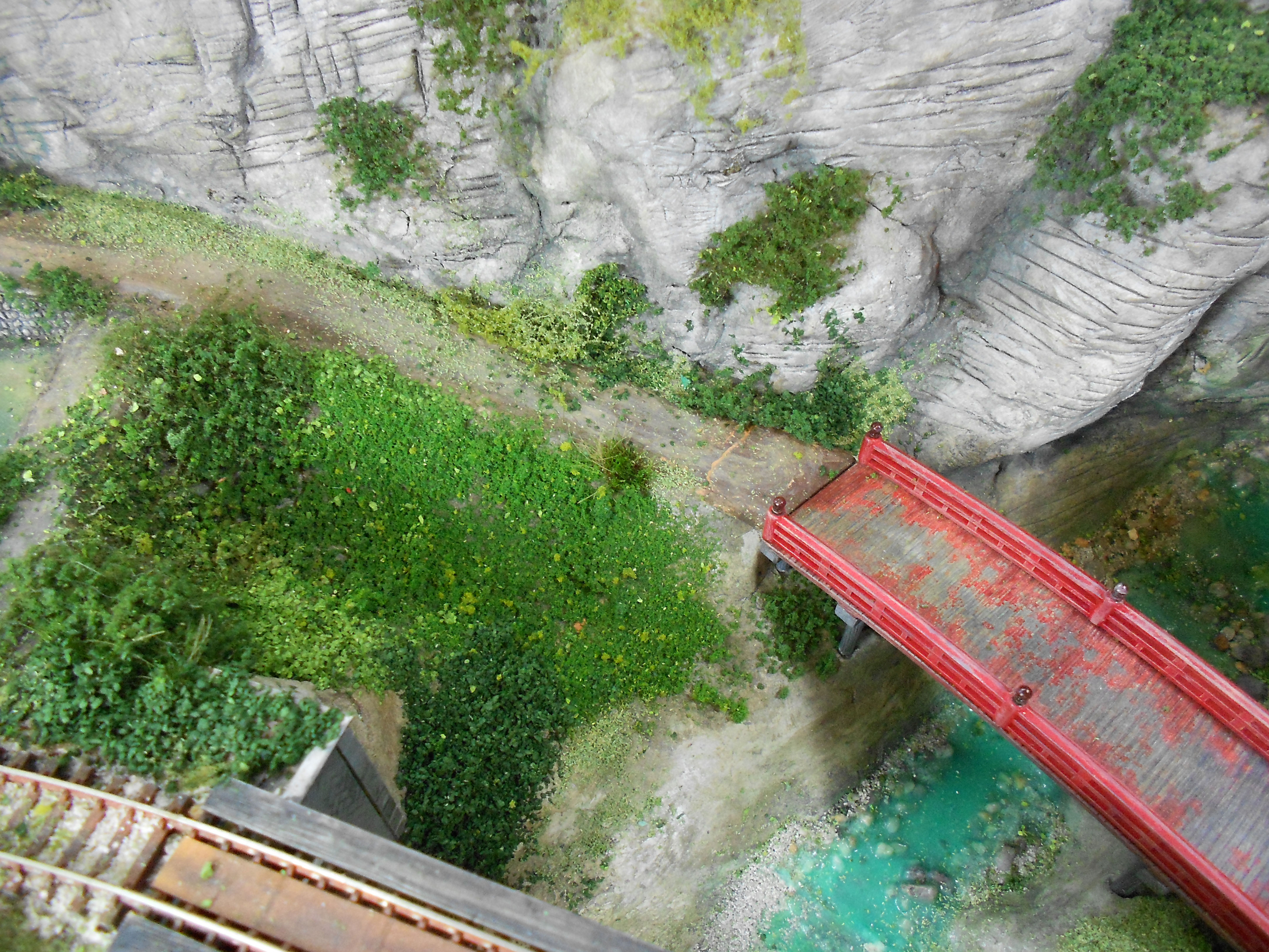

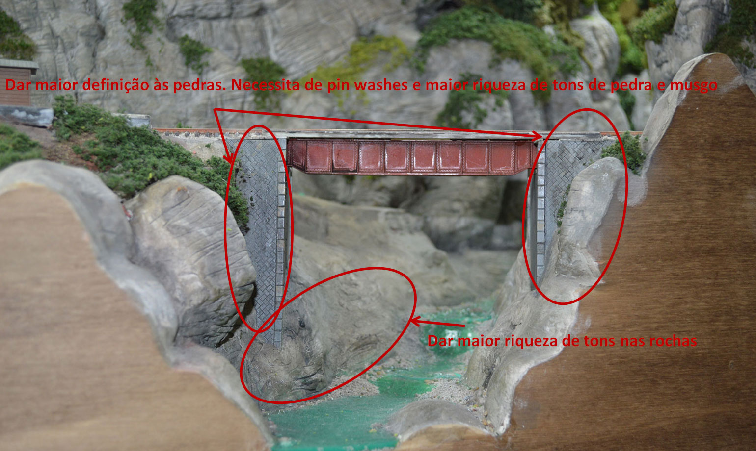

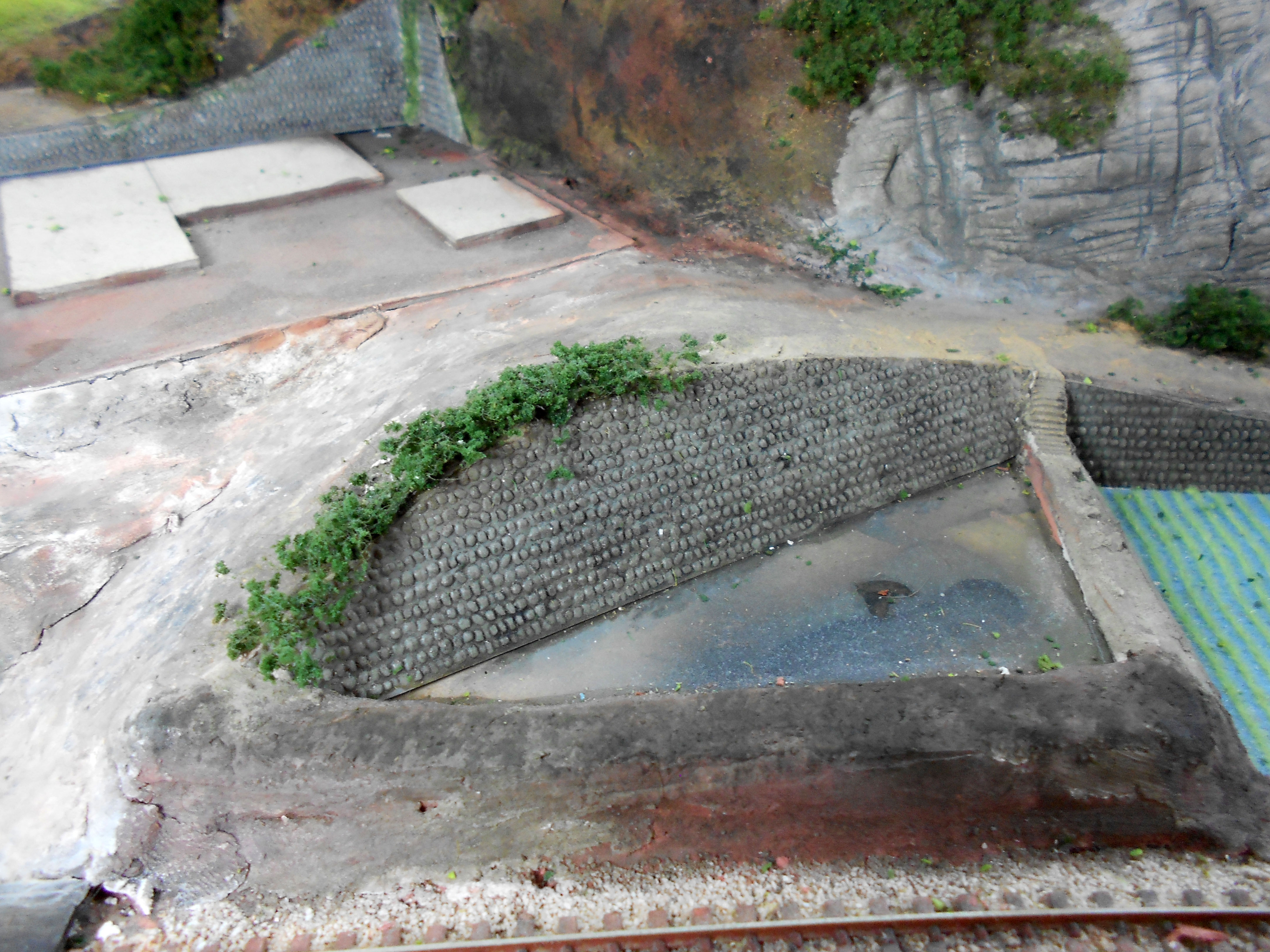

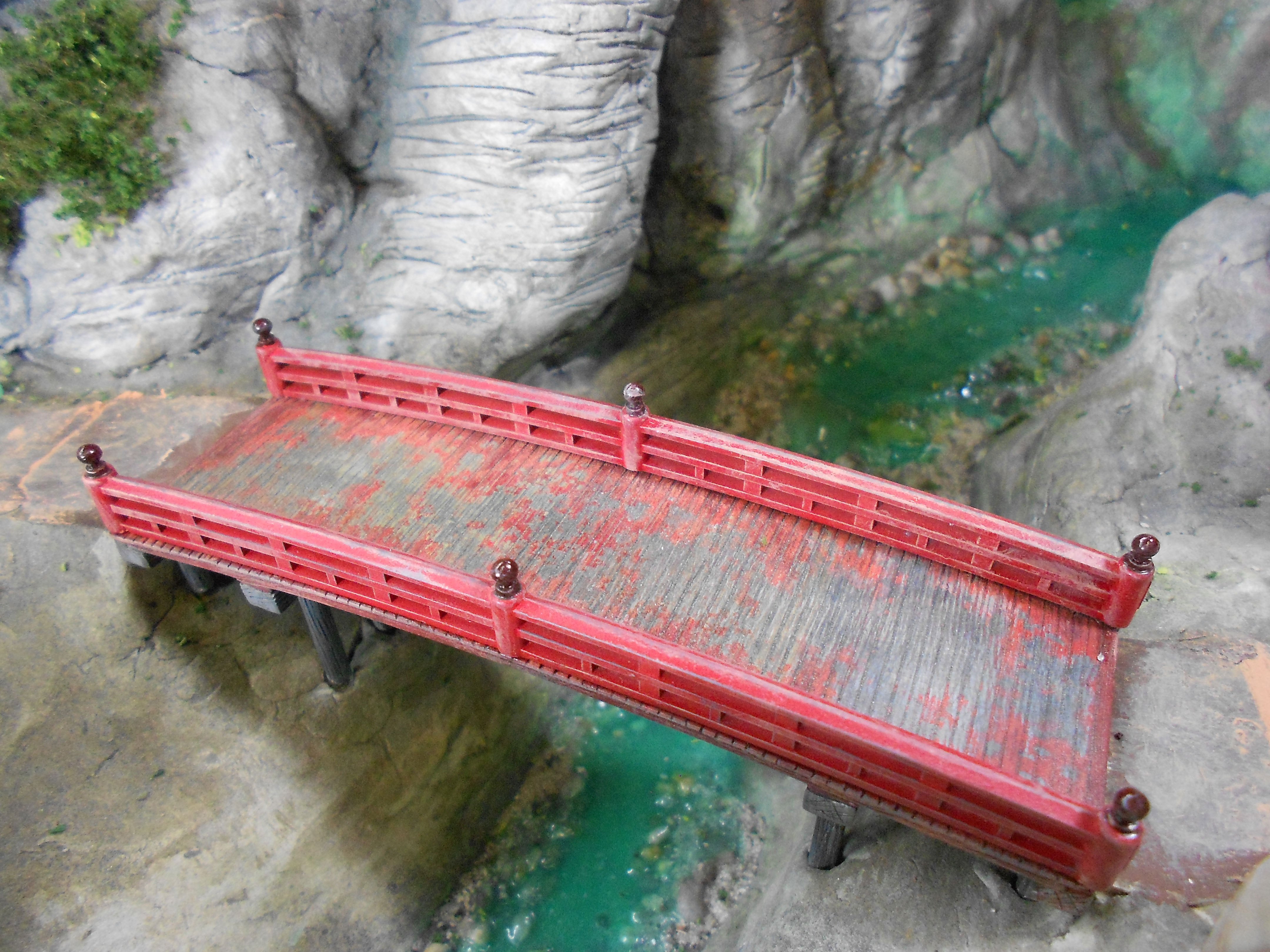

Paid attention to the bridges and river.
After several attempts I'm still not convinced with the painting of the stone work. It is so dull!

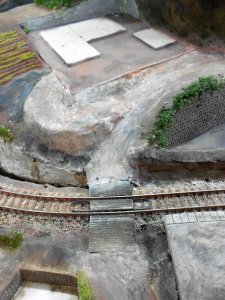

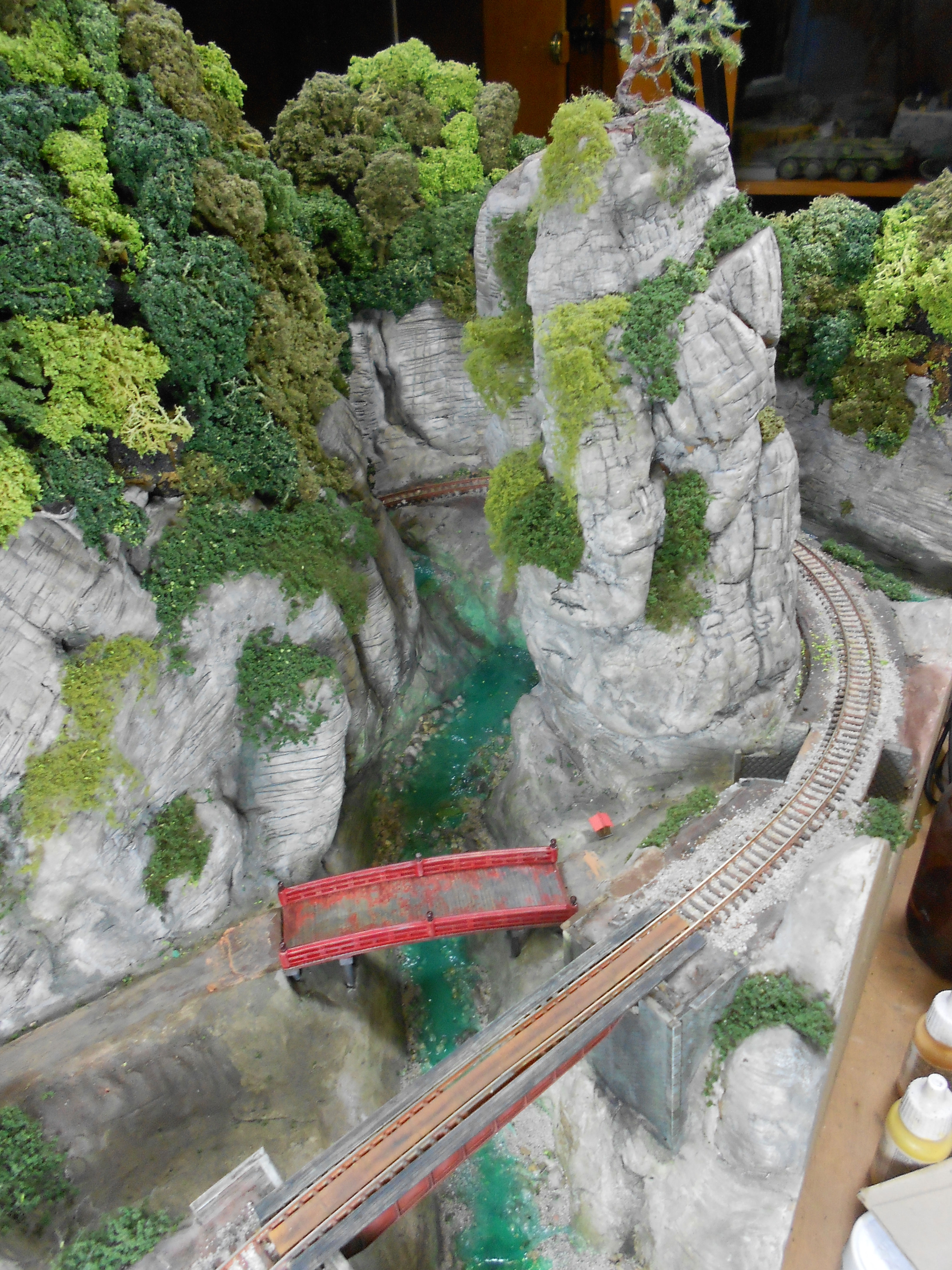

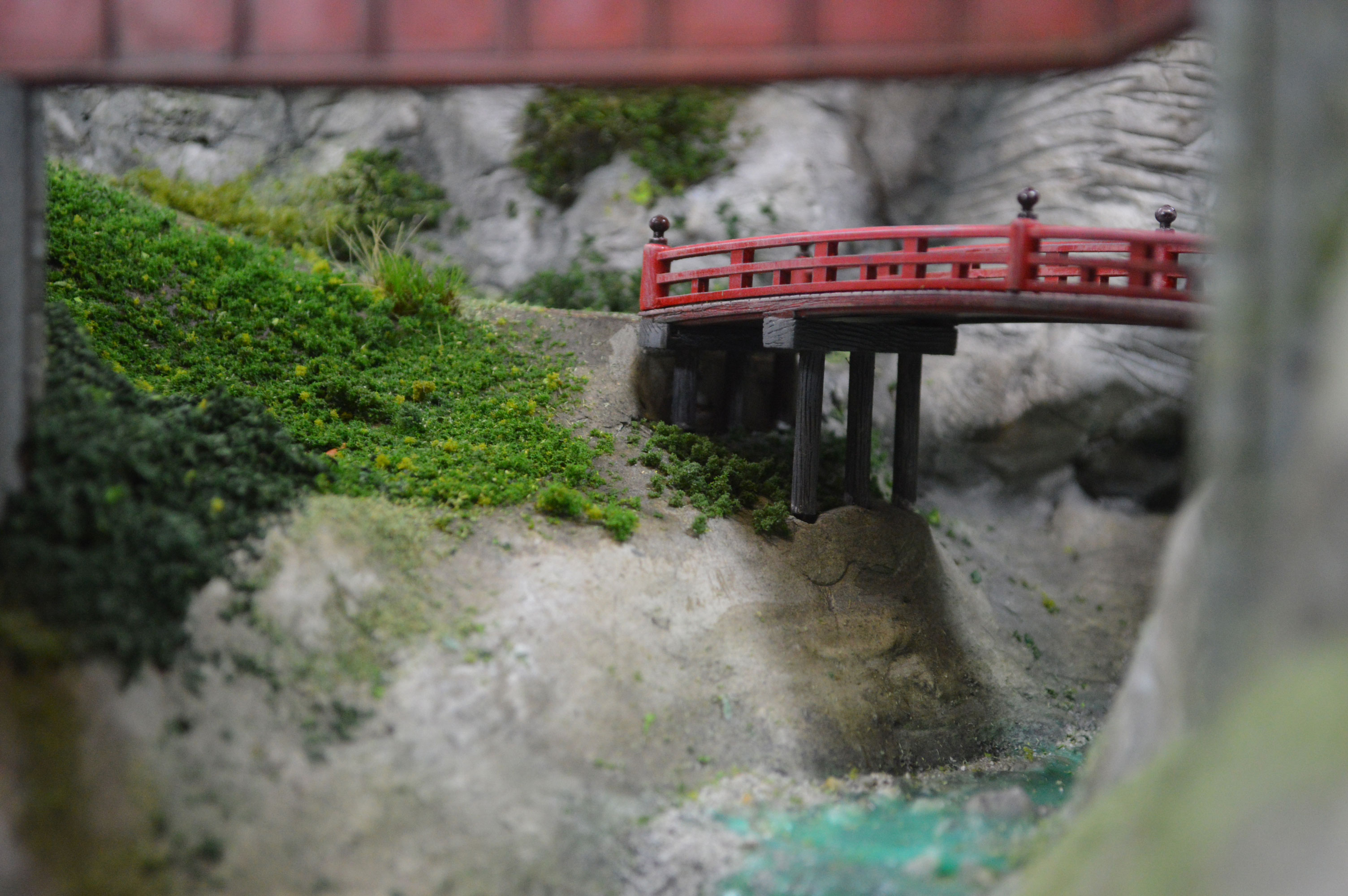

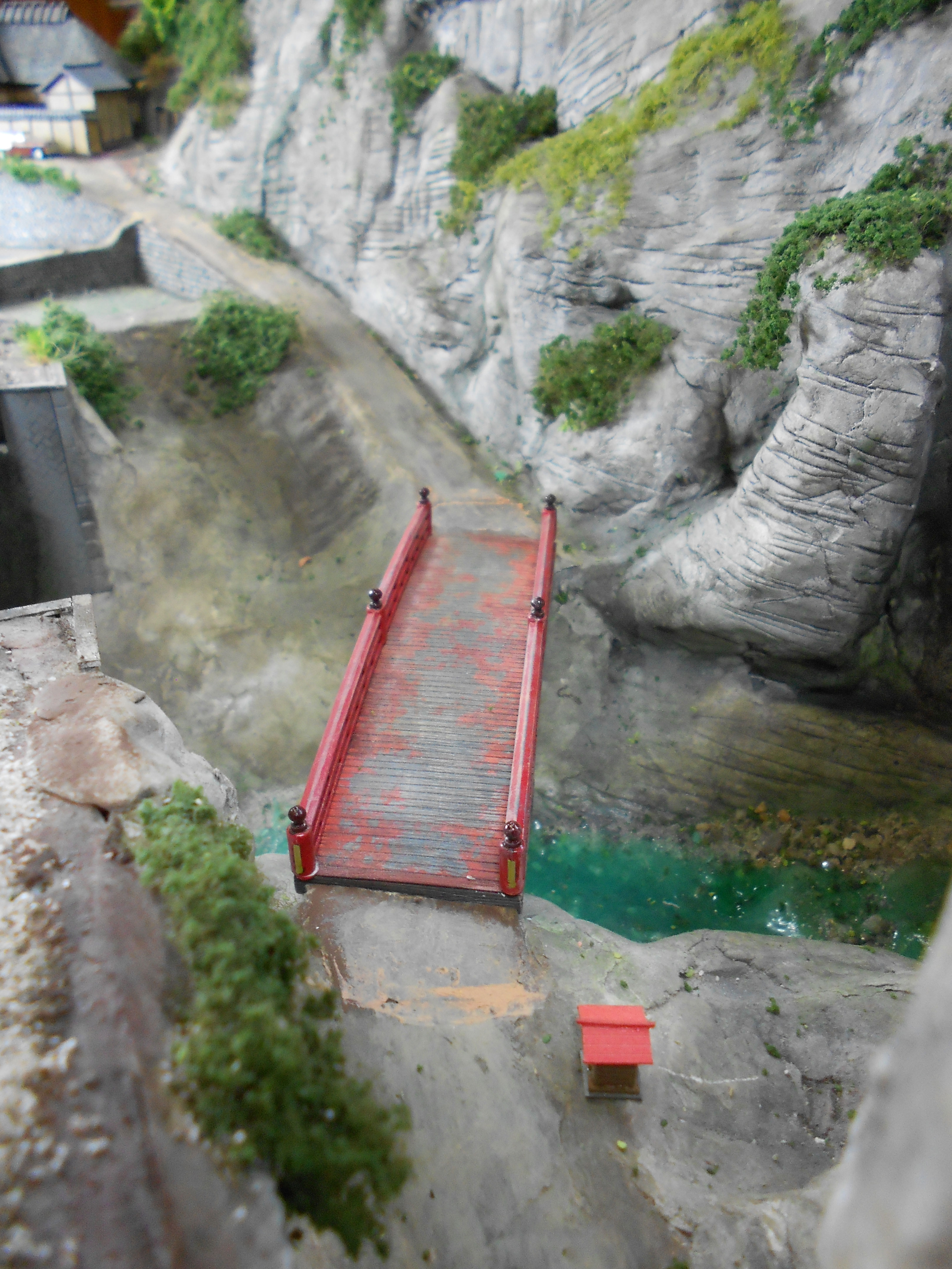

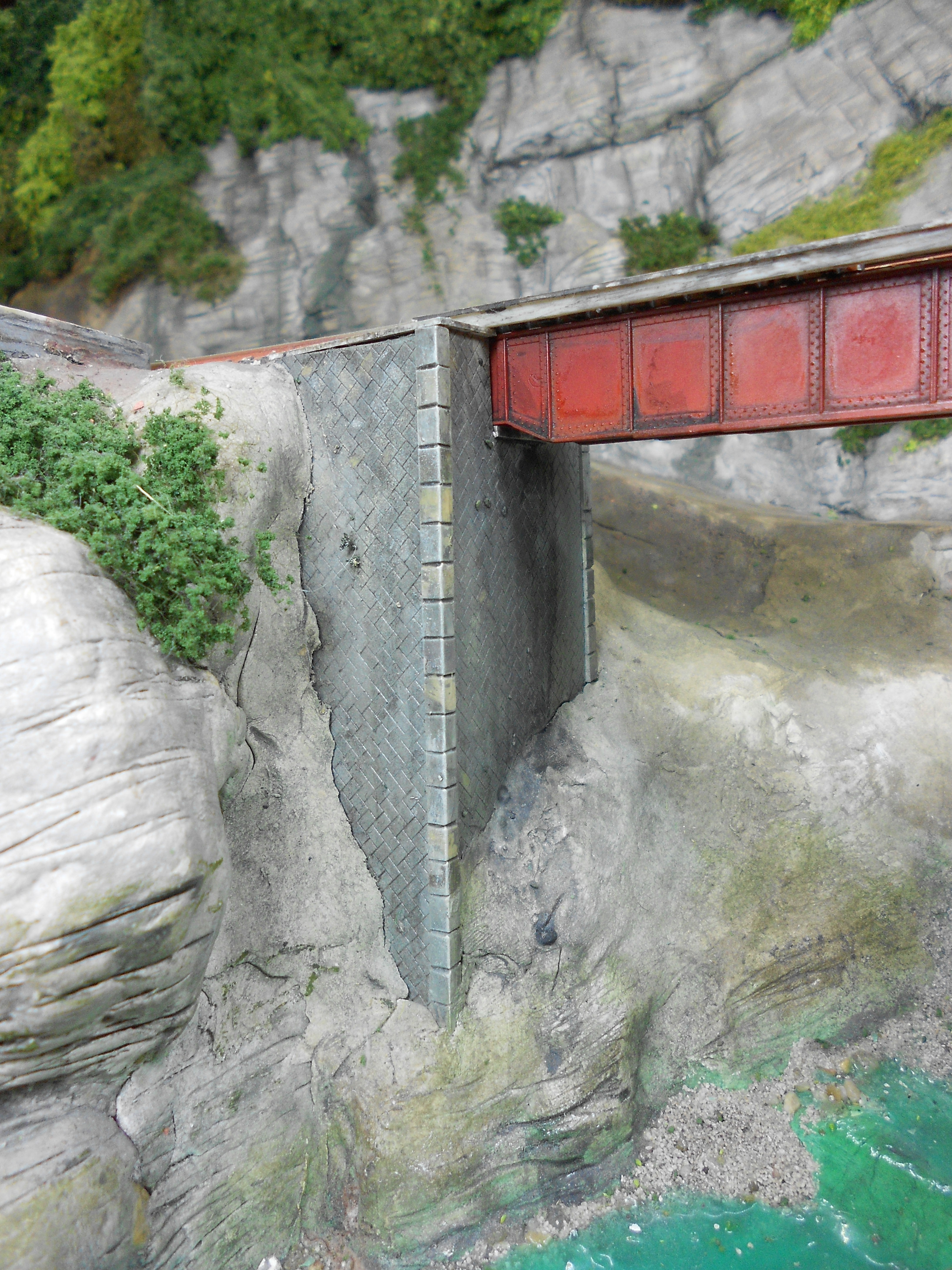

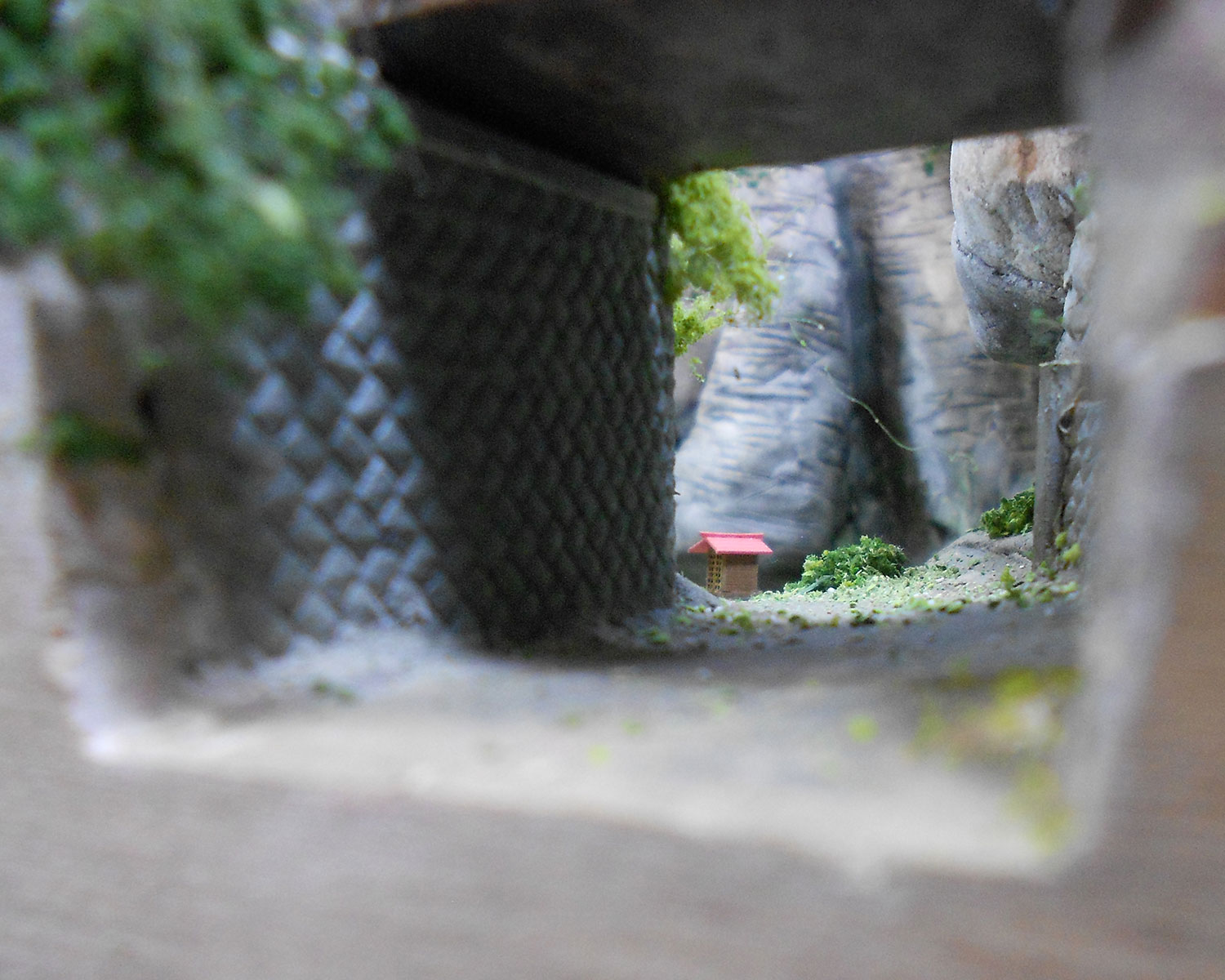

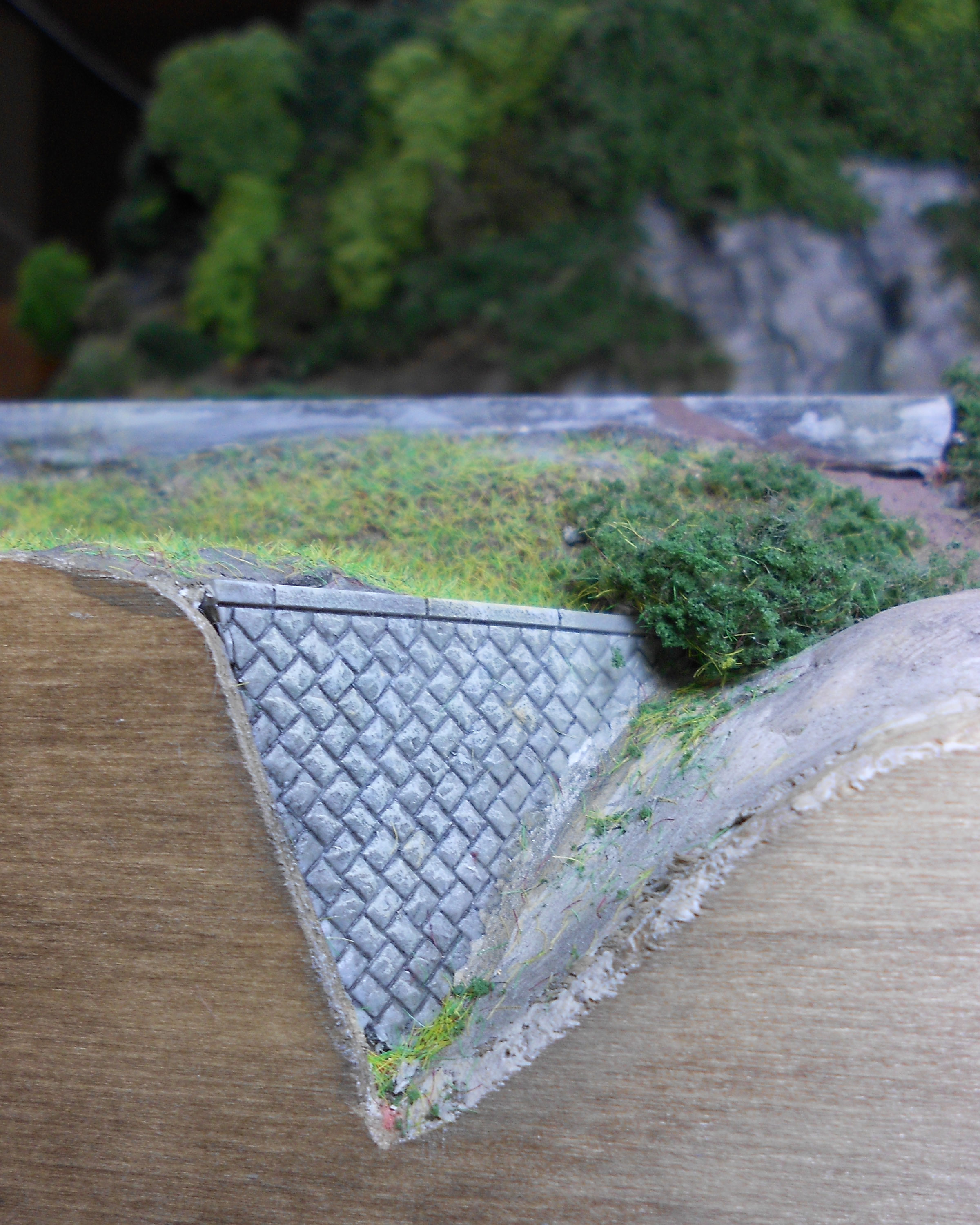

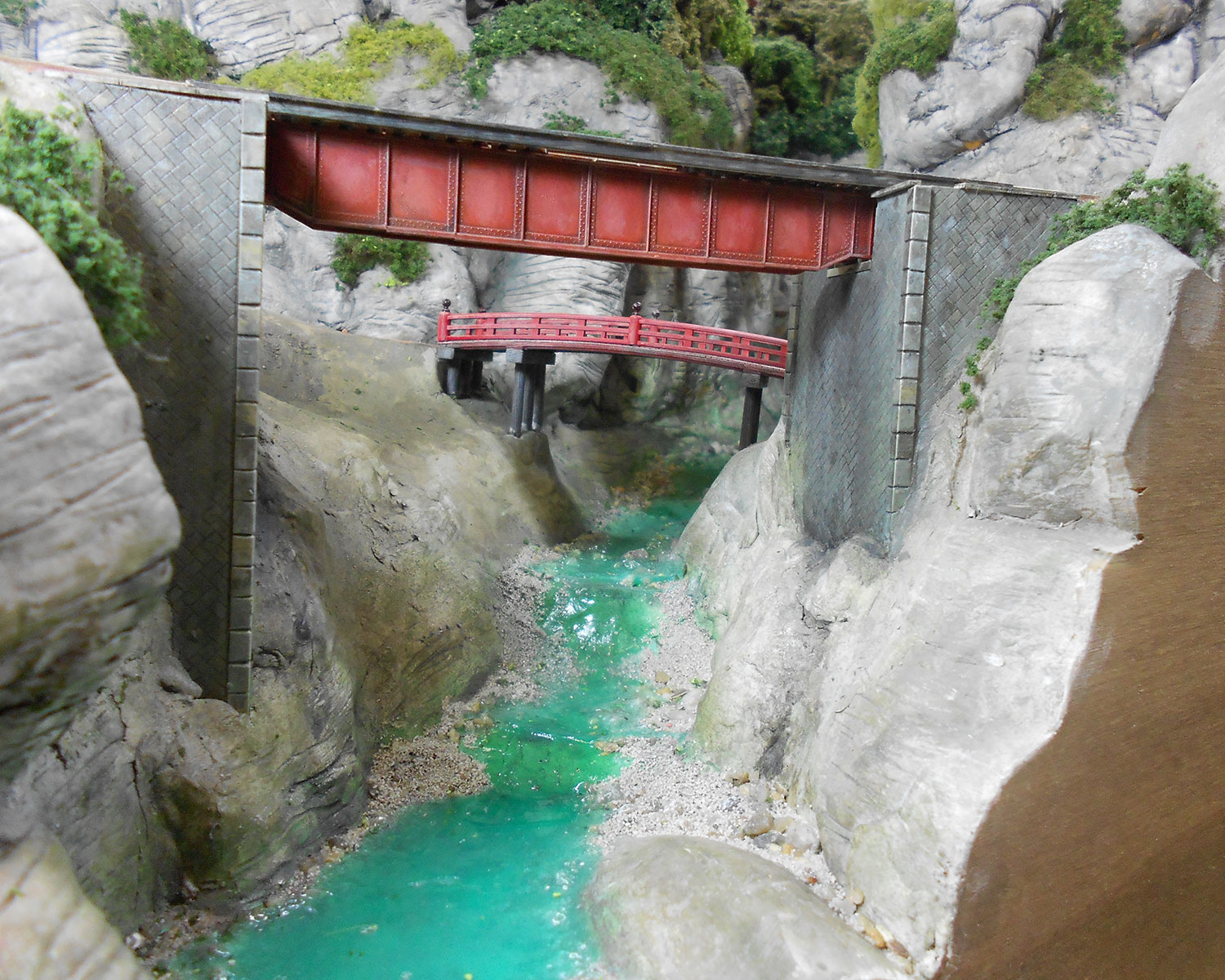

Went on with the bridges area of the layout. they are central in the stage setting. The layout is so tiny (1.04m, some 3' 2") I had to explore scenery breakdown with different levels and the rock outcrop that partially hides the track.

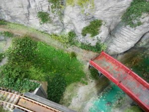

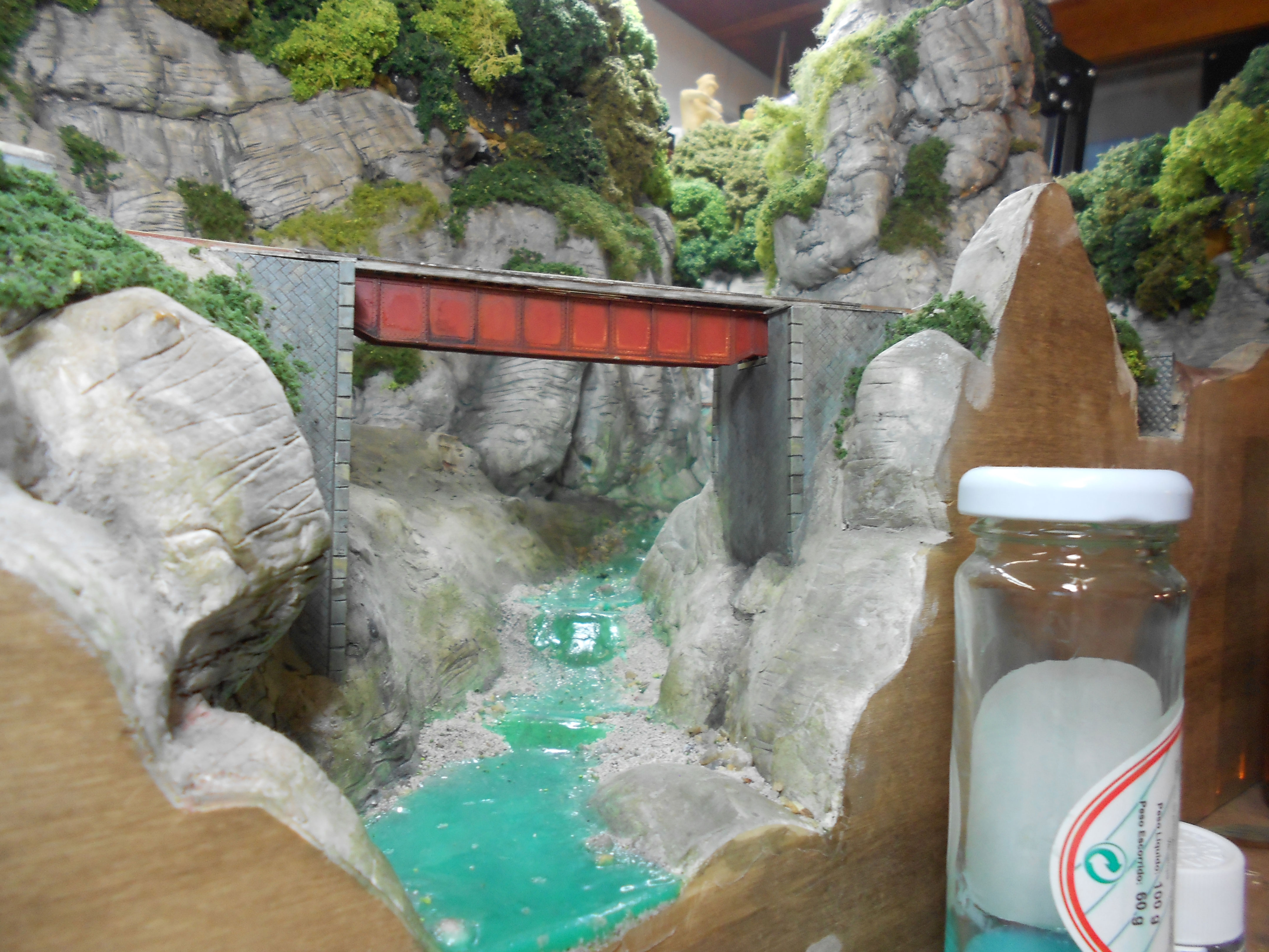

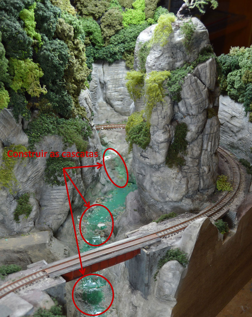

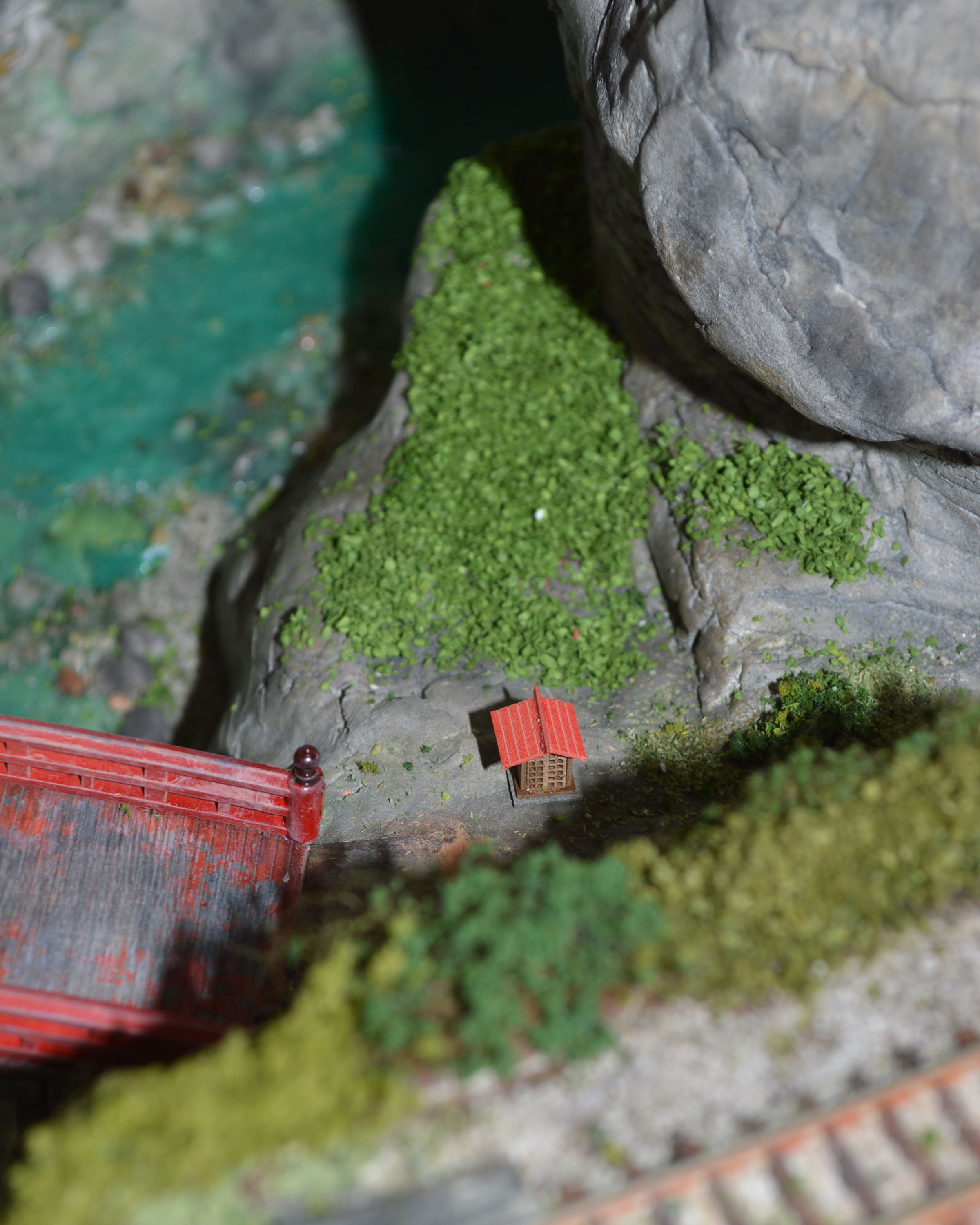

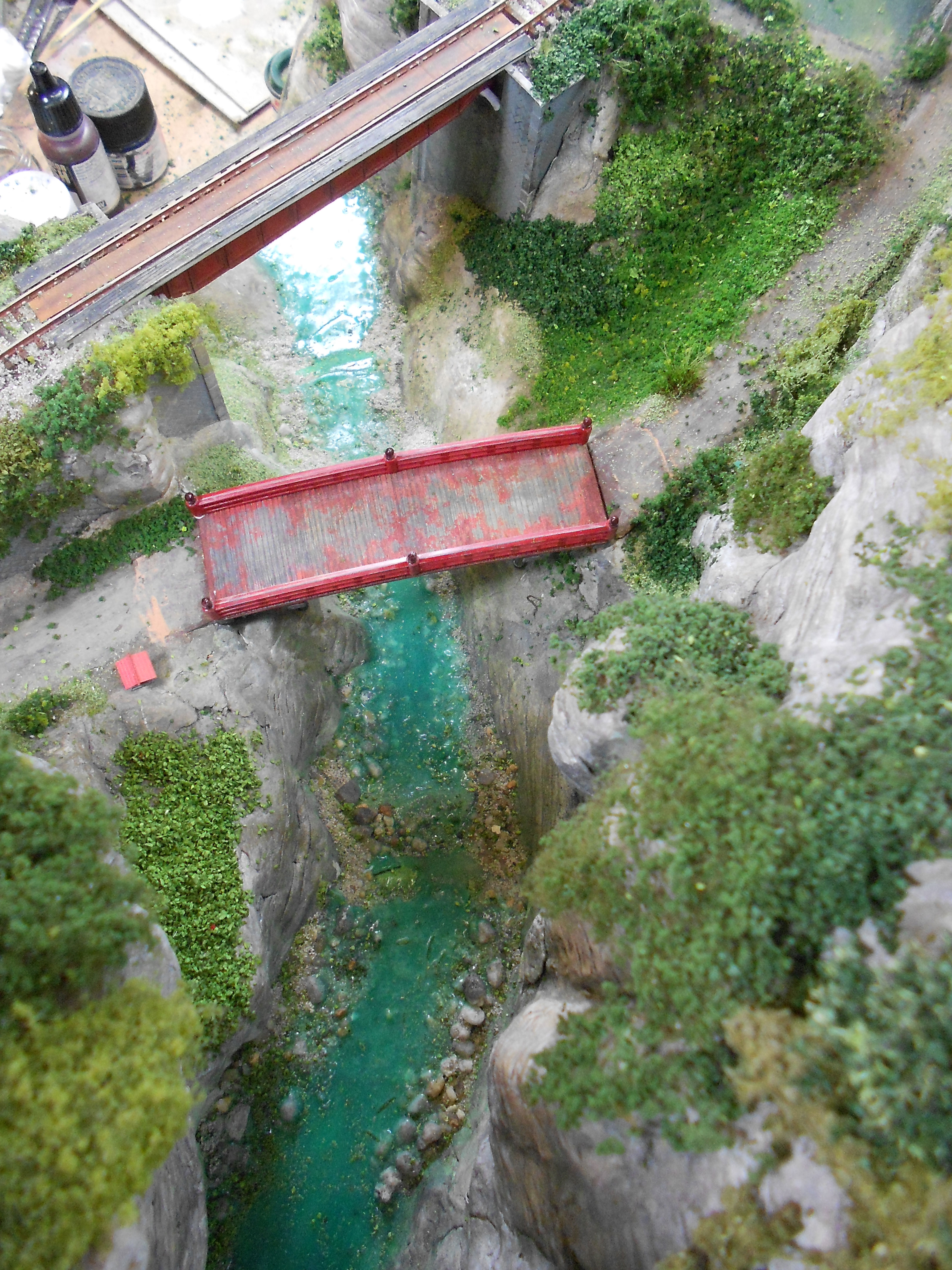

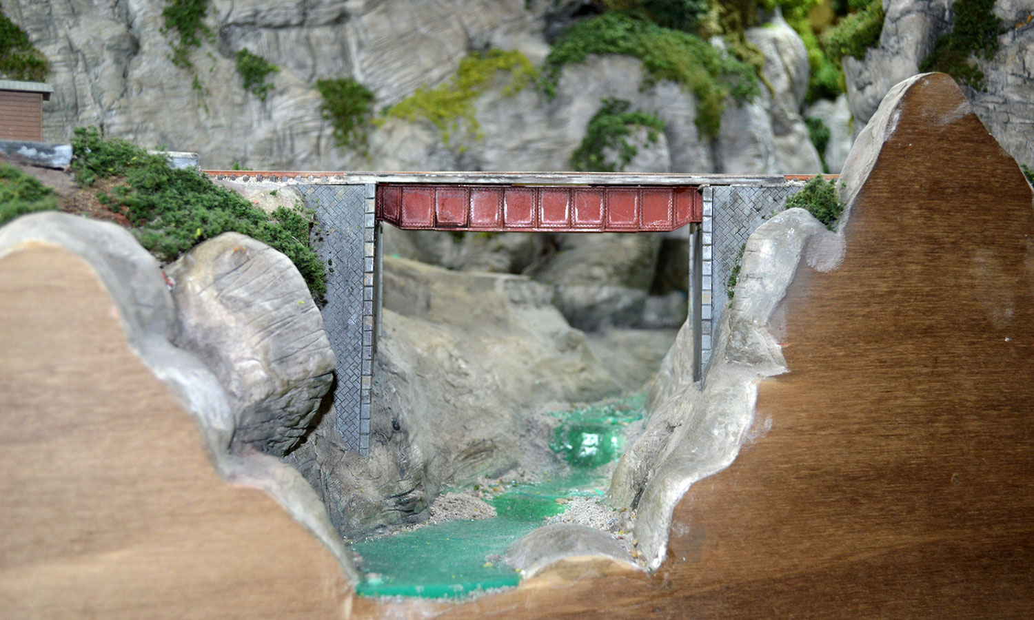

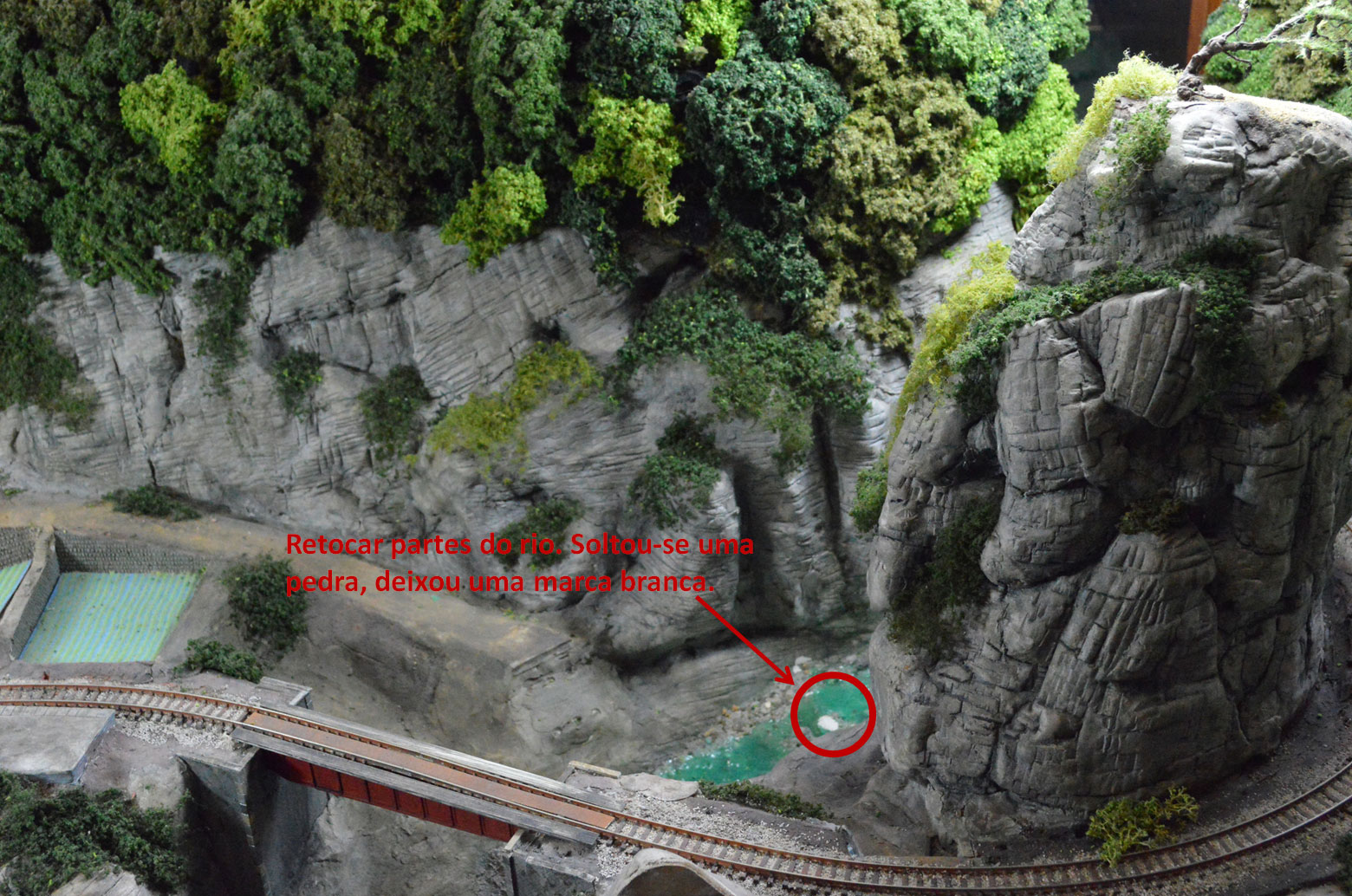

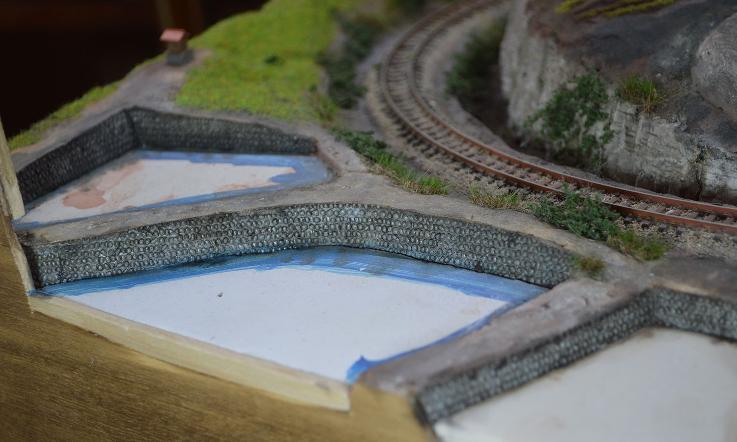

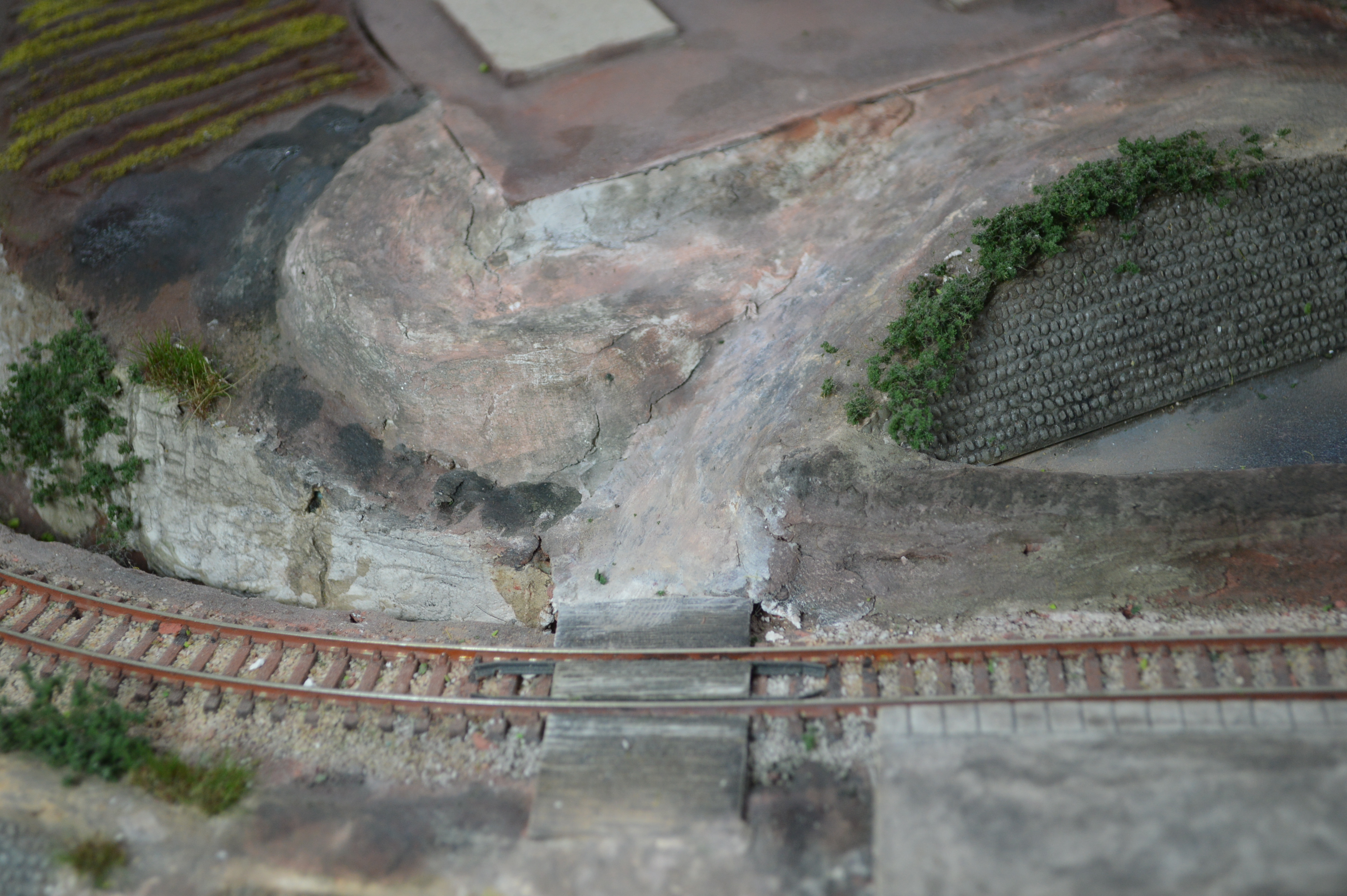

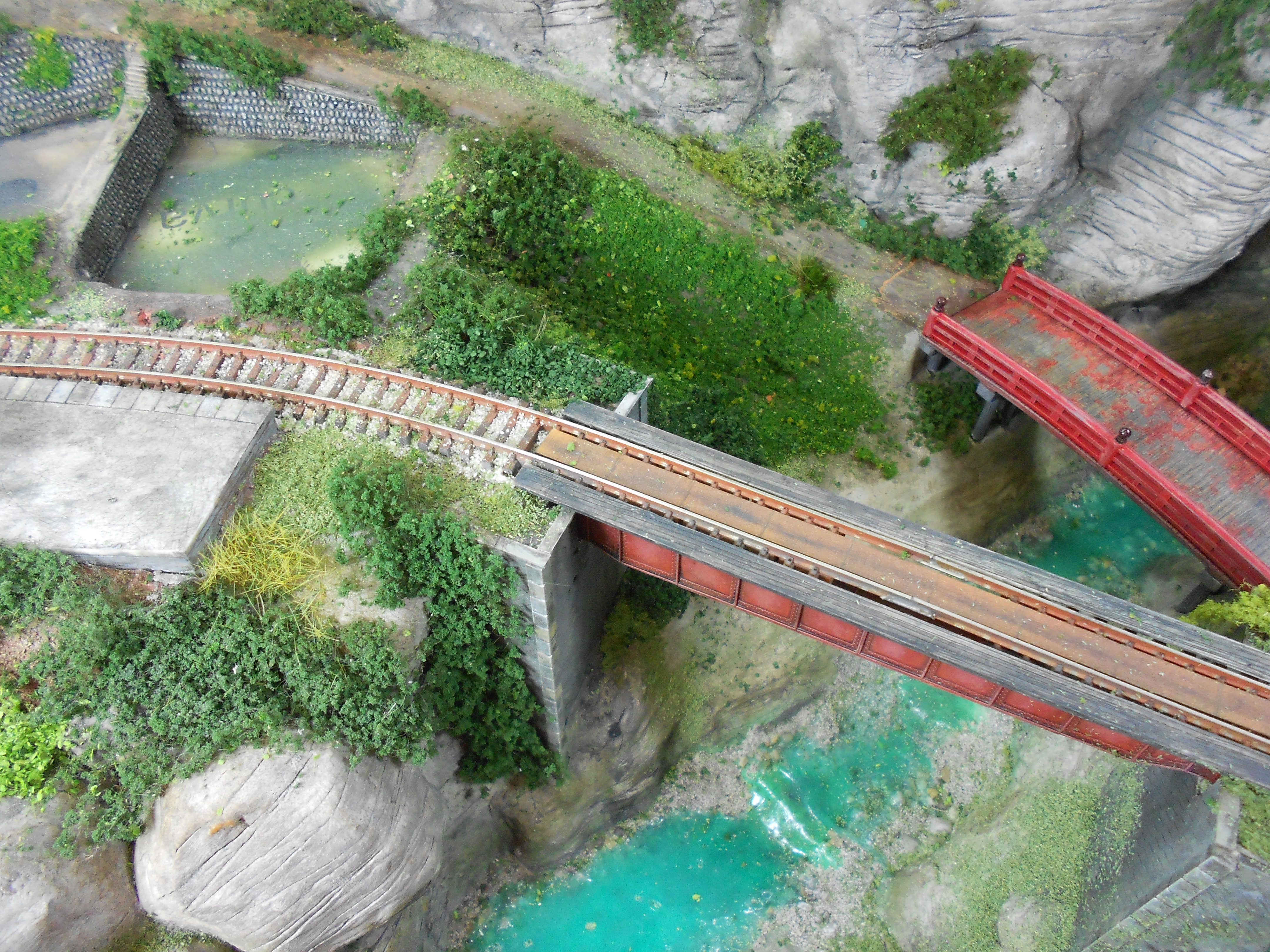

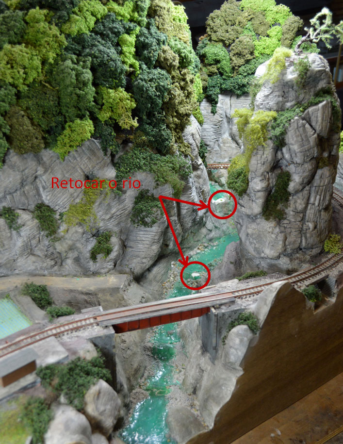

Then I had to tackle with the "holes in the water. I must have pulled to strong when cleaning foliage that was falling over the river that I removed pebbles incrusted in the acrylic varnish.
Started by painting with a close match colour and than add small portions of "water". Luckily I prepared a jar with more than needed so I had the mix still available to pour over.
Another product - an acrylic medium gel high gloss - helped to give the ripples of the stream. They have to be applied in thin layers to get a total transparent volume after cure.
The final details were done with acrylic titanium white paint in tubes.
I'll have to take better photos showing clearly the white foam of the river stream.

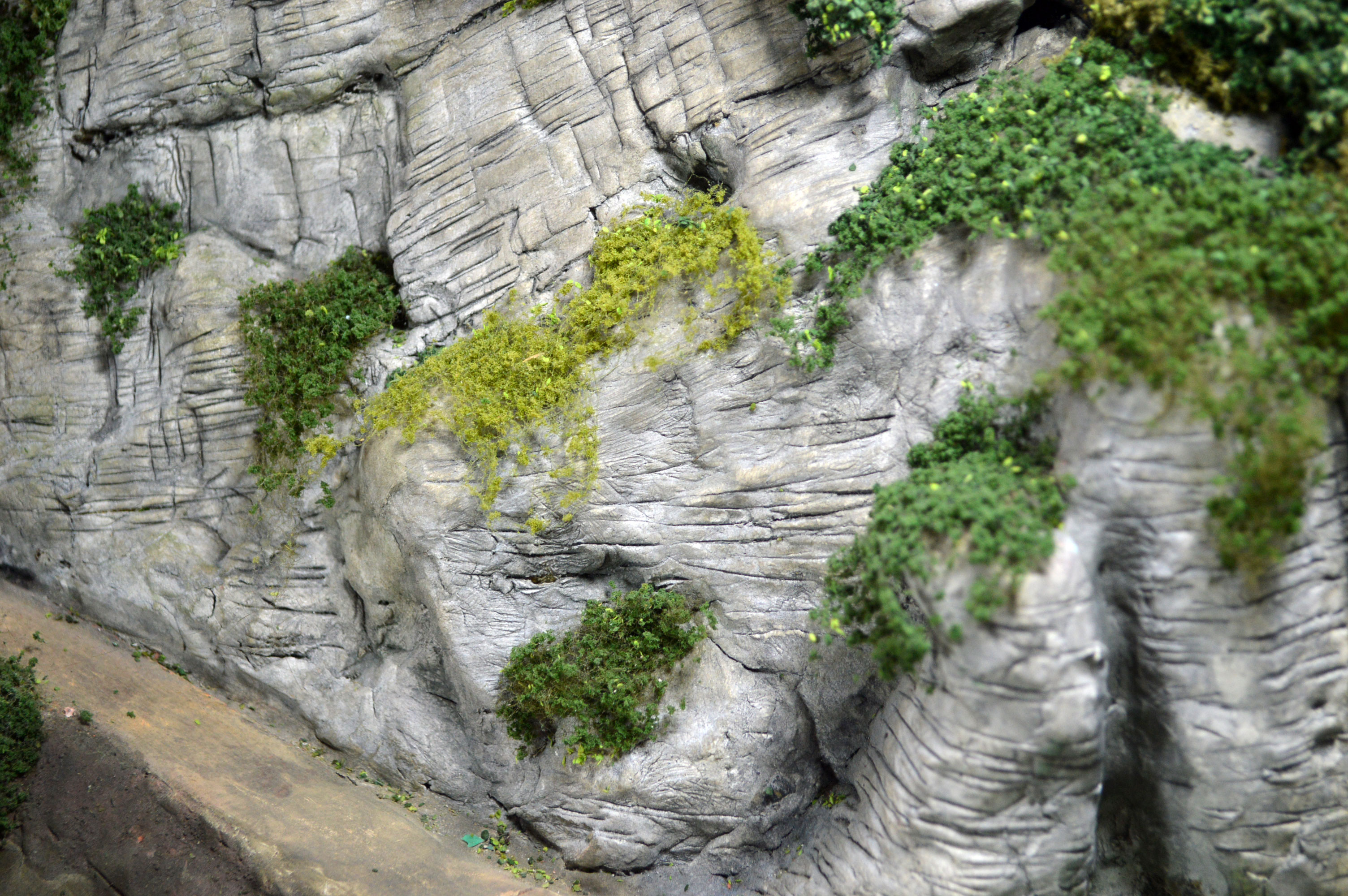

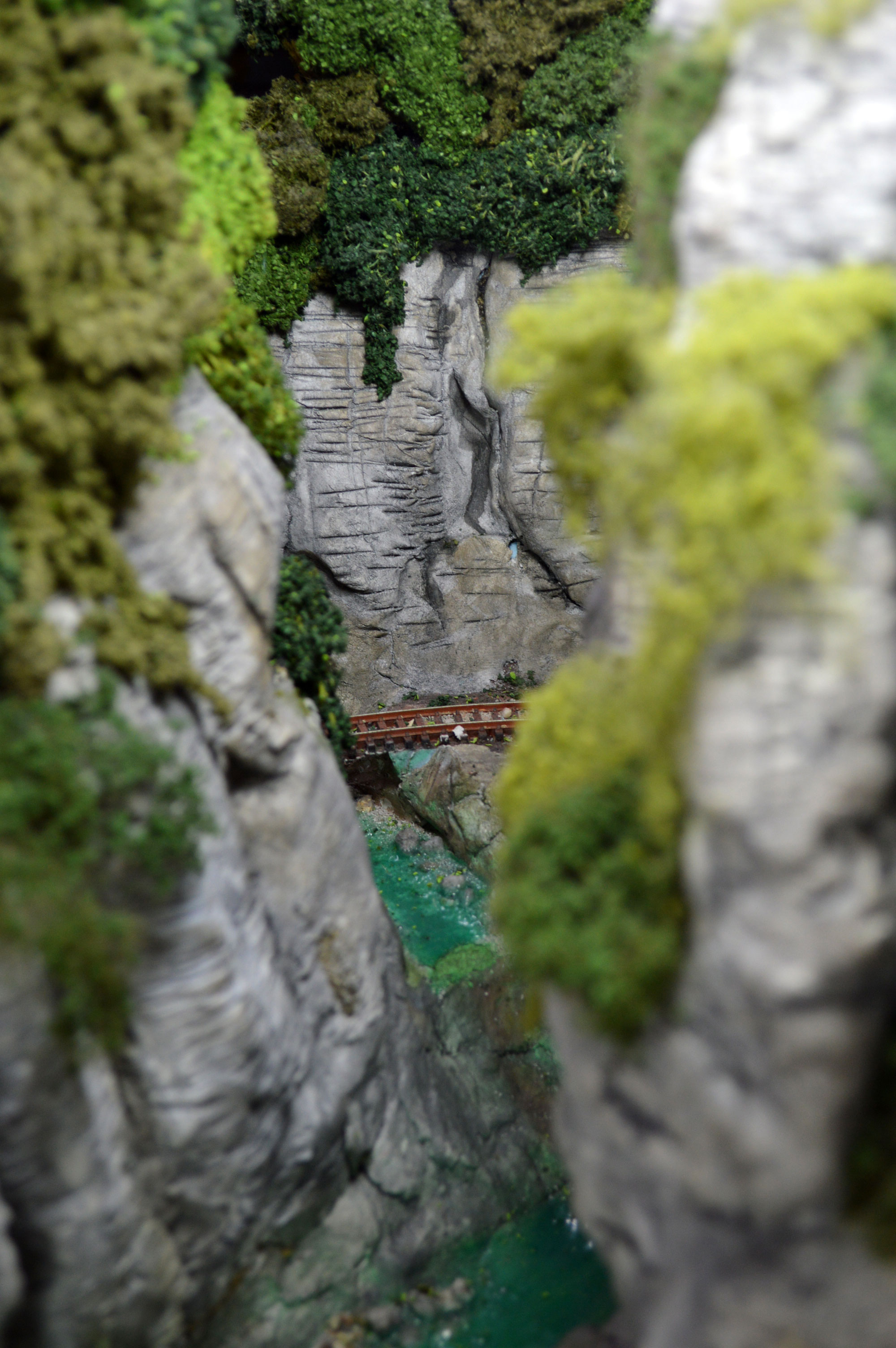

I still have some areas of the mountain to cover with foliage, the black paint under is visible in some areas.

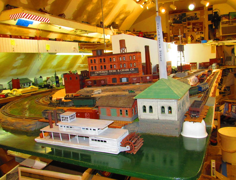

Glad you got rolling again, and are back to sharing. I'm in the middle of a massive rebuild of my large Ho layout, and have too many other irons in the fire, so progress is painfully slow. I love your green water, we get some of that in the mountains of TN, not sure why, but I love the look. I usually paint my water with acrylic paints and use acrylic gloss medium. that would not work on my big river, cause the riverboat, which I like to move around would stick to the gloss medium. I used polyurethane floor finis here, doesn't look as good, but is more durable, can put drinks on the river without coasters.

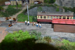

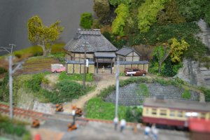

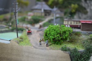

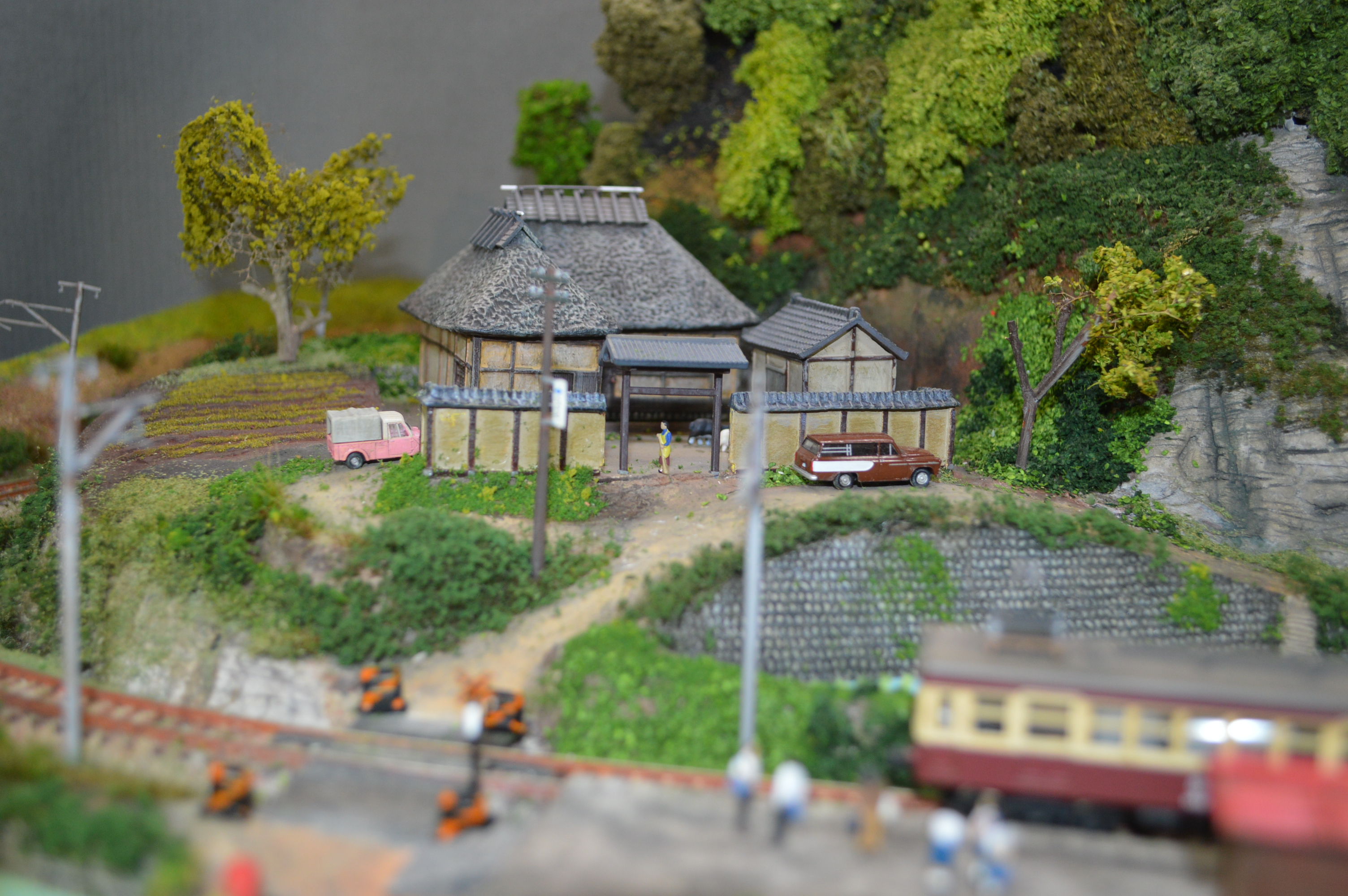

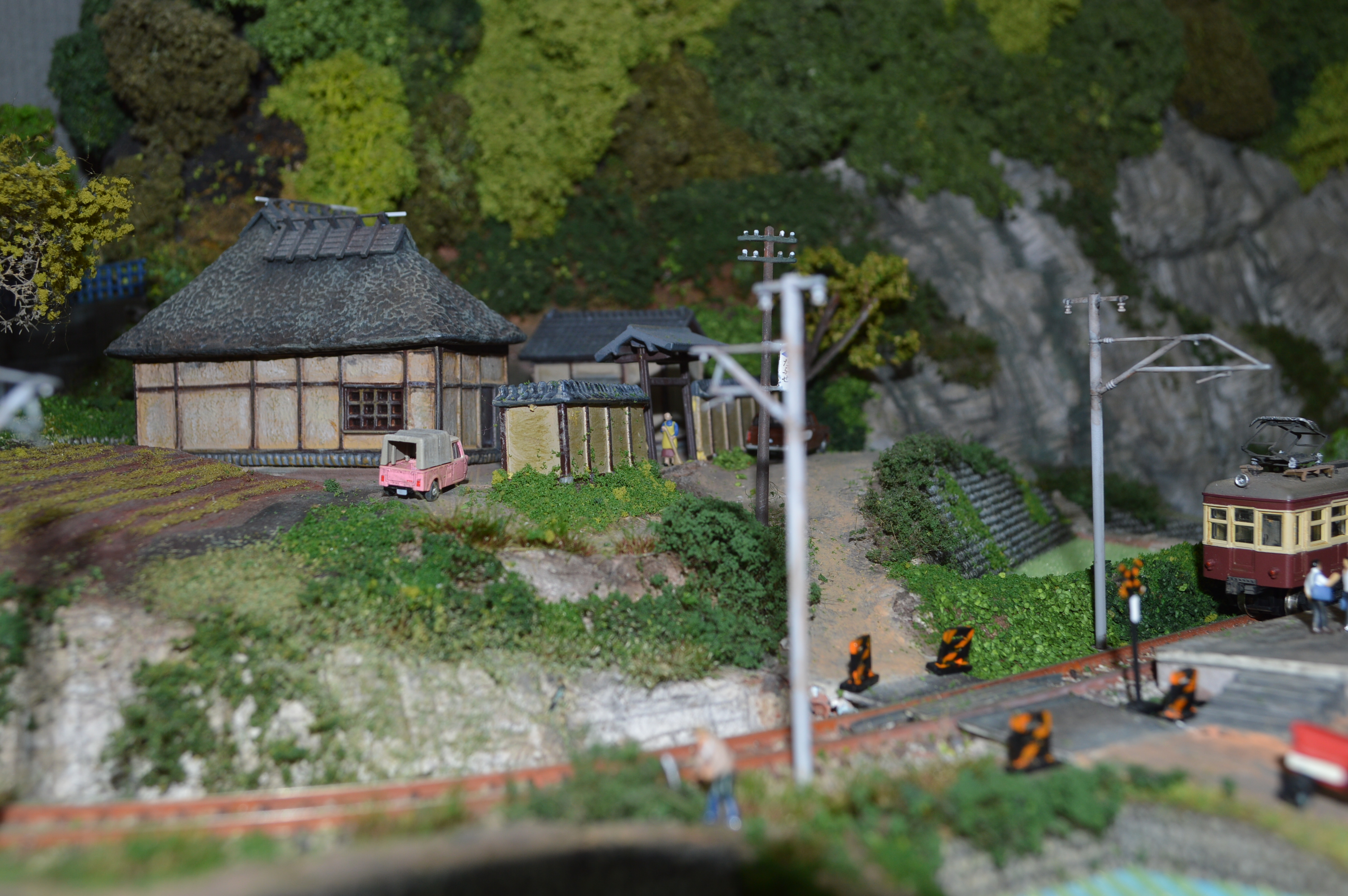

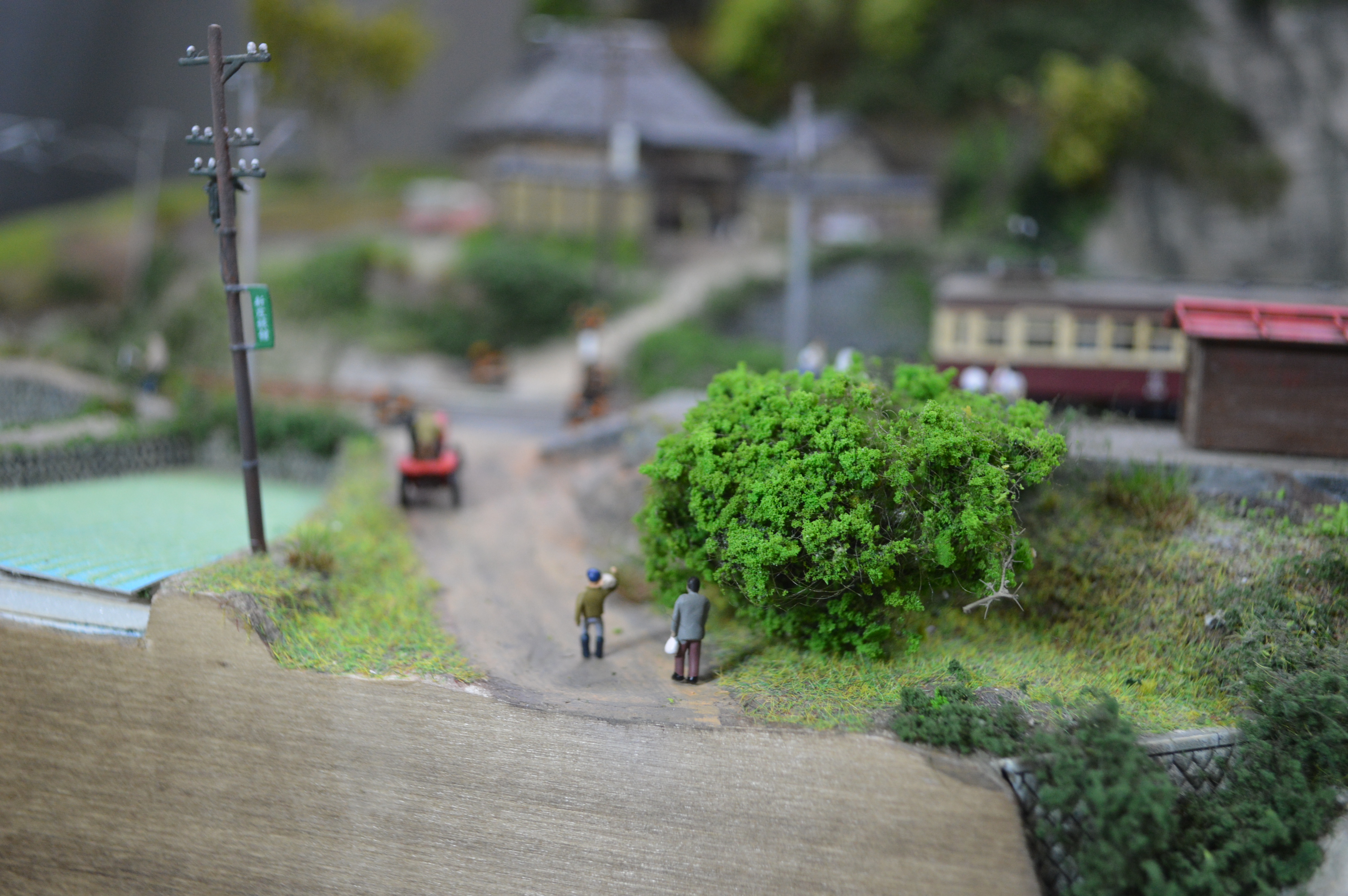

Eager to feel life in the layout, I added in this stage some tiny people.
