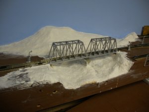

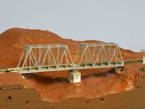

I haven't looked in on The Gauge for a long time, but today I decided to do a little more work on the scenery surrounding the modified Kato bridge that is mentioned in this thread. This is a picture of the bridge as it was when I finished today.
Kato Unitrack Bridge

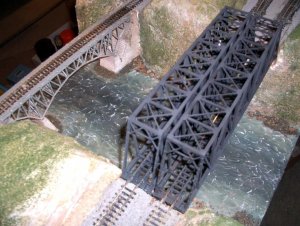

Denyons
Kato Bridge Bash Redux

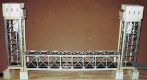

UPGUY,
Your bridges looked great 8+ years ago and they still do! Your post brightened up my day considerably, since I thought I was the only laggard when it came to finishing projects. My own Kato bridge bash, which I started about 2 years ago hasn't been worked on for well over a year. It's still only about 75% complete and still needs cables, sheaves, walkways, a bridge tender's structure and painting and detailing. The bridge was scratch built from basswood and styrene upon 3 double track Kato truss bridge decks. I decided not to use any of the other structural components of the bridge as I custom designed the truss.
ENWHYCENTRAL

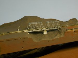

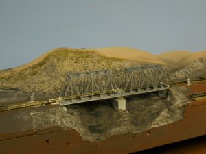

This is the look of the bridge area as it was left over the weekend. Tuesday, I expect to give it another coat of paint and maybe try to work the mountains into the layout background. I should have taken some picture of the area so I would have a "real life" look to the background. Instead, I'll just paint some hills and hope that my memory of the area is good enough...(that's a really huge expectation).
