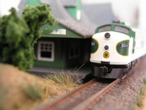

Kato E8/9 coupler conversion picture
Finally figured out how to get a close up that's not shaky and in focus...it shows the extra shank length of the coupler conversion that allows the Kato E units to be run end-to-end.

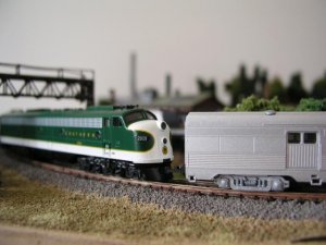

One more of the lead diesel
Just pulling into the station...(but I'll mention to the engineer that his lights are off).
