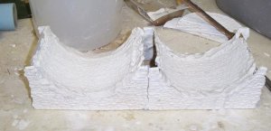

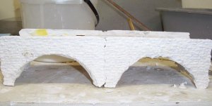

I have seen a lot of rock carvings on walls and such, and it looks fantastic. Considering the fact that artistically I have trouble drawing water out of a faucet, I make do with what I have. I got the viaduct all cast an put together. Now all I have to do is carve on the side parts of the bottom and try to make the side joints invisible, (hah) then cut it down to the right height. If and when I get it in place I'll picture it then. This is as far as I've got .
Lynn

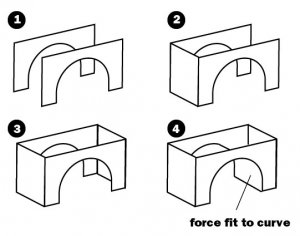

Xavier, I think if you're going to carve the inside of the tunnel, you should do a solid casting. Fitting pieces of plaster together just sounds like more trouble than it's worth.
Here's a method you could try. Build a mold out of styrene following my handy-dandy diagram below. Alternatively, you could build the whole thing out of styrene sheets that already have the rock texture.
Maybe I'm just stating the obvious here, but this is how I would do it.

Thanks Val for the mold design; that's about what I had in mind except I was going to use wood lined with wax paper for side support and styrofoam for the arch support. I don't know if the styrene would hold up against the weight of the heavy plaster-of-paris. I'm afraid it might deform. Also I am not adept to working with styrene or even what glue to use to ensure a solid bond. I will check the LHS to see if they stock styrene stone molds of some description. At any rate, I really want to carve my old stone pattern. That way I will never have two alike--like John Allen.
