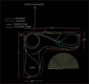

Here's a sketch of what I've come up with so far. I still have plenty of thinking and planning to do, so this is preliminary. I'm not into operations, but plan to learn more about it. Any good web pages with info on operation? I know nothing about it. Thanks.

Keep in mind that the reach into that back corner is going to be somewhere in the vicinity of 3'. Also remember that your longest train should not be longer than your shortest reverse loop and reverse loops have to be isolated and wired differently with DC or DCC.
That back left corner is going to be a helix. I am going to test build one and run a train first before I ever make a final plan. If it don't work, no helix then. It will also be under a mountain, so will the other corner. The wall they will be against isn't a load bearing wall and on the other side is my work area that will be future expansion. So I will be making some access doors to get under the mountains (don't tell the wife). I am tall with big ape arms, and I measured that I can reach 30" comfortably. I've done a couple layouts and had to start over a couple times and have learned that proper planning pays off big time later, even though some plans do need adjustment. I had two reverse loops on my last HO layout and they worked fine with DCC. I did buy an DC engine that will need to be converted, but that's another story. I'm going to try to get a link to a video of my HO layout that I had to tear down before we moved. It's nothing special. Thanks.
