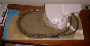

This is an HOn30 microlayout. Total dimensions are 14"X35". I used regular n scale track and the minimum radius is 6". This is meant to be a small tourist tram on a tropical island. A small gas-electric trolley will service a dock (upper left), a beach area with a few small restaurants (lower left), a scenic tropical jungle with waterfall (lower right) and a hotel/resort area (middle). My original plan was to have some high rise art deco style hotels butt up against the vertical wall section in the middle, but now I’m rethinking it. For the gauge party, I plan to figure out what to do with this area and will add landscape/buildings to either the beach area or the jungle area.

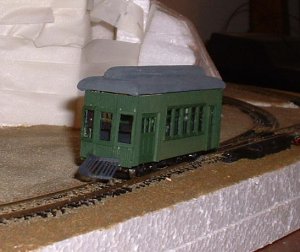

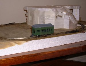

I started working last weekend on the gas-electric. This is based on the photos here:
http://www.ironhorse129.com/rollingstock/builders/hicks_loco_special.htm
My version is significantly compressed (from 35’ to approx 25’). It’s a basic structure: essentially a box made from scribed basswood, with windows and doors from Grandt Line (the DRGW narrow gauge stuff) and a pilot out of the scrap box. I made the roof out of balsa, carved, sanded, and covered with kleenex to simulate a canvas or tarpaper roof. I will tweak the colors a bit, add signs, headlamps, grab irons, etc. This is still really rough – roof to be permanently attached, lpb passengers to be painted and added, gaps to be filled and etc.
