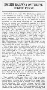

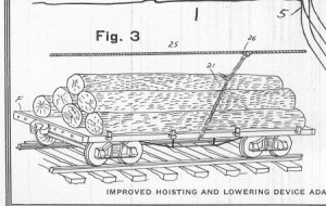

Think I posted my original question on the wrong forum. I did get a number of views but no answers on my "Logging Question" under T Q&A. Want to do a new N Track module showing the Sessom's system of hoisting and lowering a log car up a very steep grade, probably 30 degrees depending on my module size. I purchaed Willamette's Iron and Steel Works book at a recent train show and found the equipment and three views of the system. The pictures need a little more clarification to make my module work. I have searched the internet and could find nothing further. Need some help here fellow modelers! Here is one picture showing a system of double tracks. the loaded goes down and an empty comes back.

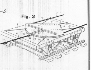

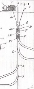

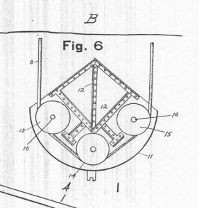

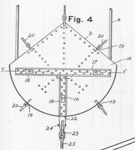

I am interested in the sheaves alongside the tracks to keep the line from dragging. How did the line from the block car feed into these? It looks like the block car is nothing but a giant pulley on wheels, did it have extensions to feed the lines into the sheaves. Also was the block car seperate and loaded log cars attached to it? Questions, Questions.

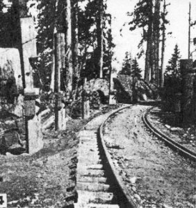

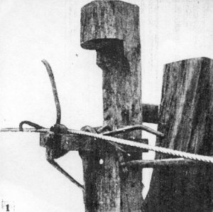

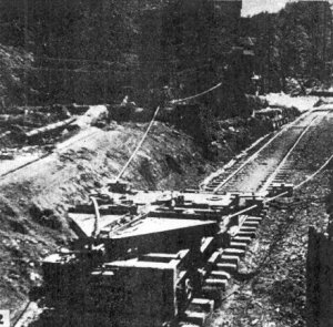

These are some scans of the Sessoms hillside logging system. These are from page 75 of the October 1913 issue of the Timberman magazine.
Jimmy "B"
Jimmy that was perfect, thank you ever so much. You answered all my questions and now I can start planning my new NTrak module. Think it will be an interesting one and I hope to make an animated one. Lot of kinks to work out, to get down to "N" scale, but think it can be done. Guess I will have to bend the NTrak standards for module construction again. Will definitely be beyond the 2 foot width on this one.
Jim thanks again, you've got my mind racing with details and plans.
