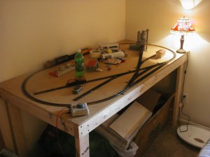

Here's my 5"10" X 33" setup...gotta love apartment living:rolleyes:
I'm running 15" radius Atlas snap track, 40 to 50' rolling stock and 4 axle locomotives at most. Might have to hack up (shorten) some Bachmann coaches so I can run some passenger trains. Being 22, I haven't had space for a 4x8 since I was 12. The girlfriend is probably going to make curtains to hide all of the rubbish under the table:)
DCC is coming soon!
