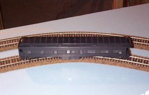

After I posted my question about which passenger cars you prefer I remembered that I had am old passenger car I bought in 1961 and had stashed away.
My question here has to do with appearance, not of the old undec car, but about the very short piece of curve it is sitting on in the picture. This is the only place on my entire layout that I am concerned about having tied in a curve that is unrealistic. It looks just fine with "normal" freight cars and all of my limited motive power, but I'm just not sure about a passenger car. It is probably academic anyway as I would have to make some major modifications to change it, but I would also like to learn if I have made a mistake :)
What do you think?

Hello George:

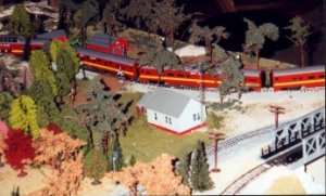

Your turn looks ok to me. I was told that a 32" raduis is idea for IHC cars. However, you can get away with 22" raduis track. In this picture you will see Atlas's 22" raduis as an "S" turn. I had many problems to get it to work. After the bugs were gone, it just looks funny! :)
Andy

If that curve is too tight, but looks right for your freight, you have created an ideal freight spur. Try and move the station. "S" curves are only found around marshes and along mountain sides and river banks. They're usually broad for speed, and to prevent your passengers from spilling their Pepsi on themselves!
Try to think realistically when laying track, and if the curve is too tight, cover it with a tunnel, hide it with a string of buildings, or even a backdrop.

Bob, I wouldn't worry about that curve. As long as your trackwork is good I bet you can run anything you want across it as long as you remeber to keep the scenery down around the curve so yoru car doesn't grab things. Despite what people say I can run the IHC that I have on 18" radius all day w/o derailing it. That might change once I tighten the trucks...
Bob, After studying your picture of your curve it looks a little sharp.The over hang on your passenger car give it away.but since that is a athearn car you should be fine.As these cars are not full lenght and was made for the athearn train sets of the 50s and the begining of the 60s.the sets came with 18"r curves,which the cars ran on with out any problems.:D
Thanks Brakie. I don't think it will cause me any operational problems, it is just that there is that one very small arc in the curve where you get that slight overhang. On the other hand, to try to move it now would be a big problem as those parallel tracks pass under a trestle just a few inches to the right and I would have to make a major modification to open the curve slightly. I think when I am operational no one will see what the picture shows anyway as it is not necessarily a place you would want to stand to see most of the operations on the layout.
