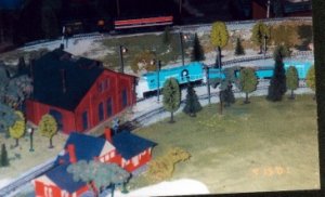

I had the same problem with mine IHC passenger cars! Here's how I solved the problem, only temperory. I taped nuts to the inside of the cars. Sounds crazy but it works! Why did I say it is only temperory? Because I want to add the "guts" to it. The end car I added a flashing LED to it. I use "AA" batteries to power it. I am haveing balancing problems with it. I think I will add the watch batteries instead and put back in the nuts.

IHC
George:
You must have the same IHC cars as I do. Look at that BIG red lense on the end car. I added a flashing LED there. I also replace those darn couplers!

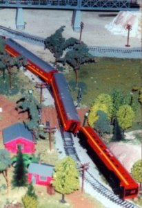

Justind:
This is what happens when you don't listen to the experts. I have a 4ft x 4ft spur on my layout. I used 18" raduis. I was warned by the local modelers, when I purchased my IHC cars. They warned me I WILL have problems. I sure did!
Look at my picture very carefully and you will see what I mean. To make matters worst. I added a tunnel! That was a stupid move. After some modifications, it doen'st derail as often. Next time I wont be doing something like this! I learned by not listening and making mistakes.

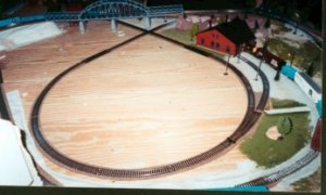

JustinD:
This is part 2. Look at that stupid move I had done! I put my main passenger station in that darn loop! I could never use it because the train would derail! Since then I moved it out of there. Works alot better.
I have learned alot. Most of the time it's poor planing. With being on a budget, I can't just rip it out and start over. Even though I wanted too! So what is the loop being used for? It's being used for storing extra rolling stock. (Didn't add a yard..another dumb move). And storing my extra locos in the round house.

I fixed my problem! Yesterday, I was running my IHC cars. Darn things kept derailing outside the small tunnel. So I sat in a chair and watched it as it was coming out. Here's what a found. I few specs of ballast on the inside rail. I removed it with my hobby knife. NO MORE derailments. I ran the train for almost 2 hours with no problems. I still wont add the turn in my next layout!
