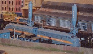

As I created decals for my freelanced railroad I learned a few things that I hope will be helpful for others. I wanted to have the name of my line in white letters within an orange strip on two F units.
I discovered quickly that ink jet printers like mine do not print in white...they print colors you can select as fill around blank characters to allow the white paper to show through as white letters. Testors makes a white backed decal paper for this purpose. I realized that the standard orange color in the background and fill selections in "Word" did not match the orange stripe I had already painted on my locomotve. Using the custom color option I finally matched the fill color as closely as possible to the orange stripe. It took many trials but once this was done I could create the decal and apply it to the strip so it would appear white letters had been painted in the stripe. After spraying the printed decal sheet with decal bonder I applied it to the loco and found that the white backed decal film is thicker than regular decal film. I could see the edges of the decal. I used some orange artist chalk to help blend the decal within the stripe.
After it was all said and done it occurred to me that I could have simply created the stripe itself with whit letters within from the white backed decal film! :)
Here's how my effort turned out after some light weathering:

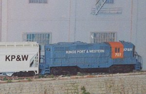

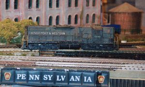

I was surprised to find similar challenges even with black equipment like this former Pennsey SD9 that has been purchased by the KP&W. To get the white letters I made a small black strip with blank characters on Word that would come out as white on the decal film. Who knew that the black from my ink jet didn't exactly match the black loco! Well, Brunswick Green I suppose. Any way, the decal edges were obvious until I covered a good part of the loco body with a pigment wash. Now the decal is not so obvious on this hard working filthy engine. The pic tells me I need to weather the trucks and fuel tank as well. :)

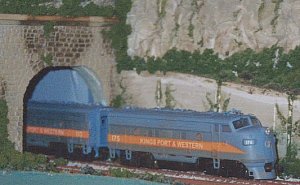

I managed to nail the blue color when I made decals to go on blue loco bodies. They blended in very well and only needed a couple of over sprays of dulcoat to make the edges less evident. The numbers on the orange cab are left over Microscale Penn Central numbers. The transparent film with white numbers made it a snap of course. Obviously it would be much easier to use a printer that prints white letters and numbers to do these jobs.

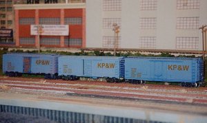

I used clear decal sheets to letter these box cars. The cool thing about making decals is how easily you can create individual car numbers. I copied and pasted the KP&W logo and the reporting information several times and then went back and individualized the last couple of numbers (in pairs of course for each side of each car).

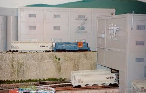

Here's some covered hoppers at the Cargill plant....again, each is individually numbered to make operations with my switch lists more interesting.
