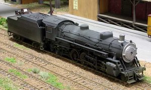

… these Trix NYC Mikes are sold at incredible low prices at the moment here in Germany. I planned to get a BLI ATSF Mikado when they release their new run next year, but a Trix Mike with ESU sound for 116 EUR (US$ 139), I could not resist. And I don’t regret my decision. The engine looks great and it runs and pulls as well as my Atlas diesels – I didn’t expect this performance from a steamer.
Now I am trying to make my Mike look like an ATSF class 3100 engine. I need a new headlight, a bell for the top of the boiler and a number plate for the front of the smokebox. I hope to get these detail parts next week. Unfortunately, I could not get the train indicator boards you find on ATSF steamers. Perhaps I have to try to scratch build them.

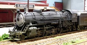

I had to use sanding paper to remove the NYC lettering. Trix does not use decals, they print the lettering. It resisted alcohol and MicroSol.
As a next step, I painted the front of the smokebox and the smokestack silver.
As you can see in the picture above, the engine still looked very clean and new. I want my Mike to look as if it had been in service for a long time. Today I took my airbrush and changed this clean look. I can tell you, I was quite nervous, because it was the first time I ever used my airbrush to weather an engine. I am glad, I did not spoil it.

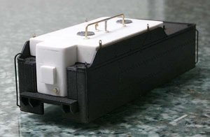

Thank you all for your nice comments. :wave: I don’t know if I would have had the courage to paint the engine, if I didn’t have to hide some holes I filled with styrene after I removed some parts which were wrong for an ATSF Mike. Miles, I’ve been thinking about this conversion for a while now and you are right, I should give it a try. You can easily take off the coal load to get access to the screws that hold the body of the tender. So I don’t have to damage the tender and can change back to the coal load if I don’t like the result of the coversion. OK, more to come.

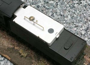

A short report on the progress of my Mikado atsfization. As Miles suggested, I am changing the tender from coal to oil. I am making steady progress, but only veeeeerrry slowly. You can’t imagine, how much time you can spend on making some liftrings :rolleyes: . The next time consuming detail will be the oil filler hatches. I don’t have any detail parts, so I will to take a brass rod, get my file and spend some hours filing and cursing :D . But model railroading wouldn’t be any fun if everything was easy. Stay tuned, more to come.

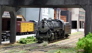

I got the detail parts (headlight, number board for the front of the smoke box and the bell) for my Mike today. I couldn’t wait to install them. You can see the result in the first two pics.

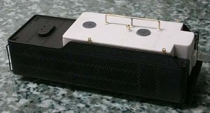

I am still working on the conversion of the tender. I completed the first oil filler hatch.
