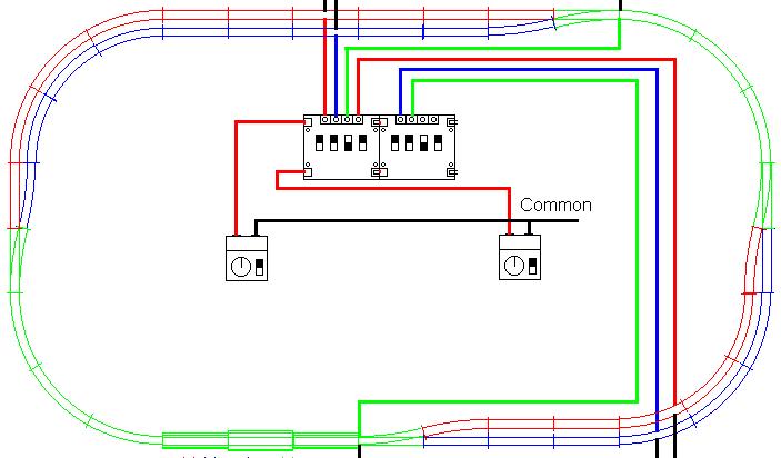

Hello and welcome Viperious! I think I know what your asking and I found one of the simplest wiring diagrams you could possibly use. If not, please ask questions.
Basically what you have here are two cabs, power packs, throttles, or whatever you call your variable DC power output device, two Atlas Selectors, a whole mess of wires and a pretty basic track plan. For this to work properly you will need insulated track joiners, which is what the change in colors of track are. The black represents the common feeders, which whoever I stole... ahem, borrowed this from drew the feeders over both tracks in some spots. Ignore that, it usually goes on only one rail (unless you get into reverse loops, which that's another story).
That's about all I feel I can explain with what was provided, once again if you have questions please ask.
Tyler

I could not give an explanation that good. Well done, really ! Thanks gbwdude!
