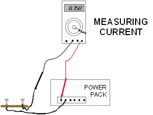

Measuring Current:
There is no current on an open circuit. Once you add a load, or some resistance in the circuit, you will generate current. The lower in resistance the load is, the higher the current. The higher the voltage, the higher the current will be for the same load. That’s why when you increase the voltage from the power pack; the current increases and the train will run faster. Current is always measured in series with the load, that is, you must connect the meter in line with one of the power wires. Remove one wire from the power pack; connect one probe to the power pack, the other to the wire you just disconnected. Set the meter to the highest current setting. On some meters that will require moving the positive probe to a different probe hole. There may be a fuse in the lower settings while a setting of 10A or more usually aren’t fused.
If for instance you want to find out how much current your new loco draws at slow speed, adjust the power pack to the setting you want and put the loco on the track. Turn on the power pack and read the meter, if it’s too small a number, you may have to lower the meter setting. If the meter value keeps changing as the loco goes from one section of track to another, that’s a good indication that you have some rewiring to do. It could mean that a rail joiner is not making good electrical connection or that you need to add a new voltage drop to the rail section that is affected. Undersized wire will cause these problems as well. As you increase the speed setting on your power pack, the current will increase as well. If you have a lamp connected to your power pack, as you increase the voltage, or speed setting, the lamp will get brighter and the current will increase. The total current at the power pack is equal to the sum of all the currents required by all the loads you have. Let’s say you have two locos and at the 50% speed setting, they each draw .250 amps, and you add four lights, each drawing 50 mA, or .05 amps. Your total current draw will be 700 mA or .7 amps. You have to check the label on the power pack to see what the maximum output is. Some are rated in amps, others in watts, or power. If you exceed the rating, one of two things will happen. The unit will shut down until the load is removed and or the power pack it reset, or on some cheaper units, the voltage will drop to compensated for the increased current and it will heat up. Some have thermal overload protection, but the ones that don’t can be damaged this way, so whatever you power pack is like, it’s best to know how much current it can safely deliver and how much your equipment is loading it.
