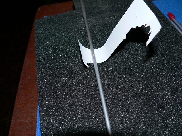

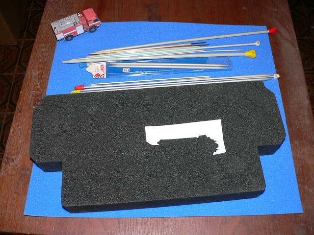

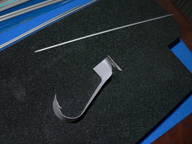

Hello,
to curl paper I use a piece of foamed material like a camping mat or packaging material. Then I use a round wooden stick or a knitting needle. I have a collection with various diameters. With this You also can make rounded corners if You do not want to get the whole paper rounded.
Lay the paper on the mat and roll forth and back the wood or the needle. The paper will curl towards the needle. You can try it with a little piece of paper first before You take the real modelling parts. When I am at home I can make some pictures to show it or to make it clearer.
Kind regards
Markus Schweizer

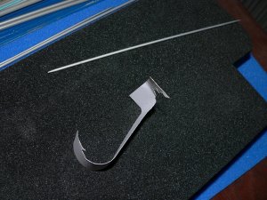

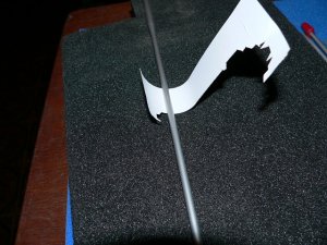

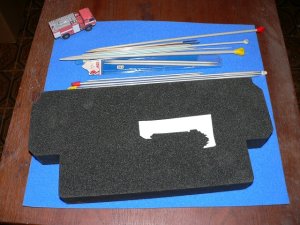

Hello,
here are some pictures with an example for using foamed material and a needle to curl paper. Another modeler explained it to me at an exhibition.
Kind regards
Markus Schweizer
