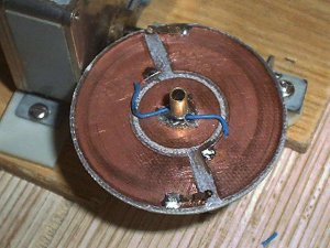

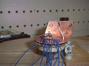

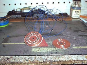

The most recent turntable I built I designed and built a contact disk into the drive under the table. It not only transfers the power, it changes the polarity of the rails to match the the tracks around the pit and also energizes the track it is lined up with.
The wipers on the inner ring of the stationary plate on the left transfer power to the rotating disk on the right(2 wires are soldered to the rotating disk that lead to the turntable rails are not installed yet in this photo). The polarity of the rails is reversed as the disk rotates and the contacts transmit power to the opposite sides of the disk.
The wipers on the rotating disk transmit power to the individual tracks as the line up with the corresponding contact plate on the contact the stationary plate.

Ray and shortliner, thanks for the info. This gives me a couple ideas to go and think on. Ray, I really like your method. This shouldn't be to hard to do with raw PC board stock by shaving and cutting the copper away to in effect make a PC board.
Thanks again.
Ray, I checked out your link. Very nice job. I like the contact plate very much, I'm going to build one and give it a try. My turntable is completed except for paint and powering the rails, so I'm ready to get this done and try it out.
