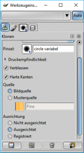

I zoomed into the image at 200 % to locate all inconsistencies (marked in red). Using the clone tool I removed all major spots. Use a fuzzy brush to avoid sharp edges. It is best to have the clone tool directed (I hope this is the correct English term, just refer to the following image):
Choose an area right below the defective spot, hold down the Shift key, move up the cursor (straight up!) and click. Since the clone direction is set you may continue by just clicking on any other spots to remove them. You have to choose a clone point straight below the cursor because you want the bright lines stay vertical. Once you choose a reference point beside it the line will not stay straight when you clone over it.
