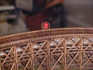

Here's a picture of the one I did. Hope this helps!
