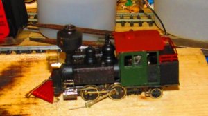

Test fitting.
I am test fitting some of the parts of my Baldwin 0-4-2 after painting.
The cylinder saddle has had some repairs made to it, and has yet to be painted, the headlight and bracket are new, and need to be painted as well.
I will probably remove the cow catcher, and install a KD # 14, and a home made freight pilot
the flash has altered the colors some the satin black paint doesn't look quite that shiny, and the greens and reds appear darker . still some random touching up needed as well.
Bill Nelson
The red wood rack needs to go, I'll try green. years ago this locomotive was in passenger service. I think the cow catcher will go in favor of a frieght pilot. this may work on the little isolated track at the ore transfer, and it definately needs a micro layout, possibly inside a radius that the Blackstone c-19 can negotiate.

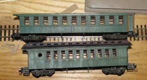

It has been a while since I have posted on the narrow gauge end. I have started another Labelle HOn3 coach, this one a model of the Parlor car Alamossa, which is notable as it has an open platform on one end, and a vestibule on the other. the car sides are on the workbench in front of a Florence & Cripple creek combine (No longer in production in in HOn3, although they make it in On3) and a slightly kitbashed D&RGW coach ( the oval windows were my addition.
I'm going to build up the parlor car, and hope to add a short RPO car as well to make a four car train to go behind My Blackstone C-19. speaking of Blackstone, they are now selling HOn3 passenger trucks that are awesome. for a while no good rolling options were available after the horizon hobby folks discontinued all of the MDC HOn3 trucks. the Blackstone passenger trucks roll as well as the MDC trucks did, and have a lot more detail.
When I paint the parlor car I will un weather the coach and combine to make them varnish worthy of the C-19. the labelle cars have lived at the club, I seriously doubt they would go around the 16 inch radius return loop in Gegokayoosa
The other photos show the c-19 with a hon3 combine that was kitbashed by cutting down a MDC HO standard gauge shorty Overton coach,

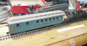

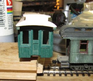

I have been working on my Labelle woodworking Co hon3 parlor car Alamossa kit. I got the car sides done, and shot with the first round of paint. it is spray paint, not exactly the right color, but close. It will seal the wood to help prevent warpage, and give me a good base for the final coat of acrylics.
This is an odd car, as it has an open platform on one end, and a vestibule on the other . The prototype was built as an open platform coach, and was later rebuilt into a parlor car. This is the first Labelle kit I have built with a vestibule. The drawings are isometric, so I really had to pay attention.
this will be my third Labelle Hon3 car, I have a florence & cripple creek combine, that is no longer in production, and an open platform coach that had a little kitbashing done to it (the oval windows at the bathrooms) to separate it from the D&RGW prototype. I'd like to get a short RPO car to add to this string, that will look really good behind my C-16 or C-19. I have put new Blackstone passenger trucks on these cars. the trucks roll very well, and have better detail than the old MDC passenger car trucks, that looked ok, and rolled very well. they used to be the best option available until Horizon hobbies discontinued them. thankfully Blackstone has stepped up with a better (although more expensive) option.

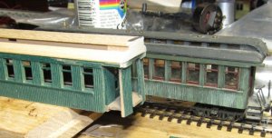

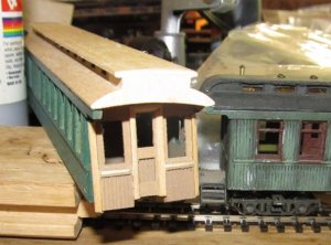

I have gotten the windows painted brown. I still need to paint some stripwood brown, and add door trim to define the vestibule door locations. the brown window trim was not original to my scheme, but when Dr tom located the built Florence and Cripple Creek combine at a train show, and pointed it out to me, it was painted brown, and lettered for the Bonanza and Rawhide railroad.
It had full interior, very well done, and window glazing. the window glazing would have made repainting it to the State line railroad's green very tricky, and with the full interior, removing the glazing for repainting would have been too much work. I simplified the process by painting the window sills brown on my existing coach, and painting everything but the windowsills on the combine.
I spray painted the roof tan, both for the interior color, and for some priming. with these Labelle kits, the trickiest thing is sanding the milled roofing to the proper curve at the ends. the instructions have good templates, I usually end up doing it mainly by eye.
On the roof I still need to fashion some curved boards to carry the overhang on the celestory through the end curves. then there are some vertical elements to add along the celestory windows, and I have to figure out where the roof vents for the kerosene lamps need to go (the drawings in the kit don't show, and the interior set up as a parlor car will make it different from the coaches).
I will also need to paint and attach the platform , and the other bolster (the bolsters are integral to the platform castings so the one for the vestibule side I cut down to provide the bolster, and the coupler pad. the holes in the bolsters for the truck mouting screws, and for the coupler pads have been drilled and tapped, and holes have been drilled for the truss rods; so with the under carriage just needs to have parts painted and installed.
of that project assembling the couplers will be the toughest job. It is hard to assemble HOn3 couplers with the jig, and nearly impossible without it, I have already shot 2/3rds of the parts for one coupler halfway across the room. That is reminiscent of what, my old cohort Jeff, the transmission mechanic called a Jesus Clip.

as I'm working to get the new parlor car to match the existing combine and coach that are to weathered for my current taste, I am drybrushing all of the cars with acrylic paint from the craft store (hunter Green) which looks close enough to Pullman green for my eye.
Just less than half of the coach has been dry brushed with the hunter green. it looks like it may take two rounds of dry brushing with green to un do the weathering, which is no longer appropriate, since my era has migrated from 1948 back to the boom times of 1928.
