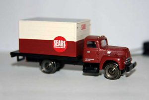

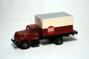

I wasn't able to get another Boley International (which would have been my choice) and since I am pretty eager to get this project under way I got this Mini Metals International box truck. I kind of doubt that there were many hi-rail box trucks so I will take off the box and make a bed for it. I was thinking of puting a small crane, some misc. stuff, and a tarp on it to cover up the decoder.
I would like to continue using the Zip Zap motor (or something similar in size) as it is small and fits perfectly between the frame and is barely visable from the sides.

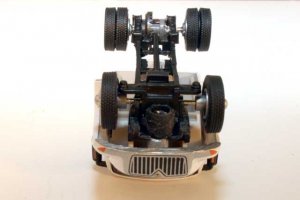

You might want to try one of Bachmann's Ready to Run HO scale Hi-rails. They are actually pretty nice!. They are all powered and will run!
Here's a pic.
MY LHS has them for around $30
Bachmann also makes a Hi-Rail Utility truck
And also this thing which I can't quite describe

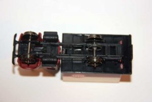

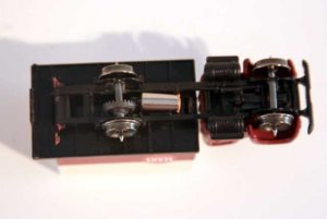

Made some more progress last night so hopefully this will clear up how I will be using the HO scale wheels. I was also able to get the drive gear installed.
I did some more research on dropping the voltage down but unfortunately the only thing that I can find is using a voltage regulator or an SCR like David mentioned; but by the time I try and put all of the electronics on the truck I would need to leave the box on there anyway so I might as well save myself the hassle and just use a larger 12v motor.:cry: Oh well, maybe I will find something better for the next one.
That looks funny!
:agree1: I would have to agree with you on that. I am hoping that gluing the original hubs and tires to the outside will cover it up and make it look more natural.

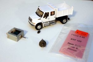

I don't know how this compares to an n scale motor, this motor is about 1/2" x 1/4" (12.7mm x 6.35mm) and the accessory motor I might have to use is 3/4" x 3/4" (19mm x 19mm). Does anyone have dimensions for an affordable n scale motor?
*edit*
I did a search for z scale motors and I am guessing that they do not naturally run on 12v as it was suggested to use a Zener diode circuit to make it compatible with 12v operation. I am still trying to make heads and tails of this circuit but it seems promising. Does anyone have any knowledge of the Zener diode?
