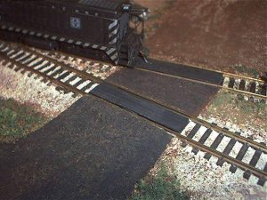

I have been using cork sheets for roads with decent results.
The cork was painted with black acrylic paint.
I plan to add some weathering later.

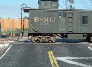

I use the back of asphalt shingles, marked with paint pens and a straight edge, then weathered with pastels fixed in place with clear flat.
