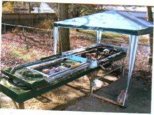

At my age its tough to get things straight. So i will try again to post a picture.
the layout is 4'x16', it has two loops on top, and three loops below.actually, i
can and have run six trains at any one time.The control panel and the front
plexiglass wall are both hinged, to form a closed box.

Again ,this layout is 4'x16', it has three loops and three sidings,on the upper level. then there are three loops ,andfive sidings on the lower level. i have at one time ran six trains all at the same time.that will keep anyone awake.I hope
the next six months are in my favor.I am really enjoying the six hours a day that
i spend on the layout. Its better than watching tv.

Hi Joe I had to run your picture through xnview and resized it , although it looked small there program said to many kb.
Anyway you have the link for xnveiw so you should have no problem.

Looking at the photo posted by "INTERURBAN" it appears that the only parts of your layout "under glass" are the two areas with structures, and one of those is covered with a canopy. The rest of the area seems exposed directly to the outdoors, am I correct?
Reason for the question is that I've read that the HO track does not respond kindly to direct, or for that matter, even indirect sunlight. Prematurely ages the plastic used in the ties.
Also, what about the airborne particulate matter...dust & dirt... on switches especially.
If you're able to do it on Long Island no reason not to try it here in San Diego!
George

My original 4x8 layout ,i went all out in protecting the layout from the elements.
It has the plexi cover and sides, and a canopy,and a tarp. The extension has
only a tarp,which i only use now when i hear of rain.I read all the comments about u.v. rays,sun melting the ties, etc. I believe in trying it out for myself.
The layout is as shown since may of this year,there are no melted tie, and no fading. Mainly ,because of the canopy. The canopy is a seasonal item,so i have to wait untill the next summer to purchase another.
The only side affect that i have seen is that the knickle silver track does oxidize a bit faster then normal.A extra precaution that was required is a wind wall. I used 1/4 plexiglass 4" hi. to protect the cars from tipping over when it is windy,just were the cars are exposed outside of the covered area.
George,there are extra chores for being outdoors, but sitting in the fresh air ,instead of a stuffy basement,it is well worth it.
The next six months will be the real test,if i keep vigil with it, iam sure it will
survive.
joe
