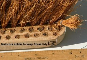

1st picture.... The broom, "getting the branches" :)
Errol

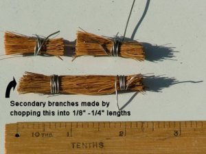

The branches
Having cut the fibres away from the broom head, you might find the full length of the fibres too long (mine would make 17 scale feet diameter trees).
As I prefer "scraggy" trees I cut the bundle in half.
Chopping a bundle of fibres into 1/8th or 1/4" lengths provides secondary branches.

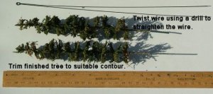

Preparing the wire
The chances are that once you cut lengths of wire they are anything but straight. Clamp one end in a vice and using a drill to twist the wire while pulling it firmly but not tight. This not only straightens the wire but also work hardens it slightly (which helps it keep it's straightness).
Bend the length of wire at it's halfway point ( use a screwdriver to form a loop at the bending point).
Clamp the loop end in a vice and slip the tape (with branches sealed on it) in between the two ends of the looped wire.
Use a drill to twist the wire until the all the branches are trapped in the wire.
You now have a bottlebrush and should trim the tree at this point (or wait till it's all finished and painted).

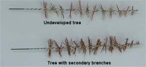

Applying secondary branches.
I find that matt Acryllic Lacquer is sticker than hair spray for this operation.
Spray the whole assembly till you see tiny globules of the lacquer on the branches and while it's still wet sprinkle the small cut secondary branches onto the assembly.
Don't get fussy about neatness as secondary branches stick to parts of the trunk. Real Pines have short branches around their trunks! Also .."leaves" will cover much of what you think is "overdone".
Errol

Adding colour and texture.
Spray the whole assembly with either the brown or green Acryllic Auto Spray Paint.
While it's wet roll the tree in a mound of Woodland scenics green turf ground foam.
After 10 minutes spray the tree with hairspray or Lacquer and roll it again in turf (perhaps of a lighter or darker shade than before).
Secure the new "leaves" with hairspray or lacquer.
Voila! you have the makings of tree, It just needs trimming to suit your idea of a tree.

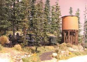

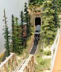

The general effect......
In 8 days I made 38 trees using the above method. Not all are perfect but the overal effect is pleasing to my way of thinking :D .
Here's a picture of the effect.
Errol

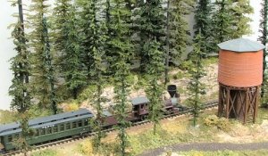

One more picture.
Thank you for the compliments gentlemen, (Strutting around with a big grin on my face now).
Dash, 20 brooms and a razor blade on their way to you! :p :D :D :D .
Shaygetz, one can of lacquer on its way. (geee, I'm good to you guys :D ).
Belge, If this thread get's your dad producing then it has served it's purpose.
I found the process to be quite theraputic.
Charlie, I have to work on my ground cover to get it like yours.
One more photo to get others started making trees:-
