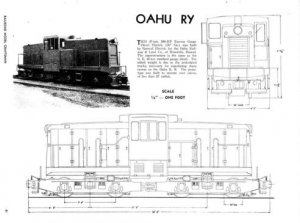

I'm currently in the process of actually acquiring the donor model for the project, so I can't start yet, but to get us started off for now here's the set of drawings we'll be working from:

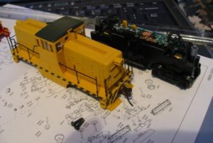

Well, the loco has arrived and I've started work today, here's a photo of some of the things you'll possibly need. A donor chassis/motor and wheels with gears, the spectrum GE 44 ton, and the plans for the components of the 44 ton.
Fresh out of the box, as is the donor chassis. I prefer using new donor chassis as they tend to have less problems to sort out than donors that have sat around for years.

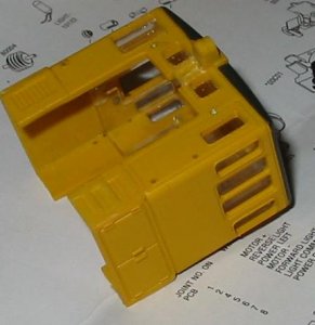

Next is removing the cab. The cab is handily a seperate part, so it can be removed without sawing. The cab is attached to the rest of the shell by four lugs, and removing it is easier said than done. First, you remove all the detail parts that might be damaged by handling the shell. You need three hands, and steel pinchers for fingers to remove the cab, but it can be done by pinching two of the lugs in while lifting that side of the cab out, then jamming a flathead screwdriver into the gap to keep it open, allowing you to do the lugs on the other side and lift the cab free.
With the cab seperate, you'll note that there's a little guy sat in the drivers seat, and an empty seat on the other side. These should be removed, and if you intend to use the driver again, I suggest repainting it, because it's not very well done.

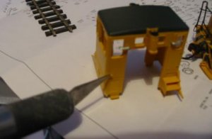

On the cab there are small steps which need to be removed to allow the cab to be lowered into the frame (the cab itself is not cut down, but we'll get to that later).
Simply saw off the majority of the steps, then wittle the rest down with a craft knife until it's smooth. Don't attempt to round out the edges to match the rest of the body, leave it as it is until the shell is reassmbled.

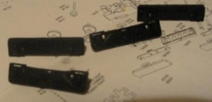

Next, the fuel tank side panels must be removed. This is easy, you just need to be careful to control the knife when whittling them down.

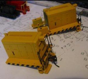

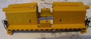

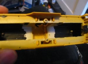

Now comes a bit of a scary bit... well, it seems scary just before you do it, but once you've done it you realise it's not that bad. You need to seperate the noses from the base of the cab, by cutting through the floor just behind the nose. I found the best way to do this was to line up the saw with the edges of the lug holes.
Once you've done that, clean up the edges, and remove the little rim on the end of the nose that was designed to get the nose to fit snugly inside the hole of the cab.

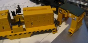

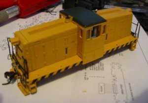

Now that the stacks have been modified on both sides, the noses can be reunited with the cab. This stage requires glue, and there is no way to avoid using glue here unfortunately, but it's not that bad.
Simply glue the nose to the cab, adding a spot of glue under the stack, lining the top of the nose up with the tops of the inner windows. Do the same for both sides.

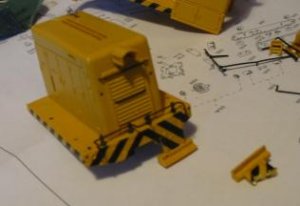

Next step, remove all the details from the front. You'll need to do this for ease of handling and prototype reasons.
With the details removed, you can now cut up the pilot. Remove the foot plate thingies, to match the profile pictured. I accidentally de-attached the nose which hadn't finished gluing yet, hence the unattachment.
Once the you've got the pilots modified, get rid of the lift bars and stanchions, saving them in a plastic bag or something for later. In the spectrum box, you should find a little detail bag with a pair of alternative headlamps - fit these. You will probably find that while removing the default ones, they'll break, If this happens, just cut away what's left behind, and the push it inside the nose from outside. It should just push in and out, leaving an open hole for you to push in the correct headlamps to match the prototype.

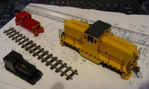

Next step, pick up the chassis and remove the truck sideframes, which will need to be used in the construction of the new chassis. The sideframes will need to be modified slightly to match the prototype, and as it is slightly difficult to describe what exactly to remove, refer to the photos.
Okay that's all for tonight, so far we've covered building a complete bodyshell. Tomorrow we'll cover scratchbuilding the toolboxes or whatever they are onto the shell, and working on scratchbuilding the chassis. I'll talk about different ways to approach motorisation, and if there's time tomorrow we'll also go into modifying the detail parts to match the prototype.
