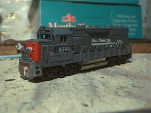

I can't help it I just had to see what it would take to power one of these.
For those that aren't familiar with the Hi-Speed GP-35, Here's a link to a description of it.
http://www.visi.com/~spookshow/gp28.html
Here's what it looks like so far.

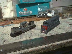

I dug up an old Atlas (GP30) frame and trucks and did some milling to narrow the Fuel tank area to fit the shell and also milled the chassis to accept a larger motor.
Then I cut the fuel tank off the Hi-Speed chassis and mounted it to the Atlas chassis.
I also cut the truck mounted couplers off.

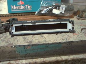

The center of the walkway section of the shell was cut out to accept the frame and strips of plastic were glued to the bottom as spacers and extra support.
I'm working on the pilot and coupler mounting now.
I plan to cut the hand railings off and bend up a set from wire.
This won't be the most detailed loco but it should look right at home with my first generation Atlas and Model Power locos.
