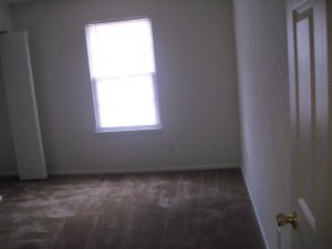

Suddenly, My cramped space has gone away: I have an entire bedroom to use, that needs NOTHING else but trains. The room is about 9x11. I can post pictures later.
My question: Should I Plan one full layout for the room, or stick with the smaller plans I've done before as modules connected together?

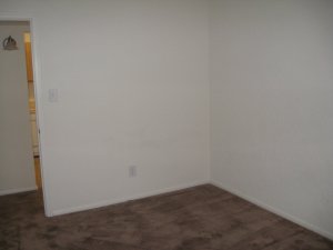

Attached are a couple pictures of the room, from the door and from an interior corner.
lights have to be added (No overhead light)

I agree - GO BIG! There's always some trade-offs with every layout...but you could plan the entire layout in smaller modules and build one at a time if you like and add them into the final "master plan" as you have the time/money/requirement.
Unless you make a really small layout, it would be difficult to use the room for something else at the same time. So, you sould go ahead and fill the room with one layout. You could build modules, but make sure you devise a standard so that they all fit together well. Making modules first and then deciding how to fit them together is problematic.
Actually, If I was in N-scale, I would consider building modules. You can make a pretty complete scene on a standard N-trak module, but in HO, a single modlue doesn't leave much room.

This leaves the other corner (the second picture) for a small HO layout that will always be July, 1976. (a small place to run my old Athearn Seaboard Coast Line #1776.
