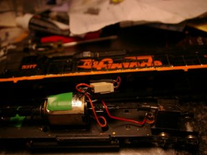

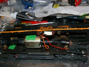

Here's an alternative way of wiring and fitting decoders - I use a plug and socket with standardised wiring for the decoder. The white block is a 4-way plug & socket but an 8-way one would deal with lighting. This is in an ALCO SD40T-2 model
If I want, or need, to run the loco in DC-only mode all I have to do is unplug the decoder and fit the jumper unit instead. (It also means that I can upgrade decoders relatively easily in the future.)
I think it would make more sense to buy a package of 8-pin plug/sockets (about $5 for 4). That way you can swap the decoder into other units (if need be) and you have a nice, tidy harness to the loco.

And yes, I suppose it would, but this loco is one of the ancient Athearns, plus it has 2 motors (so don't go yelling at me about the DH123AT drop-in decoder lol), so I had to come up with something else...the system doesn't work, it won't fit into the shell in "DC mode." I'm just going to have to make it run DCC-only lol...
