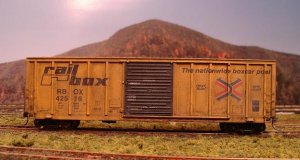

Ok ,we were trying to come up with new ideas to get the membership motivated to post more on the Gauge.One idea I came up with was a freight car of the week thread.
First we are going to do this by type of car.This can be in any scale from Z to prototype. The only rule here is that the pic is yours or was taken for you.
Since this was my idea I am going to start it with a boxcar.You can post on a daily basis but please only one pic a day.
I like this nasty old Railbox car cause I did it all to it.:D

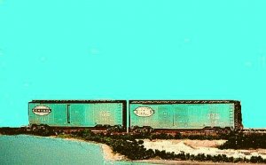

There are legendary stories of the Penn Central losing a box car for months. In that vein here are a couple of lost former NYC 50 footers in the middle of nowhere. hope some one finds them soon!

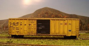

Brand new ATLAS Trainman HO scale Railbox boxcar (of course)
I think ATLAS has a real winner with the Trainman series.Looking forward to the N scale cars and locos.:D

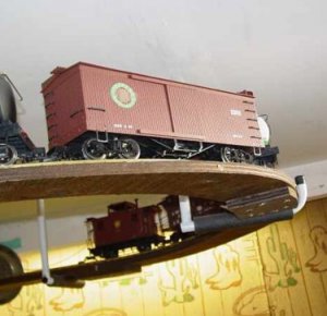

Catt, since we can post one freight car a day on this thread, should the name be changed to "freightcar of the day"?, and just keep the thread going? just a thought;) . :D -Deano View attachment 29415

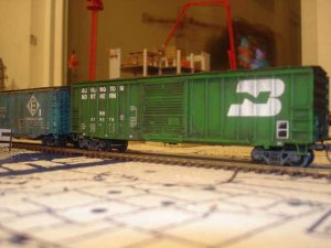

Wayne, nice shot of what sounds like a fun project.
Tom, cool boxcar!
to everyone, are you running metal wheels to weather them so nicely, or are these still plastic wheels? I've been thinking about switching over to metal wheels, to lower the rolling resistance
