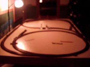

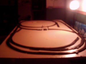

Here goes I will attempt to load my photos the quality isn't great but I think you'll get the idea.

Lisap: what brand of track and switches are you using? Do the switches have plastic frogs? (I suspect they do.) That could make a difference to what we suggest.
On the reversing loop, a single reverse loop means that half the time you have to back the train through the loop and this creates problems. How commited are you to the track plan?
I am using atlas snap track(mostly used) and I am willing to start fresh with my layout if it would be easier( which I am thinking might be the case) My biggest problem is I have checked out various track plans but I don't have all the track pieces I need for them. The main thing I need is a place for my crossing(preferably in the middle). My boys would like their own "towns" on either end of the track but other than that I am flexable.
:D Ok here's where I'm at, I decieded to do away with the reversing loop and made two seperate loops one on each end. Only one "town has the crosssing but i gave up trying to fit the crossing for both, thus eliminating the need to reverse the track. :confused: The question I have now is how to isolate the two sections so that both trains can run on the main rail(the large outer track) but still be on separate controls (I have more than one transformer).
