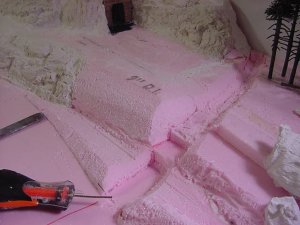

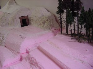

I am working on several NTrak modules and I would like to have an animated waterfall. I know you have all seen the lighted pictures of Niagra Falls in shopping malls, the one where it looks like the water is flowing in the picture. Is something like that possible on a module? Tried several revolving drum ideas with a light inside it but it did not give the illusion of flowing water. Anyone have any ideas. Here is the area that I want to place it.

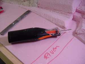

When the kids were done with their pumkin carving I asked for their battery operated saw. Wow! real sweet for cutting and shaping foam.

I would have just suggested to build the water fall as you normally would, but maybe over a tinted plastic, with led's and a rotating light behind it, but it sounds like you already tried something like that

The light seems to be the key, has to be bright with no hot spots and since it will be confined in the foam there cannot be too much heat. A Club member suggested fibre optics, I have plenty of that laying around, so I guess I will make a mock-up and try that next.

Saw an MR article some years ago that tackled this very thing very well. Where you want it to cascade over, cut open the foam and paint it black. Place a piece of clear plastic/acrylic/lexan over the opening and run clear silicone caulking over it, sculpting it to appear to fall over the edge. Don't do it too thick, you still want the transparency of it. Behind the falls you place a "curtain" of Christmas foil icicles the same width as your falls and a bit longer than them. By shining a low wattage light onto the icicles and moving them gently with a small fan (like those that now come in Glade Air Fresheners) you get a rather interesting effect of falling water.
