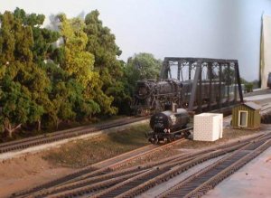

I'm hoping someone can point me to some photos of smalltime tankcar unloading. I'm working on a scene where I envision a tankcar of fuel oil is spotted and used to fuel a diesel switcher in a small but busy yard serving an industrial area and interchange. I started building a cinderblock structure to house a pump and it wasn't till I placed some of the elements that I noticed the tank car appears to be unloaded from the top, not the bottom, is that correct? I could really use some proto photos if anyone can point me in the right direction. I've attached a photo of progress so far.

Gary, I'm sure the dome at the top of the car is for expansion of the contents due to temperature change and the fittings there are for filling and venting the car. It is unloaded with help of gravity at the bottom through fittings for connecting hoses to. Nice picture and good luck with your project. Keep us posted.

I'm not sure about way back when, but a tank car is almost always, as in 99.9% of the time, pressure fueled from the bottom, and gravity de-fueled, when hauling diesel or unleaded gasoline. They're very easy to dump, and usually have some sort of valve, and a cam lock hose fitting. It would not take that much effort to reduce the size of the hose down to a 2" or even 1" and stick a normal gas station nozzle on the end. I see it done on fuel trucks now, at work.
Fuel is not that forgiving of an item to open load at the top. Most domes are just expansion holes, though usually do have a hatch that can be opened, it would not be safe to monitor the fuel level while loading it that way.
