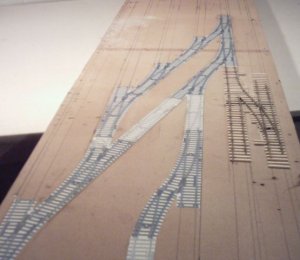

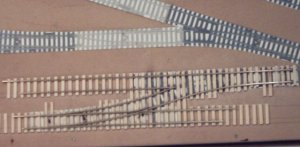

I have a start on laying track by hand myself. After looking at tons of stuff on the net, I decided to build a switching yard with 11 turnouts. I learned that the best thing to do is build the turnouts in place. The best way is to scratch build the track pieces as you go. I read that the problem with a jig is that it limits you to one kind of turnout, where as, if you learn to build them from scratch, then you can build the turnout to fit the track plan as needed.
I'm working in HO so I'm not familiar with any problems that may the extra smallness might have, but from what I heard, it's the same.
I also heard that to ballast the ties before laying the track is a good idea, but that's not what I'm doing. I'm using an old note board for my base as it is covered with cork and has a fibrous backing that accepts the spikes good. I drill holes in my ties for the spikes so the spikes don't split the ties. I'm making the ties and the spikes myself and using old brass sectional track for the rail supply.
I made a photo copy of a turnout and made copies that I cut out and glued to the base so I can have them as a guide.
Here is the work I got done so far.

Looking good TC! In the documentation I linked to, they also talk about ballasting the ties prior to laying the rails. I don't recall that they gave any reason why though, and I only see problems with the idea. (Spoken with absolutely zero experience in the field.)
