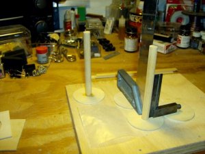

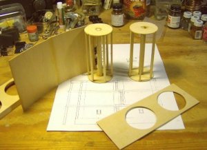

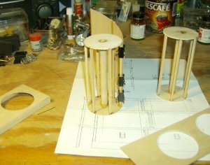

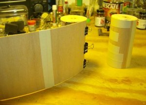

The pictures that follow are of the coal holding tanks as they are being assembled, and a picture of one finished and the other about to be "skinned". Note how I use squares to keep everything lined up so the skins will wrap around evenly and not skew as they are wrapped around the tank structure. Also, I use every sanding aid known to man...The secret to building a structure like this is to cut the pieces to a close approximate size, and then sand them to the exact size required. This will insure that everything fits nice and square.

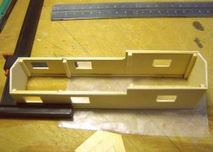

In the first batch of pics, you can see off to the left side of one, the assembly of what will be the base of the tanks and where the legs of the upper structure will rest.

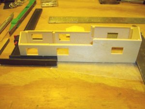

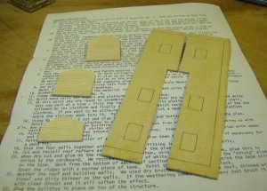

This set is of the upper structure...

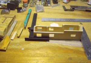

The first pic is of the pieces as they need to be cut out. The other three that follow are of the structure being assembled. Here again I sand everything to the right dimension, and using squares I assemble the four walls. After this step, I will start staining all the pieces so the structure will be almost finished when everything is assembled.

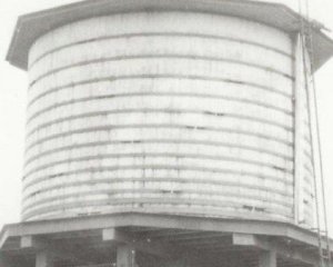

Most wooden and concrete staved silos that I've seen used flatbar bands and not round bar. I'm not saying that rods weren't used, but the flatbar would help spread the load over a larger area, where the rod would dig in. Good or bad? I don't know. I think Campbell might have gone the fishing string route so they could use thier already available turnbuckles for thier water tank kits. I guess.:confused:
I'd use thin styrene strips just for ease. Glue some short (6" scale inches) round styrene to simulate tightening bolts and you should be fine. Just remember to step the bolt assemblies.
