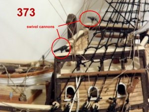

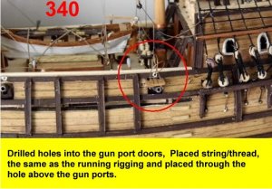

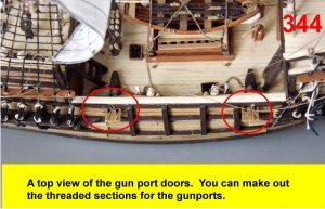

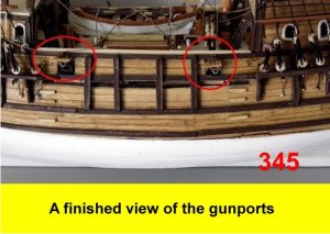

The galleon is almost coming to an end. It should have been finished over a year ago but it was so detail intensive that I lost the urge for a while. Here are a few updates on the ship, the gun ports. The stand came out great and she looks mighty proud in her display stand but those photos will come later. Enjoy and see you soon with more updates.

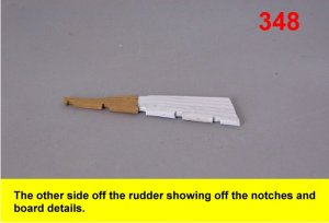

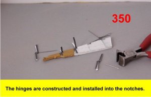

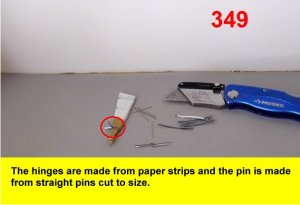

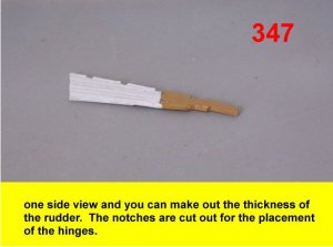

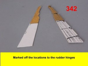

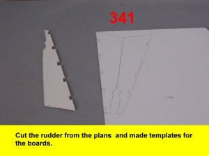

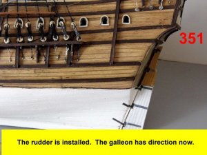

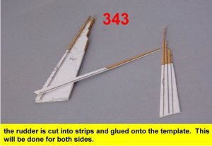

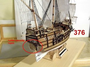

With this update, I will show the build of the rudder. It has a laminated center and the outside templates are cut into strips and glued to the inner center, sort of like a sandwich. The hinges are made from cardstock thin strips and using cut straight pins as the hinge pins. The rudder template is from the plans sheet and it seemed a bit to narrow to steer the ship. This maybe one of the reasons that the galleys were a bit cumbersome and slow in their steering capabilities. Added to the small rudder, the galleys were too fat in their bellies and had too much water contact to allow for a smooth flow and get speed to get away from privateers. Enjoy the show and the end is coming soon. See you all soon with more updates and small details.

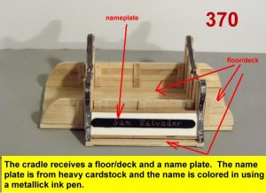

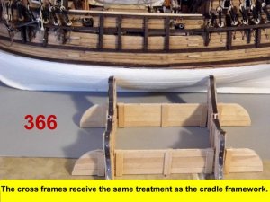

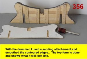

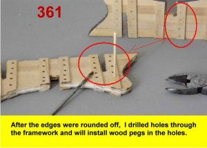

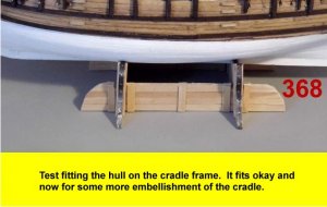

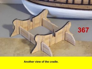

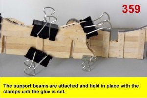

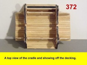

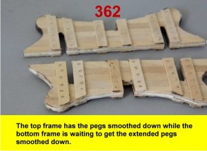

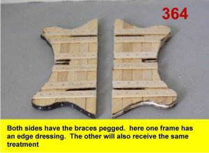

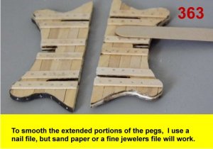

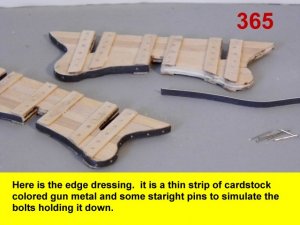

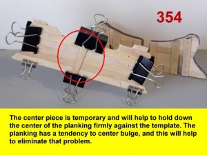

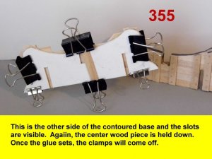

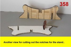

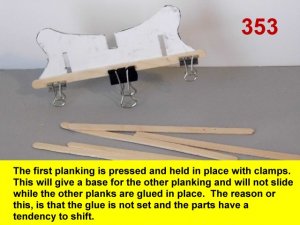

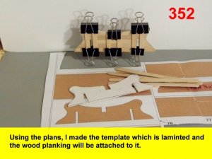

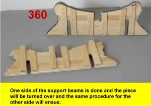

More updates on the build. this session, is on the display base. I was planning on a full ship length base but opted for the smaller cradle. I used the template from the printed plans as a base and used coffee stirrers to plank the stand.
The small cradle base can also be attached to a longer wood base. It fits good and I did not add a felt strip to the contact edges or to the bottom of the base. I will probably do that sometime in the future but for now it will stand as is. This session is divided in two portions. This split is due to one of my sites will only allow ten photos per upload and this will keep me straight as to what I post on each site. See you soon with part two.
even the stand is a work of art
Thanks, I believe this version is better than the original cradle. The planking could have been done with laminated cardstock but again, I opted for the real feel of wood.

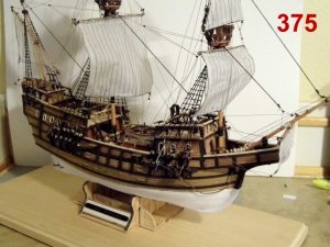

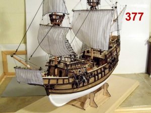

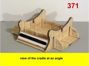

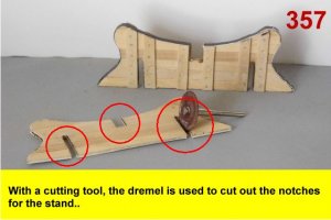

Here is the second portion of the base. I believe it stands out a bit better than the original. As mentioned earlier, my first option, was to make a long base, but this small cradle can also be attached centered on a larger wood base. The next installments, will be on the finished ship. Until then, see you all soon.

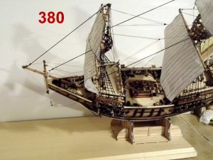

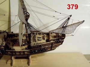

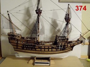

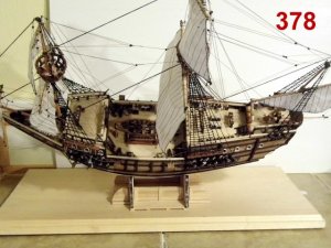

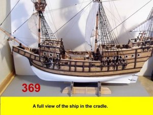

And so, another thread comes to an end. I will not say that it was fun all of the time but the effort of building it was worth all the while. Hopefully, all of you who have looked in now and then enjoyed the show. here are some final photos of the Galleon, it could use some more small details but I believe that I will stop here and move on to the next subject. It will be the small Steampunk tracked vehicle. Enjoy and see you all in the next forum.
