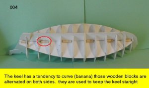

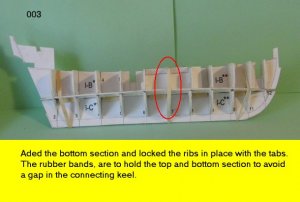

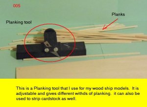

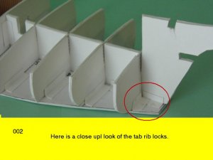

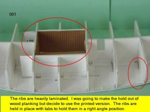

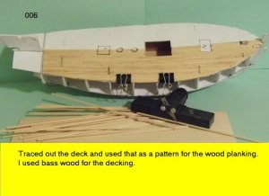

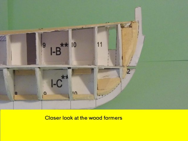

Continuing with another build, I hope to have it finished by the Holidays. My initial finish date was for Thanksgiving but I do not believe I can accomplish that. This model will be a mixture of cardstock and wood. The decking is almost finished and the rib sections are heavily laminated to almost the same thickness as a wooden model. The hull will be a mixture of wood planking over a cardstock hull. There is some slight fit problems with the ribs but they are easy to overcome. I will treat this build like a wood model from Artesania Latina. Here are the first photos

I got them Zathros. I will probably not use them on this build The original plans will be used as the first planking and I will place individual planks over the printed plans.

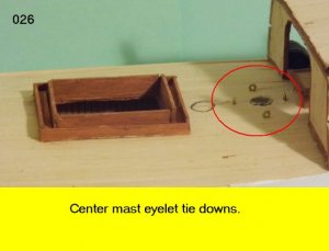

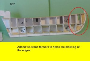

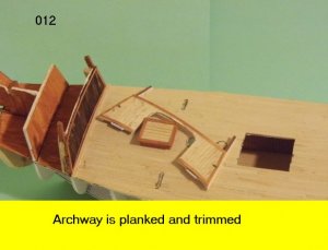

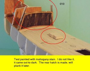

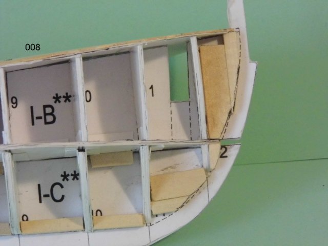

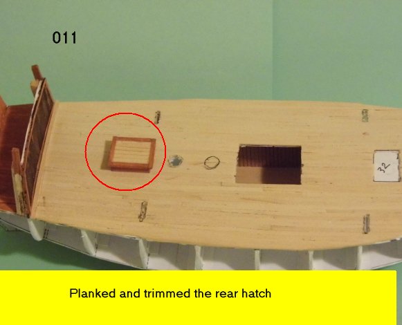

Here is the next installment of photos on the build. The model is at a standstill for the moment. Ran into a blank wall in getting more details information. I want to add a few more details but info on the San Salvador seems limited. This model has only four gunports and Galeons of that era had more armaments, to include swivel cannons. The wall attachments for the cannons and gear storage above deck is missing on the plans. I want to add supplies into the upper cabin areas and because of that, I cannot close the upper areas. It will be hard to place those items there after the sides are up. Also missing is the life boat/dinghy storage rack. Enjoy and see you all next posting.

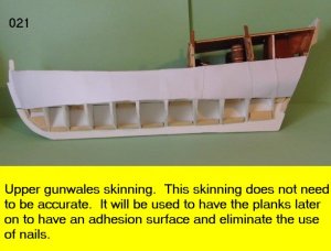

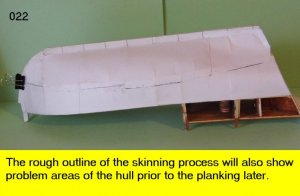

I know what you mean about too much to do and so little time. When you build this model as is. I recommend to make a skin over the hull with cardstock. This type of under skin will bring out errors in the ribbing and you can adjust before you place the printed planking.

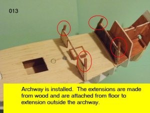

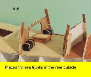

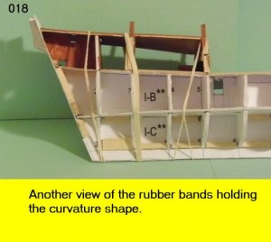

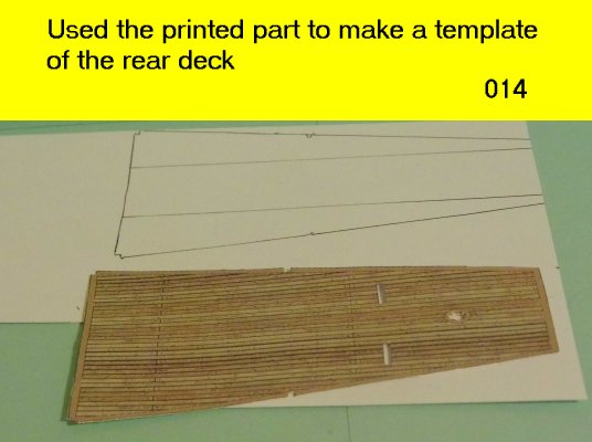

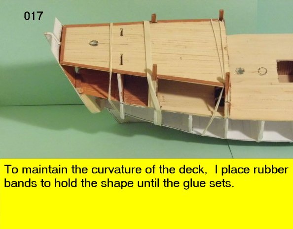

So here are a few photo updates on the build.

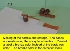

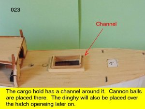

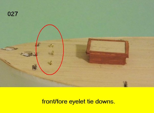

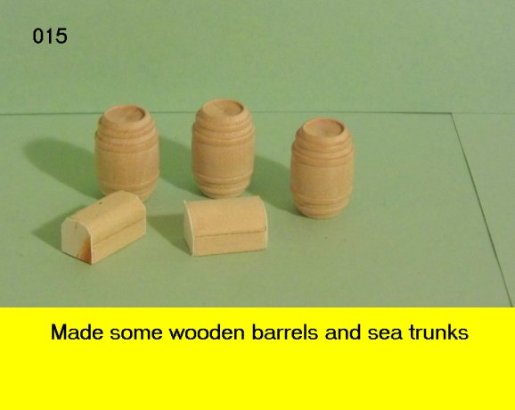

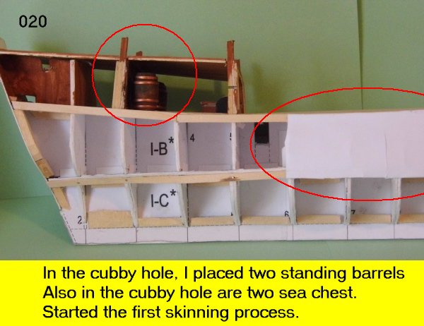

As for the San Salvador, I am gathering as much deck information that I can, before I start to close it up and have a hard time later to add in the details. I have a gathered a lot of references from other galeons that may be of use for this model. I am also gathering some tips and trick for the making of small details for ship building, which I will post along with the build process. Here are some photo updates of the build. At the moment I am at a standstill while visiting family for Turkey day (Thanksgiving) but I have a few more pics to show.

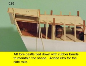

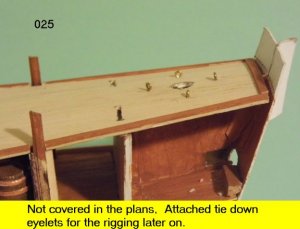

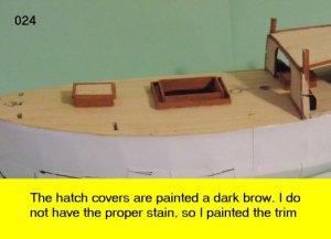

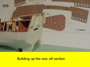

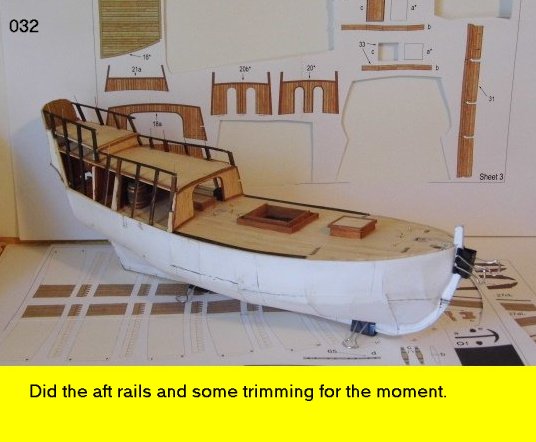

Back with some update photos. It will be slow for a while, until the holidays are done. I was trying to finish by Christmas, but because of the details, it is going to be done next year. Before I start the planking, I have to fix some of the rib problems, which thankfully are minimal. I am getting my parts ready to make some jigs and things at the same time. Here are the photos and enjoy. See you all next posting.

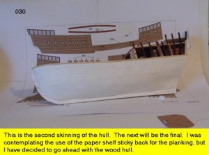

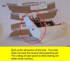

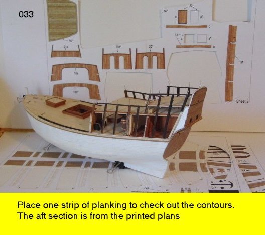

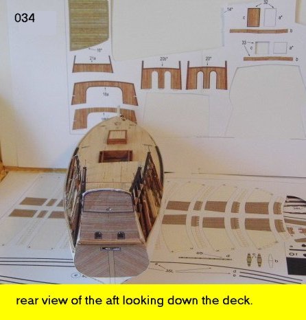

Thanks for clearing up the origin of the ship Haereticus. I just could not place it. Here are some more update photos for your enjoyment.:wave:

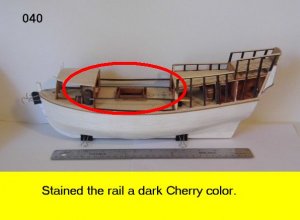

Thanks Pape. I got a stain that approximates the color of the printed plans, that is why I am going for the wood planking. It is tedious but I am moving along, but not as fast as I usually do. Most of my models are finished in about a month or less but wood models have a tendency to slow you down. The culprit is the research, the details and the glue has to set before you move along to the next steps. Enjoy ans see you all soon with the next posting.:wave:
San Salvador

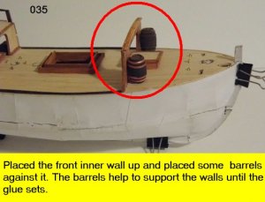

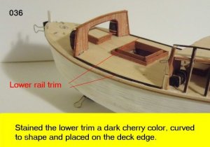

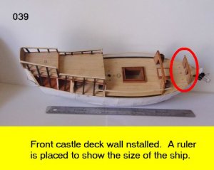

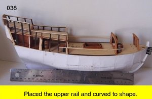

Here is the next installment on the build. The wood and paper medium seems to complement each other and makes for a good mix. As of the moment, it is still slow going but I am pleased with the results. Enjoy and see you all next posting.:wave:
