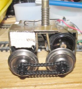

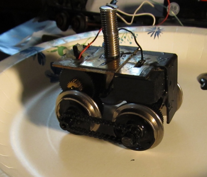

I got the goose drive set up with some miniature chain and sprockets to power the back axle off of the front one like the prototype. The first time I had it set up I had a feedback problems with the chain. the prototype didn't have that problem, as the took out the spider gears in the rear axle's differential so the right t and left rear axle were not connected directly to each other mechanically. I modified one of the sprockets on the rear axle to freewheel, so the chain turns on that side, but the whole axle is powered from the other side, and there is no feedback bind.
Next I can start putting it together and start shopping for RC stuff.

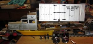

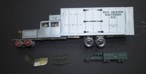

more goose parts

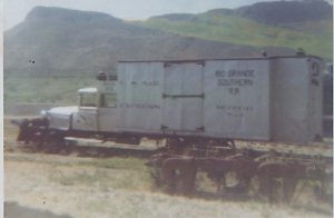

I have doug up some of the scratchbuilt brass parts for this critter, and I found a bad photograph of the prototype, that I own the copyright to, and can safely post,
the goose is assembled the wire leads are for testing the power truck, which will get RC some day. shown for reference is a HOn3 3 truck goose.

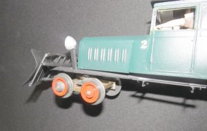

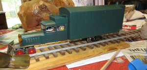

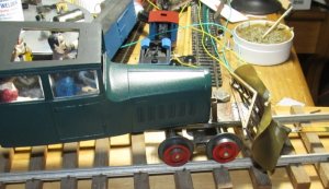

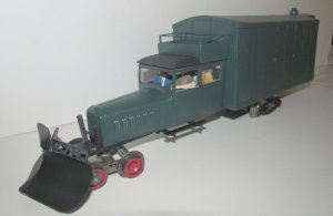

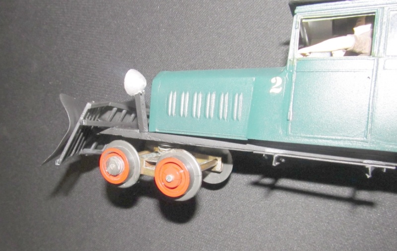

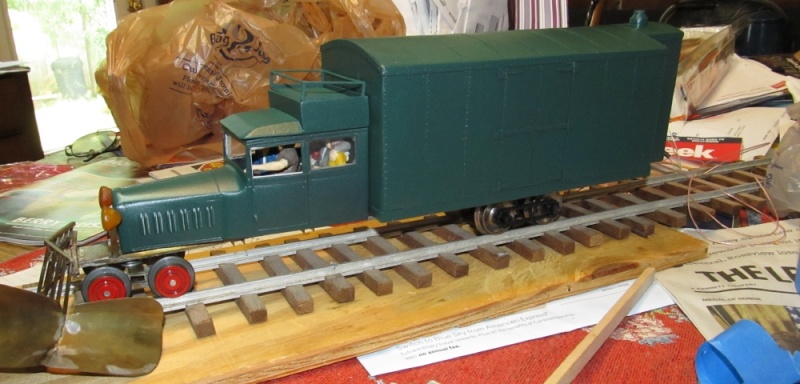

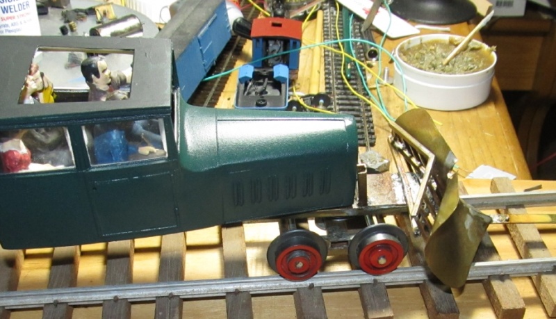

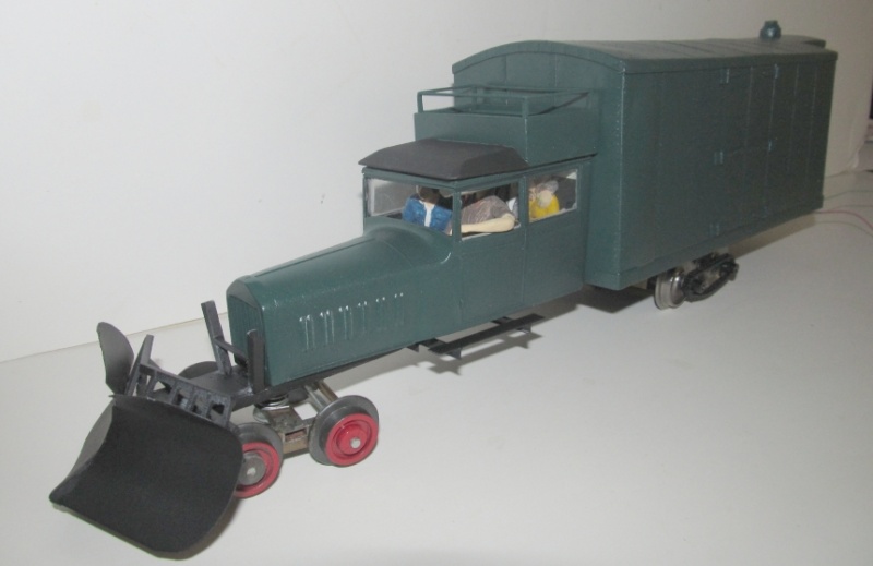

The goose has been painted green , for my private 3 foot road had it's cowcatcher and snowplow soldered on and painted, now it is ready for lettering for the state line railroad.
Now I need to start shopping for a radio and battery for it to get it ready to roll

That truck/train, is absolutely amazing!! The chain drive on the outside would facilitate east maintenance. Really cool, almost post apocalyptic, it's something that one might expect to see in a "Road Warrior" genre movie. :)
The first axle was powered by a standard automotive rear end, of the drive shaft in the traditional manner, so the problem the guys in the shop had was how to power the second axle. thier junkyard solution was to mout sprockets on the wheels, remove the spider gears from the second differential, and run chains from the forward wheels to the rear wheels to power them.
All the models of geese I have seen have dummy chains. Mine is the only one I have seen with working chains.
I have some yellow dry transfers, so I can start lettering it for the State line Railroad. The other G scale equipment I have that is lettered is lettered for the Harlow Cove Coal and Lumber Co. A goose looks to me to be something that better suits a real railroad (although a chintzy one), so I'm lettering it for the State Line Railroad, whose main operations are in HON3, mainly because I really like the look of my HOn3 goose kitbash progect, a 3 truck Pierce arrow bodied goose (in later life some of the pierce arrow bodies got so broke down they were rebuilt with Wayne buss bodies, still very strange animals, but not as appealing to my eye.
Soon I will be shopping for a 6 or 8 channel radio control system to control this project and a Bachman Ten wheeler, and two model boats I have been working on for years and years.

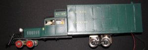

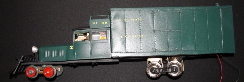

Lettering the Goose.
I got some Woodlands Scenics dry transfers and started to letter the goose. The last couple times I have used them I have had old ones that had degraded some, and it was a joy working with the new ones.
Once upon a time I had my old ones stored in my RR room, which is in the attic of a metal roofed structure. my RR room geets ho, I need to store my dry transfers in my downstairs work area, or my garage, where they won't be exposed to the heat, which after a while will make them want to stick to the backing sheet, instead of transferring to the model.
I have the letters and numbers done on the cab section, and the U S MAIL EXPRESS on the front ends of the freight body sides. I still have to do a STATELINE RAILROAD MOTOR #2 on the rear end of the freight body sides, and a 2 on the rear extension, that was added on to hold a stove to keep the mail from freezing.
the second photo shows the details on the back side of the scratchbuilt brass cow catcher and snowplow. these are some of the best brass scratchbuilding I have done. in the first photo the wrinkles in the thin styrene that had the nail heads embossed in them, and then were bonded on the thicker structural shell. The wrinkles were not intentional, but the prototype had wrinkles, so they are welcome details.
Soon I will have the lettering done I need to paint the front truck (the red wheels really have to go) and I need to get the structural parts of the power truck painted so they don't stand out like a sore thumb. Then when I get brave enough, I have to start ordering radio equipment, and hope I don't **** up too badly as I have the goose, a bachman G scale 10 wheeler, and two model boats, a Roman Bireme, and a 1860's side wheel ocean going steamer I want to put receivers In, I need to get the right transmitter.
Bill Nelson
  • SMLA-1 gs #2 ltrs 1:2done.jpg

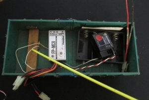

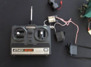

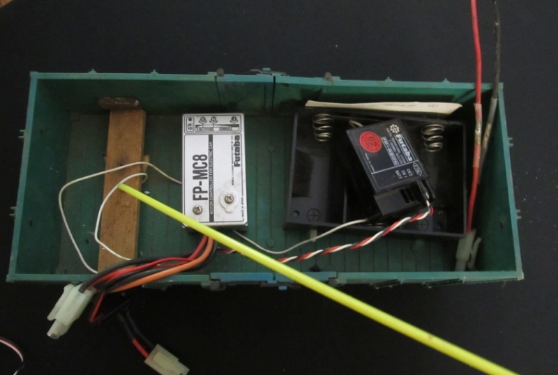

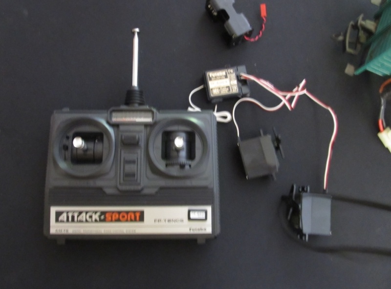

I was hunting for something in the garage, and found a box with some stuff from my Dad's old RR. Most of it was junk, but there was a 2 channel radio in there. I had one 2 channel radio, but hadn't been tempted to use it as it had a lot of corrosion in the battery area of the transmitter.
I had a radio car Dad had set up the throttle control uses a different style of plug for the receiver, so I need to splice on a different plug . I have tested the radio and it works, so when I get a compatible plug spiced on. I can start putting this stuff in the goose.
I have all the pieces except for the battery power for the motor in hand , so I can start to mount these peices, and look for a battery. I also need to look for another receiver on the same frequency, as I could use that , hooked up to another channel to run a throttle control for my Bachman G scale 10 wheeler, and run it and the goose off the same transmitter. I have a RPO car and a combine, so if I could get all that stuff rolling at once I could move a lot of mail in Tom's back yard

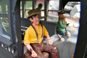

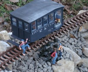

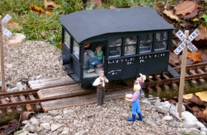

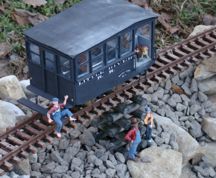

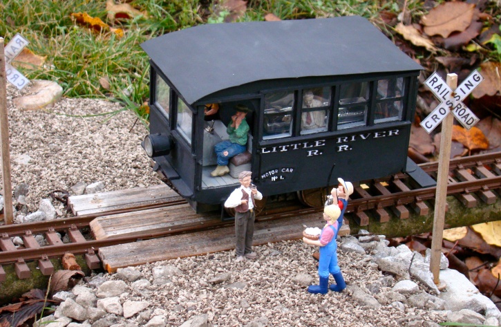

My boys definitely need help moving the mail. Not much will fit in the Little River Motor Car #1.
In the pictures below you might be able to see the Radio Shack battery holder with 8 1.2 volt rechargeable AA batteries. It provides 9.6 volts of juice which has worked well. This was a pretty cheap set up, under $50 including the battery charger.
Unfortunately I will miss RR club tomorrow because of a Church Haiti meeting.
Tom
Tom

Tom, I have seen battery holder like that in fact that is what powers the goose's receiver. It would be as simple as pie to add another to power the motor.

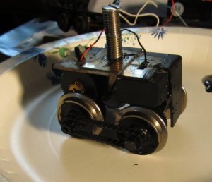

I have the goose all apart to work on gear placement Once I know where everything goes, I will need to drill and cut some holes in the frame for the transmitter's on off switch, and the motor power on and off switch. after that gets done, then I will add some more paint to the frame. I'm thinking the frame might get just a touch of red auto body primer misted in for that slightly rusty look. I think that would look good, especially at the base of the snowplow.
while I had the goose out I did some hand painting n the power truck. using some black paint to cover some brass and some balsa wood that stood out. I also painted the sides of the drive wheels black, as all that shiny nickel silver stood out too much. I didn't have power hooked up to the wheel, so I couldn't roll the wheel, so the paint job is a little uneven, but I can come in later and touch it up easily.
also today I protected what letting I have done with some dull coat. the Dull coat fogged up the windows of the cab, but I was able to use some rubbing alcohol on a Q tip to remove the dullcoat off the "Glass". The dull coat helped the look of the Krylon Hunter green. I will have to get another can, so I can disassemble the Delton Combine and RPO car someday, and cover up the Colorado Southern paint scheme in favor of a STATE LINE approved paint scheme.
