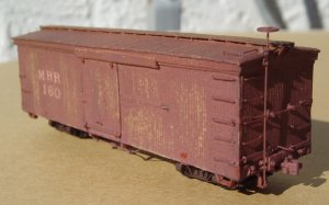

Many "cheapie" freight cars can be upgraded, using either commercially available detail parts or scratchbuilt alternatives. In my opinion, even many of those expensive models, either kits or r-t-r, can benefit from some similar upgrades, too. While lots of my freight cars were bought many years ago, many of these same cars are still available, especially as "used" items, where they're even cheaper.

I was lucky to pick up a dozen or so of these Walthers 50' boxcars at my LHS for about $6.00 each - 3 or 4 were lettered for various roads, while the rest were undecorated. I added wire steps and grabirons to all, along with some basic brake gear, then lettered the undecs for my own free-lance road, and weathered all. Not counting the custom lettering, about an additional $1.50 for Kadees and wire, per car:
I got a bunch of these Train Miniature cars for about $2.00 each (used), then spent about double that per car to upgrade them with new ends, reworked doors, steps, grabirons, brake gear, and Kadees.
I have dozens of these Train Miniature (now Walthers) ARA boxcars. Their low roofline adds prototypical interest to any train from the 1920s into the early '70s, and they can be had for next-to-nothing: I recently bought 3 or 4 kits, unmade, from the LHS, for about $4.00 each. I thin (using an autobody file) or replace the roofwalks, rework the doors and doortracks, and add metal steps and grabirons. Some get new brake gear and all get new paint and lettering. Dollar-wise, the most costly upgrade is a pair of Kadees, and the lettering:

In short, you can build a reasonable roster of cars for your chosen era at a reasonable cost. You do need to know what's available and to also know what you want to replicate - making a doubledoor car from a singledoor version is an example. The level of detail is up to the individual, and while there are many detail parts available, each modeller's skill will determine if you need to buy or fabricate that particular detail, or perhaps eliminate it from your requirements altogether. Prototype photos are a definite help (and for me, a good source of inspiration). While several of my cars are very good representations of their prototypes, most are merely stand-ins - "good enough" to suit my standards, budget, skills, and time constraints. I generally prefer to invest more time and skill than money, so it helps to know where to look for bargains, too. I have many "gems" that my wife found at garage sales, usually for less than $.25. :thumb:
