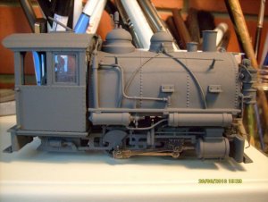

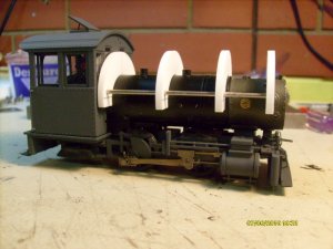

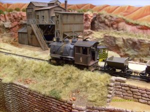

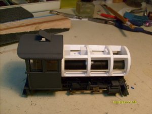

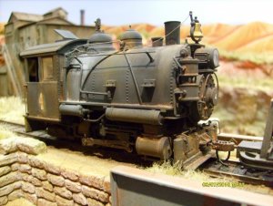

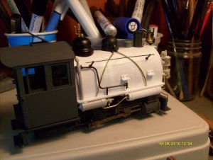

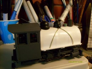

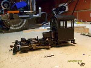

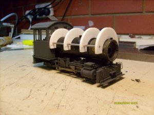

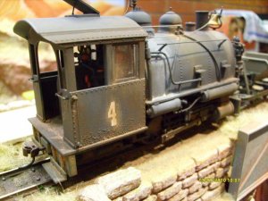

Hi all :thumb::thumb:
My Forney would'nt play nicely on the very tight radius on my mining
layout, infact it refused to stay on the track at the best of times. wall1
So it was sent back to Baldwin with instructions to turn it into a decent
Mining Loco.
After some serious chop chop surgery in the Baldwin Shops it was returned
to Sludge Pit Minerals as an 040 Saddle Tank. :twisted::twisted:
:wave::wave: Joe.

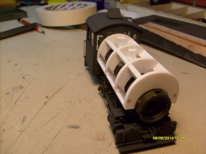

More Piccies: :thumb::thumb:

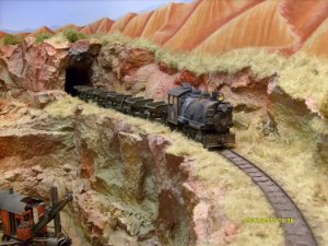

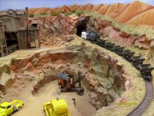

And some more: sign1
Happy to report the loco will now handle the tight radius track.
:wave::wave: Joe.

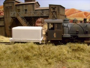

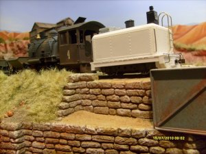

:thumb:Wow. That is a very nice looking locomotive. I am impressed!!! I would like to do the same in the future for my Haiti Sugar Hauler.
The forney is a sweet runner and in a short wheel base form like yours is a fantastic adaptation!!!
Thanks for the piccies Mate.
Dr Tom:thumb::thumb::thumb::thumb:

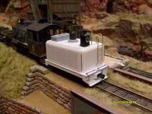

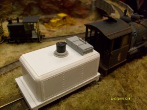

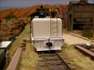

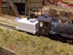

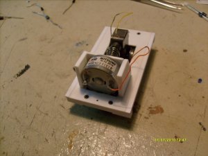

Hi Guys, thanks for the positive comments. :thumb::thumb:

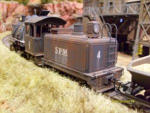

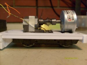

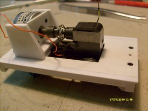

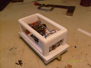

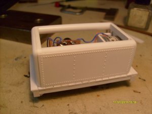

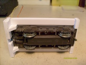

I'm actually in the middle of building a motorized Tender for this Loco
due to some very cruel grades on the layout up towards the top Tunnel.
I have loaded the Loco Saddle Tank with steel balls set in epoxy to add
plenty of weight but the wheels still slip when pulling a train.
I think the Bachmann Wheels are made of some kind of slippery steel.
Has anyone else noticed this :confused::confused::confused:
The Tender is not finished yet but runs very nicely.
Had to slow it down with a diode bank to match the Loco speed.
I'll post more Piccies when it's finished.
:twisted::twisted: Joe.

The tender looks great and will add a tremendous amount of "pull power".
A product "Bullfrog Snot" http://www.bullfrogsnot.com/ has been discussed as the answer to slipping wheels by local modelers. While it has a gross name it might actually work. While much talked about in our own "bull" sessions I have never seen said snot applied to any local yokel's engines.
Keep up the good work.
Doc Tom:thumb:

Seriously though, the motorized tender does the trick with the steep grades.
I have installed some steel weights into it as well.
Makes the Loco look meaner too.
Cheers, Joe.:thumb:

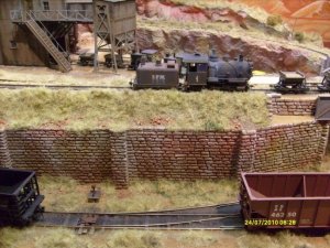

A buddy of mine has that forney. its terrible stock in the curves, totally unsuited for tight radius.
Tender looks superb! Is the stone work scratchbuild or is it from New england brownstone?
All around great scene:thumb:
Philip

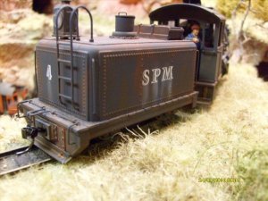

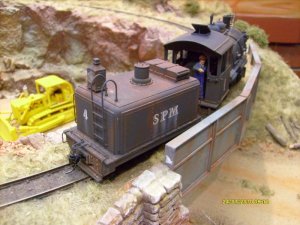

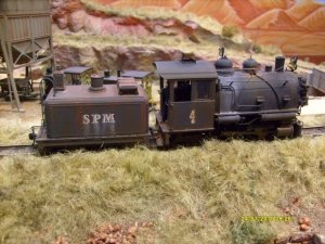

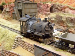

Hi all, :wave::wave:
Loco and Tender are all done. Tender is connected permanently
and wired in parallel to the Loco making it more or less a 0-4-4-0.
Very powerful and heavy. :mrgreen::cool:
Check the piccies and let me know what you think.
:wave::wave: Joe.

That is a very nice and neatly done lokie. I am sure many On30 modelers would love to see what you have done.
Doc Tom:thumb:
