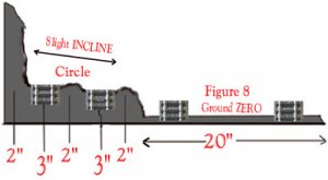

OK...heres what I want to do..........
the 3" spaces are for the ONE (upper) track...oval or circle...
which I will need a slight incline before coming around to the 2nd level
simple.......this will be my second train set anyways.
**My main track will below which will take most of my table up
strictly on ground level.
something like this.....
All I am worried about is the TURNS (radius) on both!!!!!!!
will they work?
If I understand that cut-through diagram, you're right-hand two tracks (on ground zero) are the two sides of a loop, right? If so, leaving about 18" centre to centre on those tracks, a curve radius of 9'', which is super-tight. I mean tight. Small locos will work, many won't, and all will look silly. Your entire 36'' width you started with was lots, but that 20'' you're effectively left with is not enough. Can you get the return track right at the back, behind the backboard? The backboard doesn't have to be at the back, remember? I have an 8x4' layout but have four tracks on each of two levels behind the backboard where the trains run around and for staging.

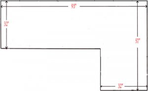

My "L" shape layout....
so a good miminum radius with Atlas cars (engine + 5 = 6max)...is...???

so IF it is.....why I am having trouble with getting 2 tracks with a half decent radius? .....(my depths being 32" in size)
No need to learn any programs basicly you just have to get your radius's on the track calmed down a bit to where it'll work. You may in fact have to get some flex track and prop it in place and try it to see how it looks in real life. Pictures and drawing don't always do justice.:wave:

LOL if you take a look at my plan you will see it is also very similar that why there called Dogbones , and are :wave:very popular . Most dog bone plans start off the same way with the main line then adding a passiing then off the passing siding is the rail leading into the industrial spurs. After all rule #1 is Thou Shalt Not Fowl The Main Line sign1
