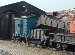

Oh, yes, the transfer caboose...now works my MOW train with my 250 ton crane.:thumb:
