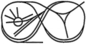

If you want to run larger equipment, you need bigger radius curves. In that case, taking a 4x8 plan and redrawing it with 22" radius curves would be about the best you can do. Here's one of my favorite 4x8 plans which has both continuous run and point-to-point branch line action. It's called Plywood Summit Lines (Atlas plan #36).
As I said, you would need to redraw this using software such as Atlas RTS (free download). Or, build your table and lay it out full size with actual track on the table. Then cookie cutter the raised sections of the table. The other option is to live with the 18" radius curves and add 9" worth of straight on each side to various tracks. The last has the advantage of moving track away from the table edges.
