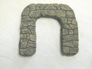

Inspired by Caseys stone wall..and my cubemates experience with same inspriation....I finally took the plunge and attempted some stonework!! I need a tunnel portal for a diorama I'm working on, so I tried that.
I used a corrugated cardboard cutout that I used on the diorama and wrapped crinkled then flattened heavy duty aluminum foil around it and just kind bent up the 'sides'.
I mixed up some lightweight hydrocal, which ended up being damn near set (VERY thick) cause the bowl and fork I used had a little bit left on it from another batch...it's true what I read about 'dirty utensils' thickening the mixture, and had to push it into the mold.
I was able to peel away the foil mold after about 5 minutes and start 'carving' with a finish nail. Then I played with WS pigments thinned to a wash. I ended up 'wiping' the surface cause it was too dark and uniform in shade.
Doesn't look bad huh?? The best part is I finally got my hands busy actually making something instead of looking at other peoples work!!:D Thanks to everyone for the inspiration provided by this forum!!

Excellent tunnel portal!!
The darker mortar lines really worked well :)

That looks great! Nice job. I've had success with using foil as the mold too. In case you had problems getting the foil off I found that pre-spraying the foil mold with cooking spray worked for me. Very nice effect you've achieved with the dark lines.
Ralph
Thanks Casey, I used WS Stone Gray in various thinnesses (is that word?lol) I just kept playing with the mix and finally, lol when it got too dark, tried wiping it which really gave me what I was looking for.
Thanks Val....it did work well but....see on the right where I crushed the wrinkles a bit? Lost some texture there, gotta watch that ;)
Thanks Ralph..I didn't have any problem peeling the foil away, but I did peel it off while the hydrocal was still rather damp. I used spray olive oil, sprayed then wiped, on rubber rock molds. That worked good and didn't seem to repel waterbased paint wash.
It was FUN!! This could be addicting..but most of you know that already...lol
