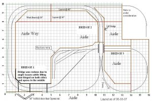

Anyway here is an updated first level schematic:

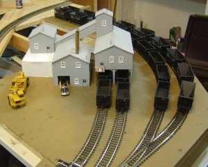

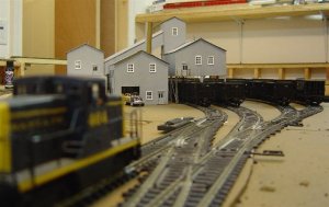

I've added the Buckore mine from Suydam. I've never built a metal kit so it was pretty interesting to solder all the parts. Certainly was easier to change things when I made mistakes! There is still a bunch of scenery to do on this scene, but at least the track is down for it. I think the turnouts will all be manual for this scene. Any suggestions welcome!

Wow 5 years in storage. They sure look like some nice cars, I could use a half dozen of them:mrgreen:
I ran into a great sale on Stewart ore cars at a show one time $4.00 for a pack of 4 all with different numbers, I bought 1 each of 5 different sets, then I got a set of 12 from IHC with all different numbers. Looks pretty cool being pulled behind one of the 2-6-6-2 that I run. I still have to weight down and change the couplers on the IHC cars but it's worth the trouble :thumb:

Starting Over
OK I'm starting over! :cry: After adding a second level and putting a switch back in I wound up with 6 lift out bridges, 4 of them being in front of the door. Way too much work when you have to make a quick trip to the hobby shop (or bathroom!:confused:)
I like to run long trains and many at the same time. This will allow at least 4 trains running plus operation in the yards as well. There will industry on the first level that will deliver to industry on the second level and vic-versa. Passenger service will original on the second level and make extended trips to the first level.
So here's how the redesign goes. There will be 2 lift bridges, one on the first level and one on the second and a helix. The new bench work is almost complete so I will have more pictures soon.
I have broken through the wall for both the first and second level. The utility room is behind the wall so there is plenty of room to use. Click on the pictures to see the full size.
The Helix: 22" radius, 3 turns rising 12". Since I'm still in the design stage, I might increase the outside radius to 23" and add a 19.5" radius inside loop, but again this is in the design stage.
The second level is 14" off the first level and will have a double mainline with freight yard and some industry above the workbench area and a station to the left of the helix.
Please post any comments. I would greatly appreciate any constructive criticism! :thumb:
