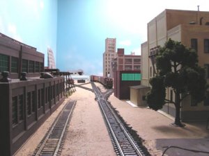

I've been thinking about my layout for some time now, wondering what it was I didn't like about it. Finally decided that there were too many turnouts, too close together making things look not very realistic.
I took out all the track, and rather than drawing out a new plan, I just positioned track and turnouts in what looked "right."

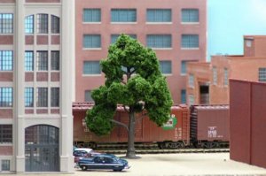

Here is a shot from about track level looking east at what will eventually be tall buildings in the corner. In the foreground to the left you can see the Massey Fergusson foundry building with a bit of the overhead crane showing an abandoned siding which which get a lot of weeds around and over it. To the right is Weston's Bakery.
Val

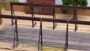

Here we are looking north at the overhead crane in front of the foundry. I've just finished creating the pavement underneath it. The forground tracks are live, the back ones are not - they go into the building and are used for slag and sand cars.

Eddie I was trying to get that canyon look but the tricky thing is you want to be able to reach the tracks from the front. I just put 2 buildings across from each other to set the tone and then there's a very large open space where the turnouts are.

Okay Philip. Because I was fitting it around track I used styrene sheet (which was raised to track level with stripwood).
Painting technique was using 2 mixes of grey, one a little lighter and kind of blending them on the plastic. I didn't really intend to do it this way, just that the first application seemed too light so I added a little darker grey and liked the effect, so I repeated it for each strip.
Then I rubbed on a little artists black chalk and smeared it around with my fingers. (Note: do NOT rub your nose at this stage or you will get funny looks from your family members!!)
Finally, I used a fine-tip Pentel style pen to create the cracks. It helps to have some understanding of where the pavement is likely to stress and crack. Along the edges is one place - those cracks are mostly parallel to the road. Transverse cracks happen in response to changes in elevation that can happen over time, when the nice graded roadbed sinks here and there the pavement cracks as it sinks a little too.
I am constantly observing these things as I drive around. Local conditions probably produce slightly different effects. For example, where there are freezing winter conditions, there is more stress on pavement.
For the pothole, I took a match to the plastic sheet before painting. It doesn't take much heat at all. You could also cut it out. Then I filled it will a little very fine ballast as gravel.
Hope this helps.
