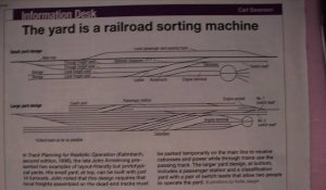

....should I say "hope" instead of plan???? :confused:
After almost 2 years of experimenting, I think I am getting close to an actual layout plan. I have started and quit at least 2 plans...I keep reading and seeing excellent projects on THE Gauge and keep changing my mind, so it's all y'alls fault, but here goes....:thumb:
I am planning a u-shaped shelf layout that will be 18'' wide, 8' on each side and 11' across the back of the U, built along the walls of a 11' x 11' room.
Right now, I want to concentrate on the middle section which will be a diesel maintenance facility and yard located between two or more towns with various industries on either side. The yard facility will be about 8' long. Operations will primarily be freight with interchange between other roads TBA later. The service facility will be light with fuel, sand, water and small engine house for repairs and RIP track. One or two engines with a switcher will be using the facility. There will be a small passenger depot along the passing siding at the top. I just don't have the expertise to design my own, so I found this small yard plan which seemed to be the ticket. For as you all know, I steal fair and square! sign1
Could the experts here take a look and advise if I am on the right track???
Questions I have would be:
1) would this fit (with scenery and buildings) on 18"?,
2) Where would you locate the RIP track?,
3) How long should the yard lead be?,
4) If the storage tracks are about 3' long, how many cars should make up a train leaving the yard?
5) John Armstrong says this plan will foul the main line while assembling local freight, I can't see how, if so how can I avoid that?
Sorry for the quality of the pic, I don't have a scanner and I just took a picture of the article. I am referring to the small yard at the top. The roundhouse will be replaced with a diesel facility building. If someone can convert this with a track planning program, I would love you forever! (Well, you know what I mean).sign1
I will have a gillion more questions, this should get me going. Thanks for your help, I will do what you all tell me!!! (Be careful here!tooth1)
ps- It will be N scale......
If you space the tracks at 2" (for HO) it will fit, even better if you replace the turntable.
Probably near the engine house, but do you need one? Do you have that many cars that don't work? :mrgreen:
Not sure :confused:
40' boxcar standard: each track would have about 6 cars. You could use one track's worth or two, or even the whole yard.
:confused:
Yep, with room to spare;
I'd put it north of the storage tracks (I didn't yet);
I like to make it as long as possible, but sometimes (like here) space is limiting. Ideally, it should be (IMHO) at least as long as the longest track in the yard.
As long as I've made them here, you'll get 12-13 40' cars, or 10 50' cars in each. The length of the train leaving the yard really depends on where it's going to go. Technically you could pull all the cars out of the storage tracks and the through tracks, and pull it out - however if your layout only goes another 8-10', you'll still be in the yard by the time your loco hits end-of-track.
I'm not sure I see it either, unless the local freight is longer than the longest track, in which case you'd have to double out of the yard.

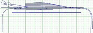

Some specifics:
#7 turnouts throughout
1 1/8" track centres minimum
12" minimum radius curves
no easements.

Thanks very much for your input. Squidbait, I really appreciate you taking the time to convert this to a legit trackplan. I guess I have to love you forever!! You know, in a manly sort of way!!!!sign1 I assume with the limited response to this thread, it must be a good design. I am still learning about operations, I hope this will allow me to do yard switching, staging locos and other cars for maintenance, and store other cars for delivery to interchange roads and industries elswhere on the layout.
Another question, would it be prototypical to have a passenger station located at the passing siding? I plan to kitbash a small depot as a building front only due to space restrictions.
I wouldn't take any bets on that.
sign1
Seriously: I think it's a good, uncluttered layout with a hint of the shunting puzzle.
Nice.:thumb:
You really can't go wrong when you follow the prototypical layout of a yard.
I agree with all the answers here, and only have a few things to add...
Your shortest double-ended track looks like about 2 feet or 4 cars on Squid's plan.
You could extend the left side of that plan, if the left end of the yard is either bent around the corner, or the yard ladder (all the turnouts) are moved to line up with the curve. This may require making the left end of the ladder "point" the other way - i.e. build the ladder using right-hand turnouts, starting back on the curve. Squid's currently showin gthem as LH turnouts.
Andrew
It looks like a pretty good plan to me. I like Andrew's suggestion to increase the length of the yard tracks. I wouldn't be concerned one way or the other by the response, yet. This thread has only been up 2 days. You may get a lot more responses and suggestions as more people have the time to look it over.
I think the runaround track is a bit superfluous in a yard this size, but by changing from #7 to #5 turnouts, we get longer through tracks. The shortest goes to 8 40' cars from 6 on the other version.
Yes, it would be prototypical to have the station on the outside of the siding... if you pull the yard closer to the edge of the layout, you could even have an express/lcl/team track behind the station. I stuck an extra stub track in that you could use as a RIP track.
