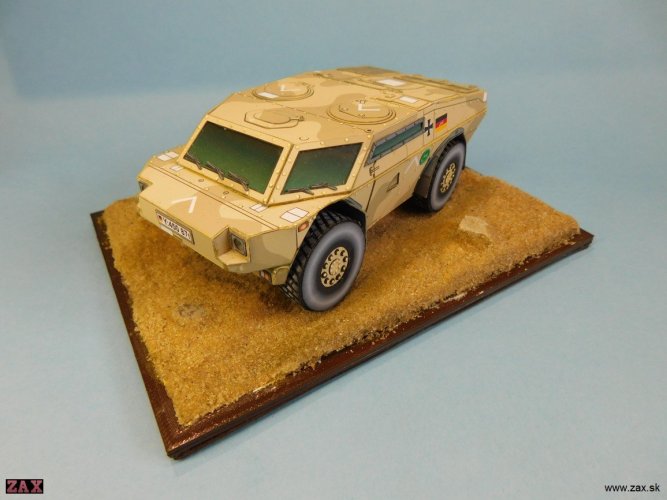

I started with this simpler model, which I am constantly modifying. I highlighted the details that were only drawn, added lights, added glass and rivets...

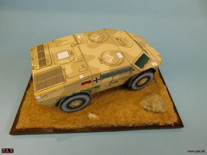

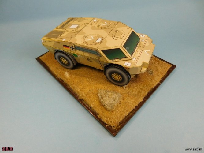

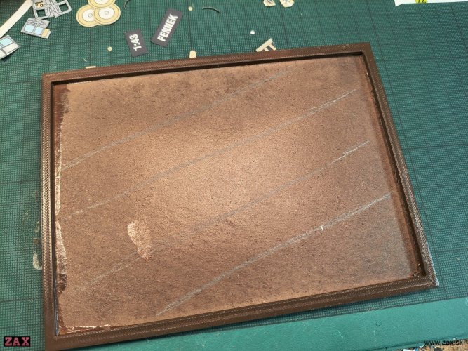

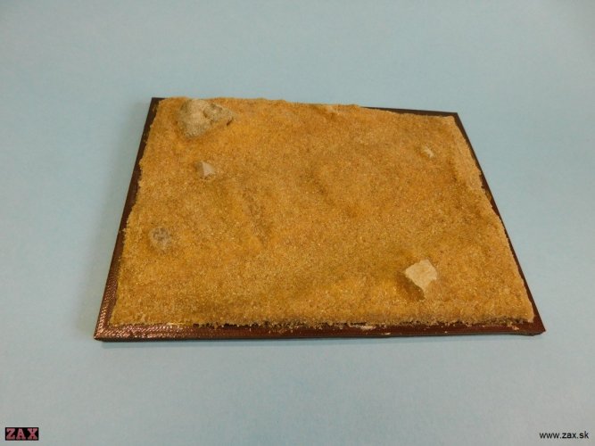

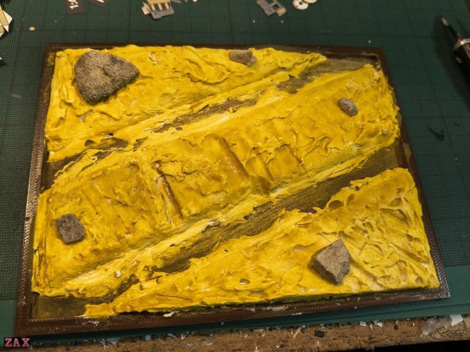

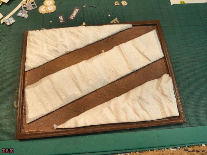

I made a base, printed the frame to size, then sprayed it with brown paint, made a terrain out of polystyrene, painted it all over and added rocks and sand at the end...I'll finish it off with dry grass at the end.
1 IMG_20260529_183128801_HDR.jpg2 IMG_20260529_183155915_HDR.jpg3 IMG_20260530_123433722_HDR.jpg4 Dscn4037.jpg

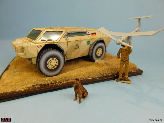

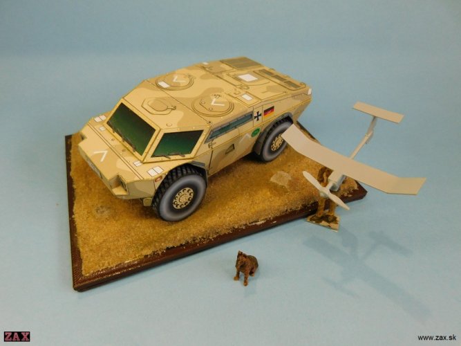

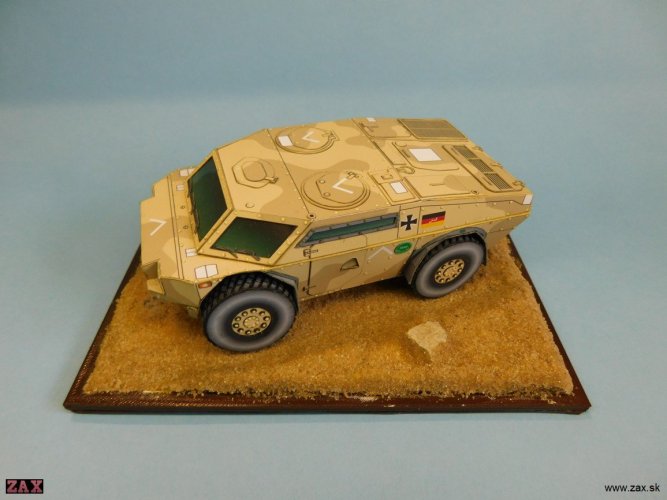

The next photos show how it looks in a pile...and the last photos show a few accessories - a soldier with a drone and a dog...
