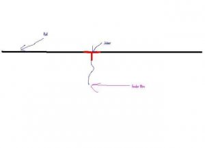

Do Terminal joiners exsist that have a place to solder a feeder wire too? I have seen some that shaped like a "T" but they come out sideways from the track. I would think something like a "T" but the bottom part of the "T" would project down so that you could attach a feeder. Anything out there like this?
Hope this makes sense?

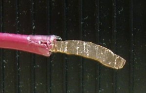

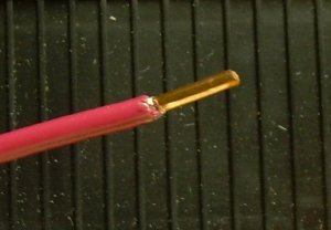

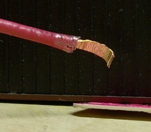

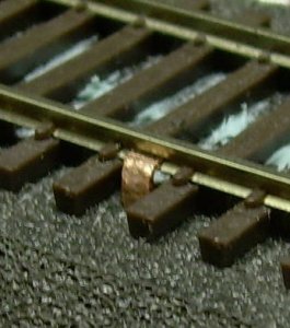

Model Railroader Magazine had a section recently on feeder wires. The technique is to drill a hole straight down next to track (outside of rail, obviously). Then take the smallest guage solid copper wire you can purchase (16g at my local home supply store), cut it to length to reach your bus beneath the layout, and remove 1/2" of inssulation from both ends. Then take one end and using a hammer, pound the wire flat to create a spade of sorts. Next, take your rail cutter and shape it so it is square on the end, bend it in a right angle with only about 1/32" beyond the bend and then drop the other end down the hole you drilled. Tin the business end of the feeder and the track (flux is good) and you end up with a very low profile and nearly invisible feed once the track is weathered.
I used to bend the feeder to fit in the groove on the outside of the rail but this is truly a superior method.
Thanks for the pictures, Rusty Spike. I was planning to peen them and slide under the rail bottoms, but the pictured way might be better. I foresee melted ties and big silver globs along the mainline, but maybe the balllast will cover things.
