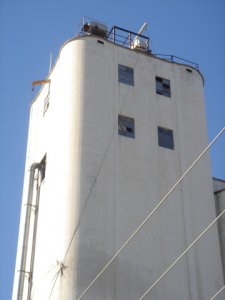

Here's one more shot of the real thing, I've been trying to find what's up at the top of the tower, and I think I came close to duplicating it...

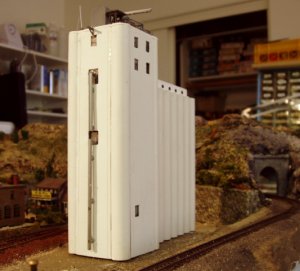

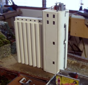

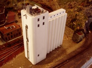

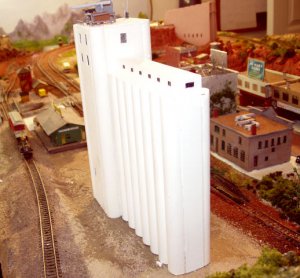

OK, here's where I am now, the silos and tower are pretty much finished, I'm debating how much weathering I can put in this I might try a very light ink wash. I've still got to build the smaller building and that's as far as it will go.
This is not where I plan on putting it, but who knows, it may wind up there, we'll see. I'm glad I didn't go to scale, or it would have overwhelmed anywhere I'd put it. It came out closer to 270:1, that tells you what an impressive structure the original is.

No that's not where I planned to put it, I just put it there to take these pictures. I moved it to the other area near the back where I wanted to put it and it look like that's where it belongs.
Yeh, yeh, yeh, my bad. If I'd have taken the time to read your post thoroughly the first time, I would have read the part about you saying that's not where you planned to put it.wall1 Shoot me now and put me out of my misery.wall1

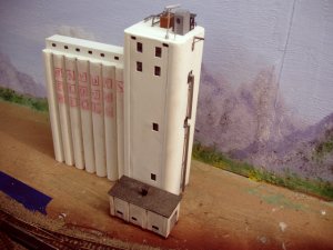

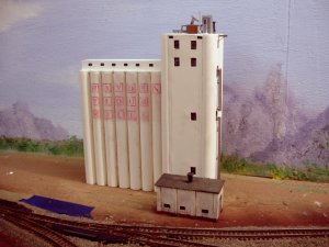

A couple of more shots, I've added the small building and have put on the signage. The signage is a bit more faded on the actual one to the point where it's barely visible, but I didn't want to fade it back that much and keep it on my layout that way. It is sitting right about where I plan on putting it when I get to that point.

That is one AWESOME building Don!!!! I love the lettering, :mrgreen: :mrgreen: :mrgreen: it looks GREAT and thats a good place for it on your layout to :thumb: :thumb:
Thanks, obviously I have yet to scenic the area, but yes, it belongs in the background.
I did the lettering with decal paper and a color printer, then sprayed it with Krylon matte finish. Once it was in place, I found that I could rub off as much of the color as I wanted using a wet Q-tip. The lettering on the prototype right now is barely visible, but I didn't want to go that far.:eek:

I'm not sure what's in there, or was in there.:confused: :confused: I've always assumed that since there was windows there that it might be part of the processing or a way to get the grain back out of the silos. There should also be stairs there to get up to the top snce there are no outside ladders. I've not found anything that says otherwise, but I'm as curious as you are so I'll let you know if I find out for sure. I also think the rounded corners are purely cosmetic.
